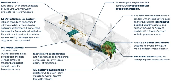

I thought that we have Li-ion battery under the backseat and AGM 12 V under the hood??
12V AGM 800CCA in engine compartment, 12V 7.5AH AGM passenger side under rear seat and lithium-Ion battery 1.5kWh between frame rails under floor

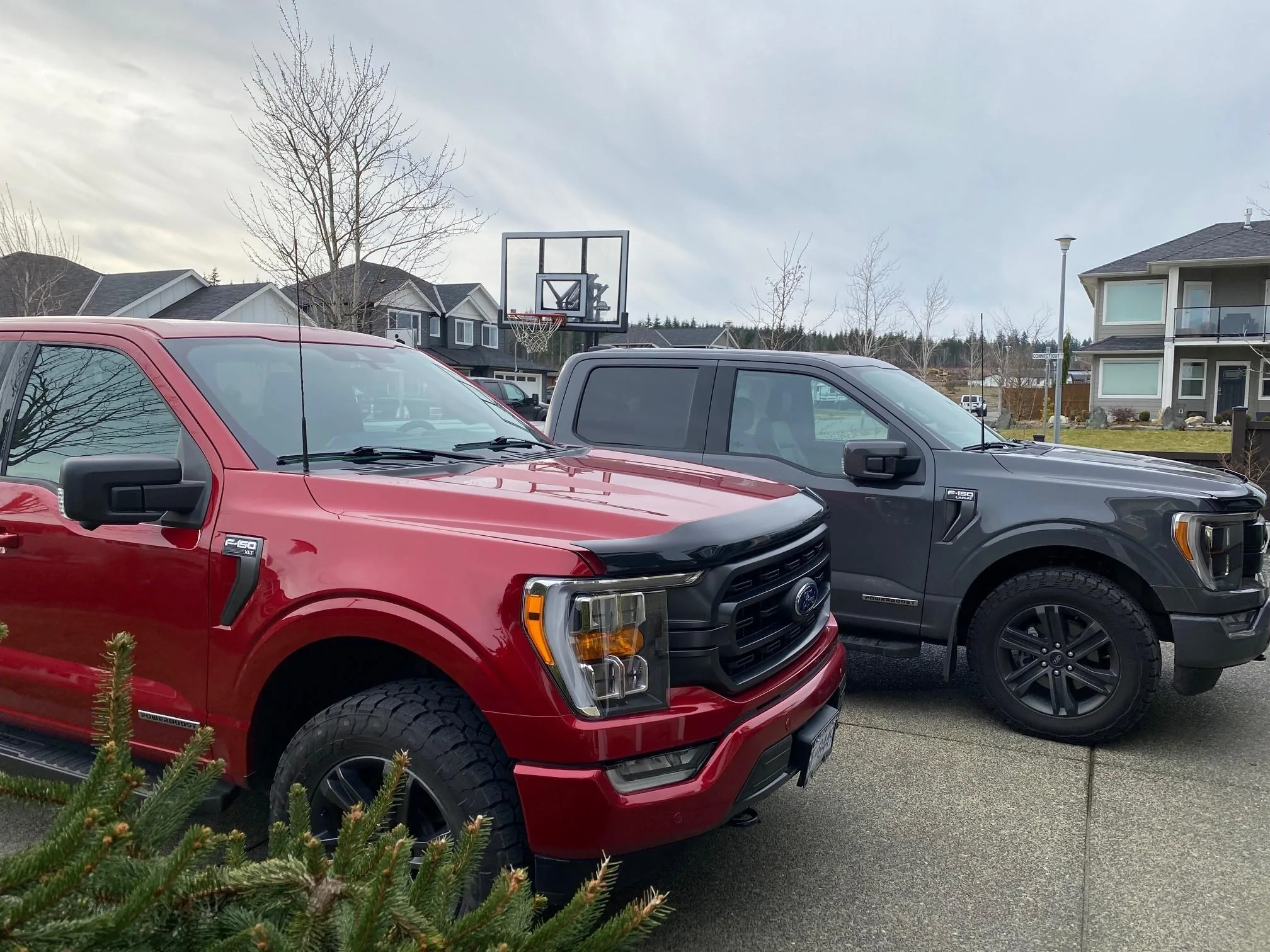

I was happy with both my FX4 - 2021 PB (502A Lariat leadfoot and 302A XLT rapid red) both with the 7.2Kw Pro Power.
Some quirks that were minor on both my PB's:
- fault ground codes on both 7.2Kw ProPower
- Brakes were not the best (leaving this to dynamic braking system to charge the battery)
- 10 speed transmission had some serious hard shifting issues.
-Both had higher tire tread wear then my previous 3.5 EB's. Just due to more weight (battery & electric motors) and more torque is what I am figuring is the issue.
Lariat (30K km) had more issues than my XLT -
- couple times not starting up - they figured it was a fuse causing the issue
- cooling seats didn't function and had to get new fan motors
- A/C shutdown on me a few times
Again most were minor issues that were fixed like any vehicle with lots of bling and electronics.

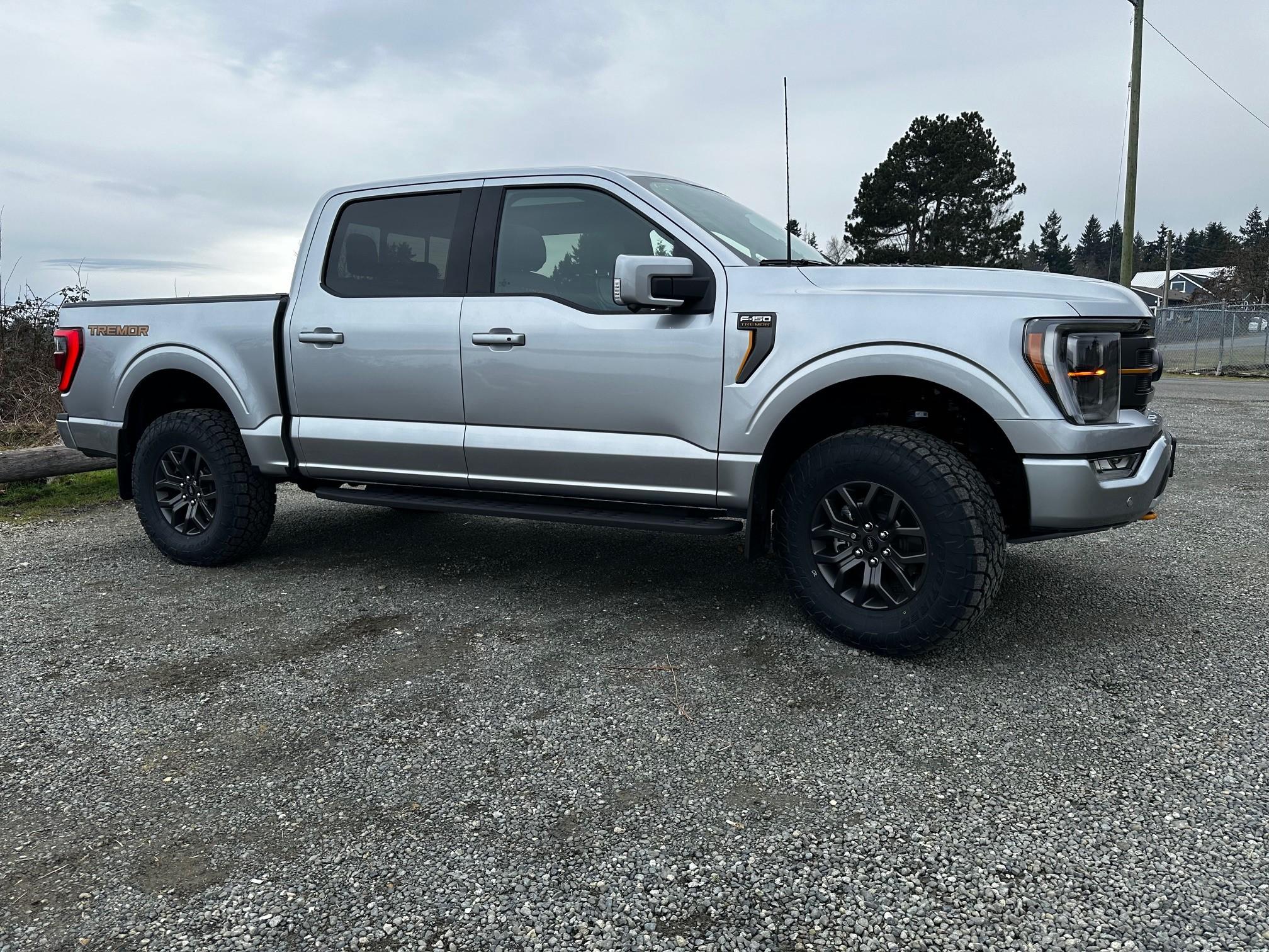

I sold the Lariat Leadfoot a couple weeks back and jumped into a 402A Tremor 3.5EB for more highway runs and off-roading.
Am I regretting selling the Lariat PB for a Tremor? Absolutely not - the Tremor is a beast on it's own more comfortable ride than my FX4's. Only thing I will miss is the Leadfoot Grey color and maybe the better mileage around town, but I do still have my rapid red XLT PB to drive around.
Ford F-150 Any good experiences from PowerBoost owners PB_both
