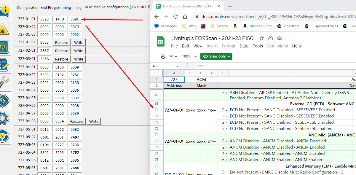

Because its in the ACM calibration. There are two additional software fields that are for ANC.. Its not a turn it off situaiton
So you are saying that it works even if the other two options are disabled?
Thinking thru this...
1. If it requires mics, which I'm not sure why it would not, and the mics are disabled, I don't see how it can be active.
2. If it is disabled in DSP, I'm not seeing how it can be active.
3. If I disconnect power to the DSP and there is no noise difference, I'm not sure how it can be active.
4. SGS has installed numerous systems in these trucks and not changed anything in the FORScan settings with zero issues. If it were active, there would be issues. Perhaps since they removed the DSP, that eliminated the possibility of issues, assuming the ANC is in the DSP.
I will disable the ACM calibration if it is not already set to "0" (which is the default), but I am going to bet a coca-cola in a 6oz bottle that it doesn't change a thing from where I'm at right now.

I'm not arguing with you ... I just listed some thoughts and stated some observations and opinions. Did not mean for anyone to get offended over it. I do understand the DSP does not power the rear speakers and tweeter speakers, but from the wiring diagram I viewed, every microphone is connected to the DSP. Now... if the ANC can work without a microphone, it's doing some magic that I've never heard of. But hey... what do I know either?

Explains why you guys told what you did, that you haven't had any issues. This is good info to know.
I did change the following to "0", but again, can't tell that it is introducing any noise. DSP is still in use at this time.
Ford F-150 ANC turned off by default? 1677611391819
It does, however, cause the rear speakers to pop when the phone rings... so I'll change this back to "1".
This also explains why the mic 1, 2 and 3 entry are off in FORScan, if there are in fact none installed. What is interesting is why ANC was already disabled in the ACM.
