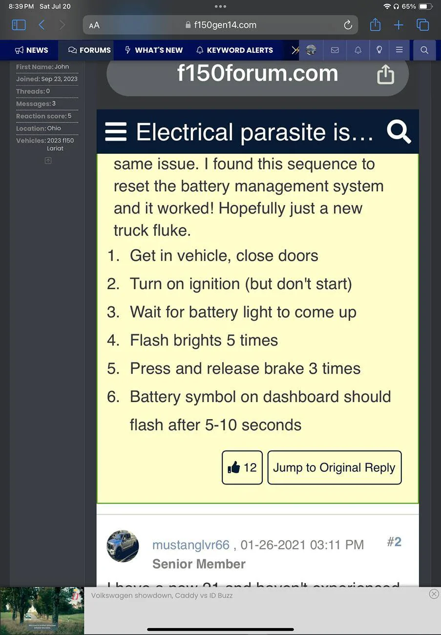

Plague, might be too strong a word but I had this issue quite a lot. Set on the charger, just to have it return in days.
Did the manual BMS reset and poof, its never happened again.
Shortly after, Ford addressed it in an OTA update but since the reset fixed mine, I can't say how effective the update is, or isn't.

My truck sat in the garage for four days, everything was good. Do the manual reset!

My 2021 PB does this after certain updates. The Battery has tested to be more than ample. Once I reset the Battery Monitor System, the error and warning goes away.
BLE battery monitor Reset
Turn key on, flash brights 5 times, tap brakes 3 times and turn off. Turn on and battery symbol should flash

I just drove over 8 hours. I received the "Remote Features..." notification about an hour after I parked. SOC was 91%. Anyone have any ideas about what's going on here? Replaced the battery in December with an X2 H7.

H8 will not fit a powerboost truck h7 is the largest size for a powerboost. There could be more reasons your getting this message for example how you drive the truck, outside temp, and if your truck gotten the bms ota update.
