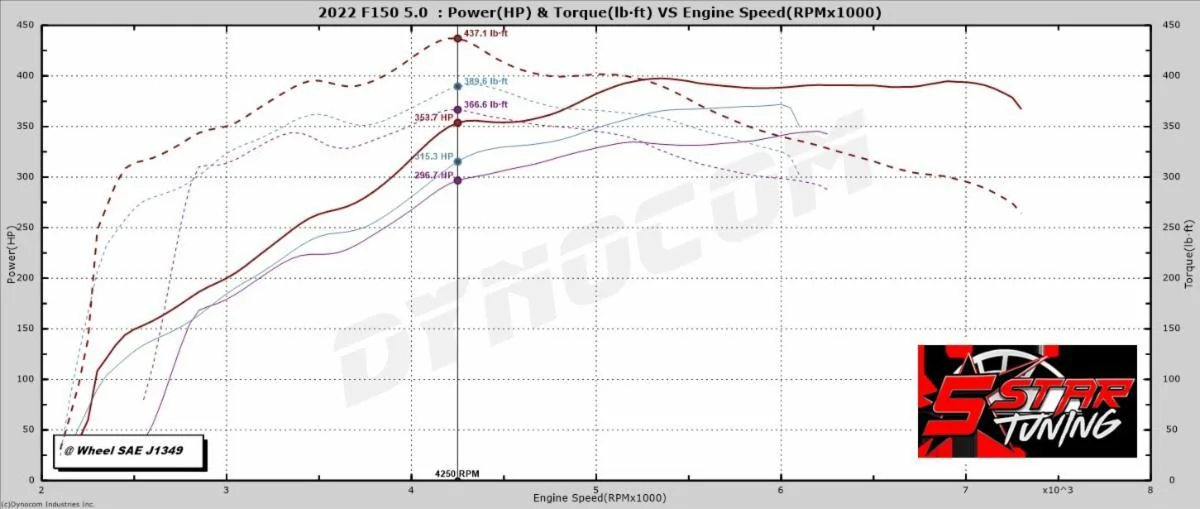

Your PB puts 780 lb ft to the wheel? All premium 93 and E-85 wheel torque readings for the 5.0 range from 390-415 lb ft at the wheel. 200% is quite the claim. That’s more torque than a Raptor R and approaching 6.7L Powerstroke Diesel territory. If you don’t have upgraded H-Beam connecting rods and a beefier crankshaft that engine is not long for this world…
These are stock runs, differing octane besides the red line (tuned), all 5.0. Blue is 93 premium and red is E-85. 880 lb ft at the rear wheel would be 200% of the E-85 run :)

Your PB puts 780 lb ft to the wheel? All premium 93 and E-85 wheel torque readings for the 5.0 range from 390-415 lb ft at the wheel. 200% is quite the claim. That’s more torque than a Raptor R and approaching 6.7L Powerstroke Diesel territory. If you don’t have upgraded H-Beam connecting rods and a beefier crankshaft that engine is not long for this world…windowed block incoming.
My base 93 tune bests the R by 70ftlbs at the wheels. Have to deal with some family health issues, hope to hit the rollers soon. Still working on the 1/2 shift, debating about dropping the trans and changing clutches before they burn up.
