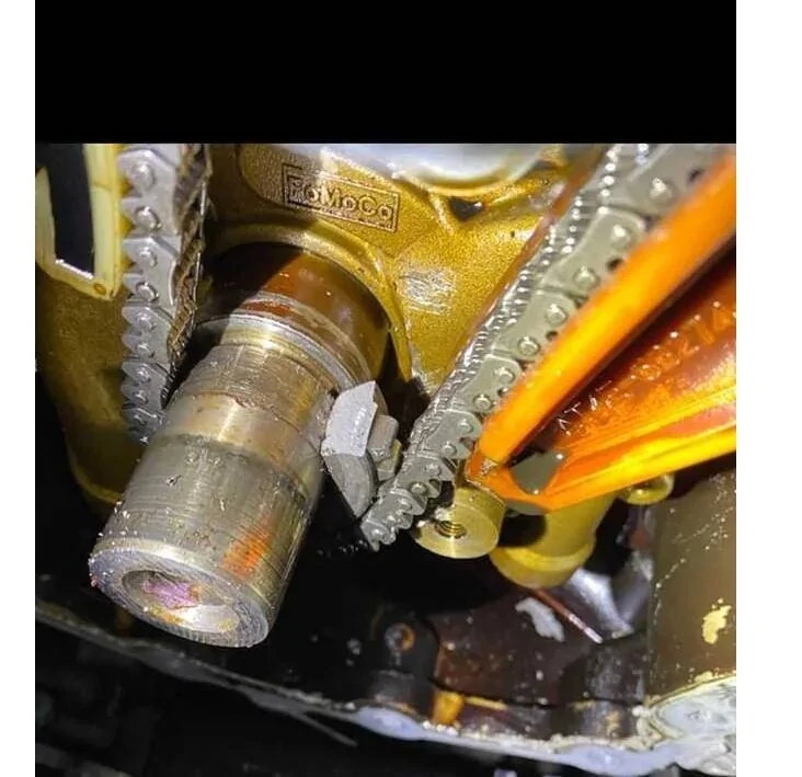

Gotchya, so not a Gen 14 3.5 EB/PB with the two chains that run from crank over both cams per bank.On this engine the exhaust and intake are connected with a small chain.
Perhaps the crankshaft timing chain sprocket split or broke and spun on the snout of the crankshaft. This can happen if the harmonic balancer wasn't installed correctly, or the bolt not torqued properly (or a new TTY bolt was not used)No a 2011. I didn't realize I was on the gen 14 site when I posted. But virtually the same engine. I also didn't know ford had changed
That's exactly what I was asking about. It's happened on Gen 3.5 Ecoboost before. (2011-2016 F150)Perhaps the crankshaft timing chain sprocket split or broke and spun on the snout of the crankshaft. This can happen if the harmonic balancer wasn't installed correctly, or the bolt not torqued properly (or a new TTY bolt was not used)
Broken Crankshaft Gear - Key Replacement? | F150 Ecoboost Forum
It happens on the 5.0 too, although generally when Forced induction is added, and especially PD blowers but bouncing off the rev limiter, 2 steps can do it too. If OP/shop didn't install the harmonic balancer correctly when the timing component overhaul happened, it can cause the sprocket to chatter on the crank, and split where the woodruff keyway is.That's exactly what I was asking about. It's happened on Gen 3.5 Ecoboost before. (2011-2016 F150)
