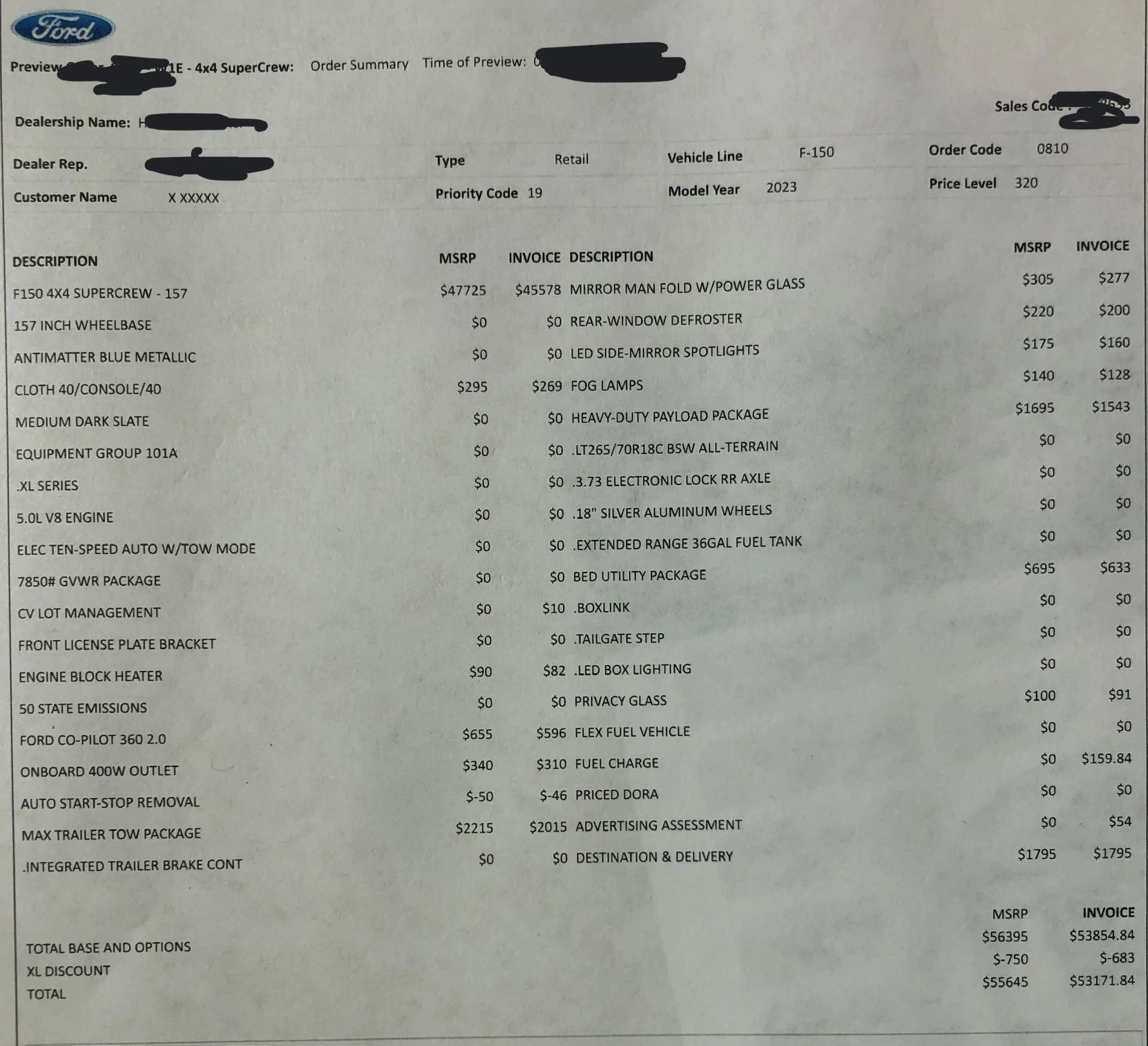

I had to get it with an XL package. But I also really wanted vinyl floor instead of carpeting.
HDPP is only available with the 157” and 163” wheelbases. It gets you the 7850# GVWR
Ford F-150 2023 HDPP vs Max Tow 25E55BB0-5205-4BF0-A9A3-3F56B4092EEB
just waiting for it to ship now.
Ford F-150 2023 HDPP vs Max Tow 905EFEDD-B9CB-419C-9B97-2604BF3924B1
