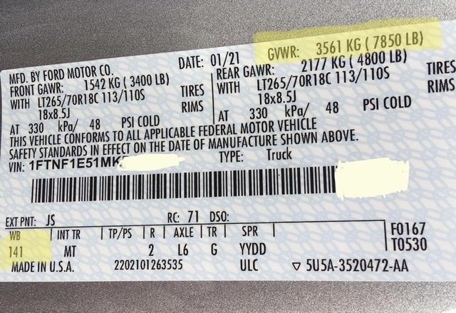

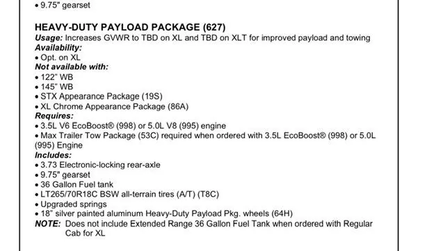

the HDPP 7850 GVWR is only available on the 157” and 163” WB vehicles.

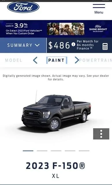

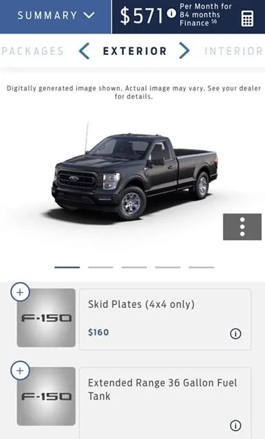

This is the first time hearing that. It’s not reflected in the 2023 order guide from earlier this year and the configurator tool shows the one change to the 141WB HDPP option of dropping the 36 gallon tank from the package.

Have you tried ordering one or seen anything specific? It wouldn’t shock me if they weren’t taking custom orders for the regular cab HDPP and prioritized their fleet customers but it would be very surprising if they dropped it completely, since the regular cab HDPPs are what I saw the most of when I was searching for used trucks. They were all white with lots of miles and many were missing their tailgates from having slide in utility boxes.

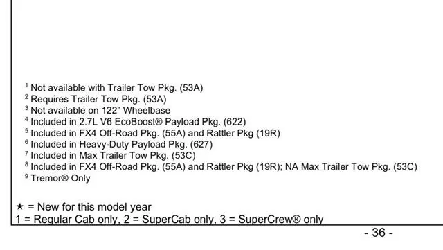

I have ordered a 2023 F150 CREW 6.5 bed, 3.5 EB, FX4 with Max Tow. I did not see HDPP (Heavy Duty Payload) on order site and was told by dealer that HDPP was only available on XL trim. I have seen posts on this site stating that Max Tow includes bigger axle, springs, etc. I believe this is incorrect and a common myth (Assumption). I am hoping I am wrong and something has changed for 2023? Are any of the HDPP components now included in the Max Tow Package? I was hoping to get a 2100lb+ payload.

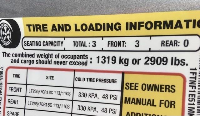

2023 f150 xl crew 157 hdpp 5.0l 4x4
door tag and hitch sticker
Ford F-150 2023 HDPP vs Max Tow 3ACD1065-238B-4148-8DDD-B42DE34FAEA7
Ford F-150 2023 HDPP vs Max Tow 242FA991-E6FA-4571-A862-5F13B95C51BB
Coming from owning a 2020 f250 super duty 7.3l crew cab for 2 years it was too much truck for my daily needs and a standard f150 wouldn’t be enough. I did a lot of research on hdpp vs max tow and wanted the extra payload.
Max tow is definitely more than just a trailer tow package because it does include the 9.75 rear end and 3 leaf springs
I know there is in depth info on ford website about increased brake sizes and frame thickness
On paper the payload of this f150 hdpp is the same as the f250
but I can tell you by looking at and owning the two trucks in person the superduty is twice the truck if you need it

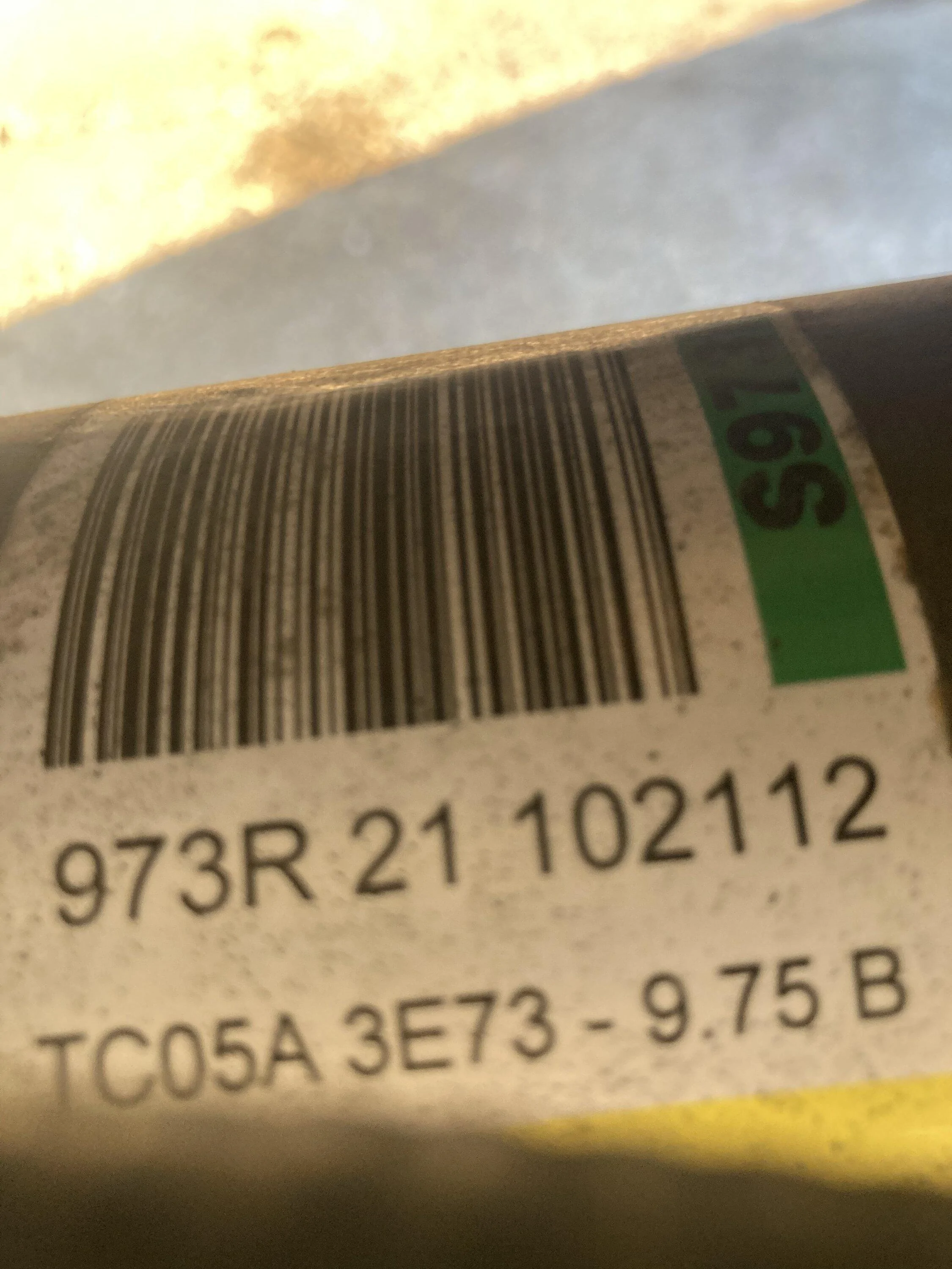

Thought I’d post my mostly stock 2022 XLT scab v8 301A, 36 gal with 3:73 as ordered. apparently if you order the v8 with elec locking diff you get the 9.75 rear end. I added decals for comparison. It is a 9.75B rear end and I think the brakes are bigger.
My 2014 XL scab v8 36 gal with 3:73 mid had all the same but came with the 8.8 rear end.
I would have preferred the 8.8 on my 2022 XLT for lighter unstrung weight. Since I don’t tow 10 k lb. I can’t figure out what determines 8.8 or 9.75 when ordering. Any body know?

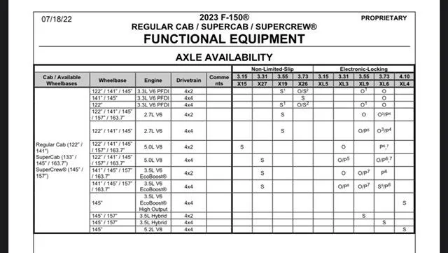

Thought I’d post my mostly stock 2022 XLT scab v8 301A, 36 gal with 3:73...I can’t figure out what determines 8.8 or 9.75 when ordering. Any body know?
At least in 2020 and 2021, ordering the 3.73 gearing automatically gets you the standard 9.75” rear diff/axle. Even regular cab shortbeds with 3.73 will get the 9.75”
For Max Tow and possibly some of the Powerboost trucks, the 9.75” will be the HD version.
It looks like you have the standard 9.75” axle with the L6 axle code, meaning that it is 3.73 with the electronic locker.
I have no idea if the standard rear brakes are larger than the previous gen. but the HD9.75” axle won’t clear 17” rims.
