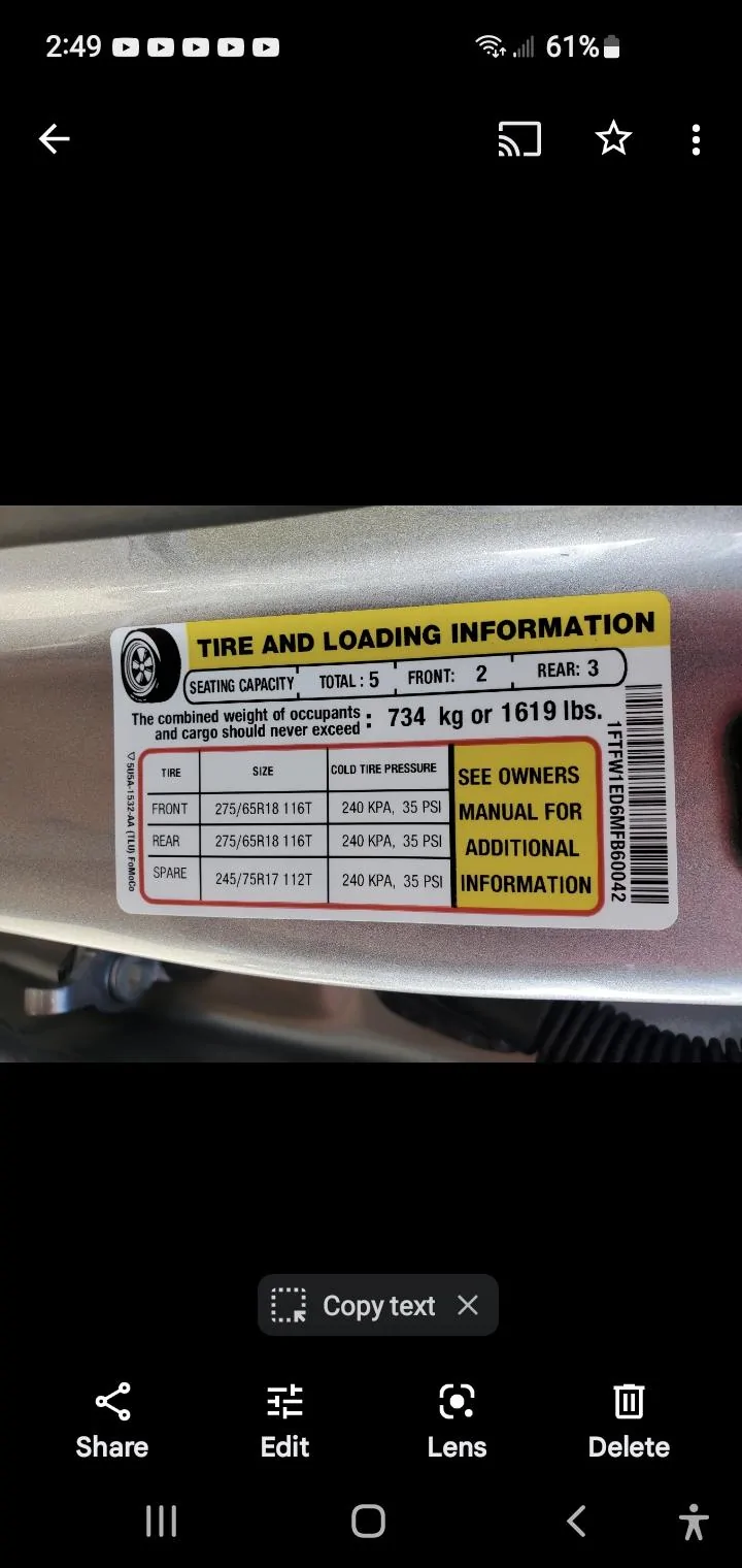

Ya , i know its not the HDPP. Here is a picture of the options from my detailed sticker. I will include the occupants and cargo stats.
Ford F-150 2023 HDPP vs Max Tow 20230224_225052
FYI, All the GVWRs are listed like that, where it says #XXXX GVWR Package. It's just a function of what model you purchased, and only really an "option" when it's the 2.7 Payload Package or HDPP.

My Powerboost with The "trailer tow package"
Roger. When you mentioned "payload package" and talked about payload capacity, I thought that's what you meant.
Towing packages don't affect official payload, which is part of the issue where some people have gotten into trouble looking to tow 10k without thinking about actual payload capacity and tongue weights.
