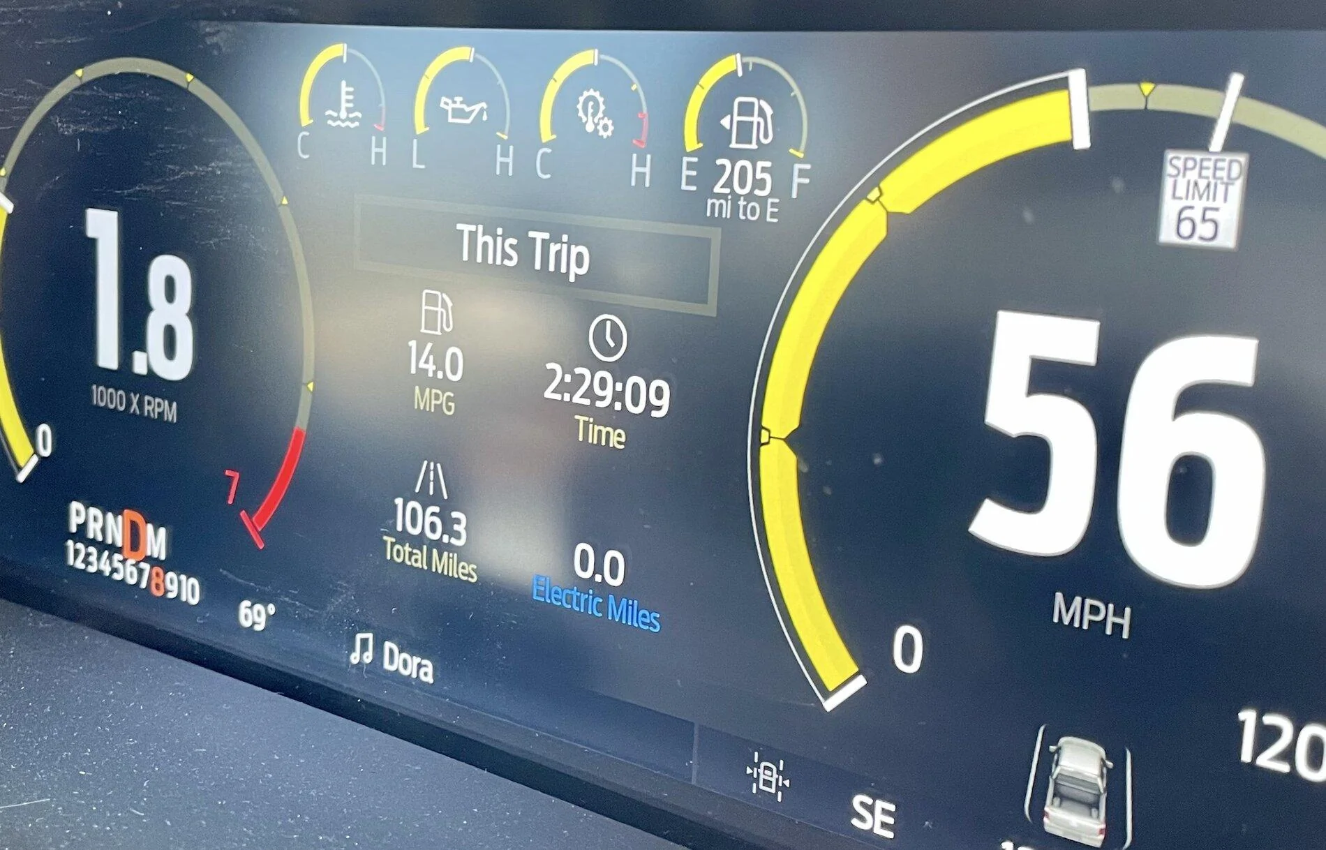

Wanted to add some information to this thread. this is PB towing a 23', 6klbs trailer in tow mode the entire time. This was mostly flat highway, though the first 20 miles it was slight uphill grade into wind and it was hovering around 9-10mph. Speed limit in CA is 55mph for trailers and we followed it. I had 89 octane. Reading some of the other posts, I see a pattern of speed being a major factor in mpg.
That’s pretty darn good. you are right, speed is the main thing we can control that influences it. I get similar results with our 25’ Airstream, but I don’t have enough towing miles for statistically reliable data.
How does Dora sound on the unleashed sound system? :ROFLMAO:
