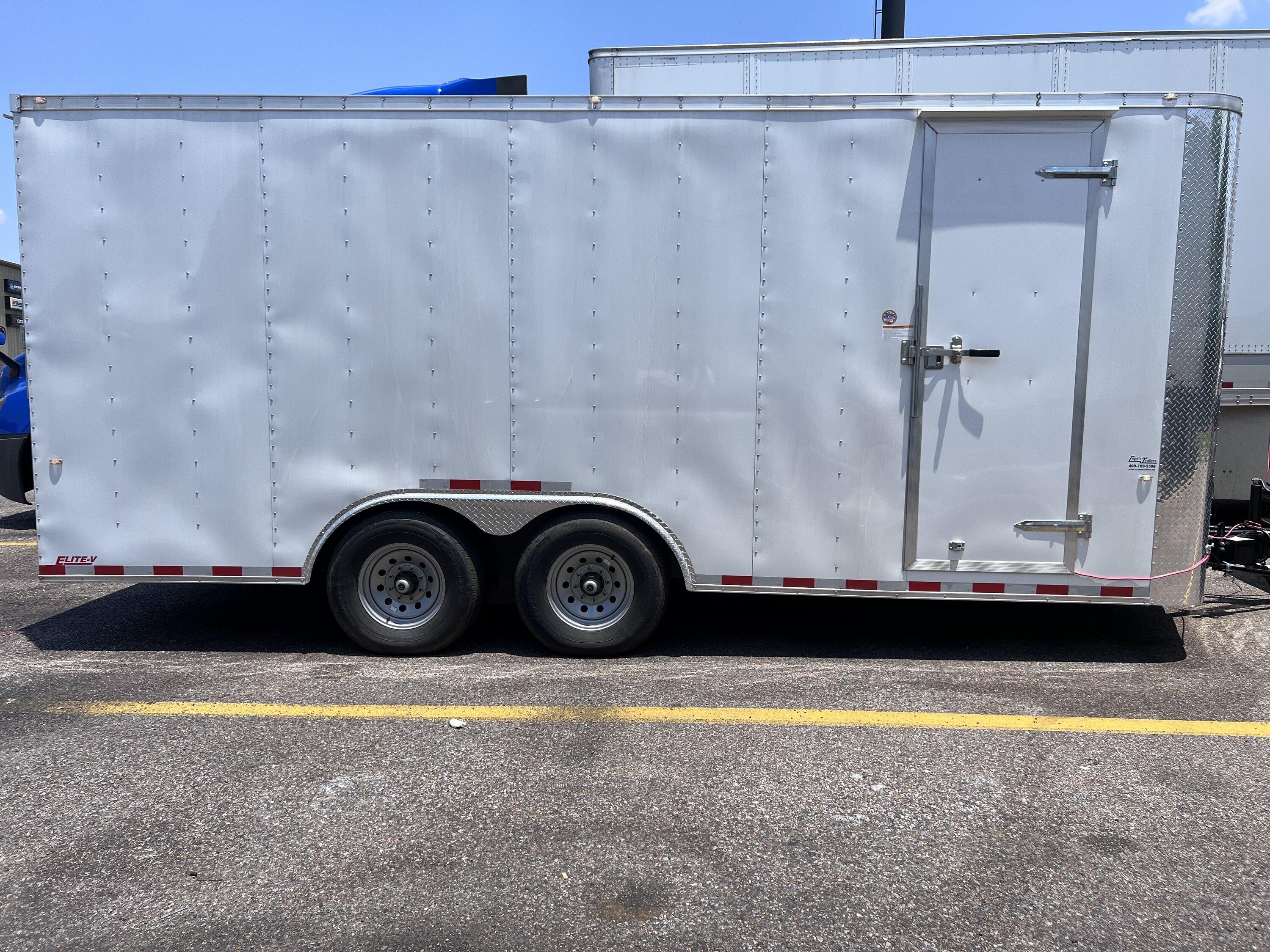

Well this is my MPG while driving with a gross vehicle weight of 22,940 LBS. The hauler is 7.5 feet interior height, so it has greater wind drag vs a typical car hauler. This hauler also has the 8 lug axles to handle the extra capacity.
I would say 10.6 MPG is far from terrible. My speed was 55MPH max on this trip because i was so overloaded.
I must say that the PB towed this load with no issues. I attempted a panic stop 1 time with this load, and the truck and trailer slowed quicker than expected. I will post an update with the dry weight of truck and trailer.
Also, for the people that don’t know what this yellow paper is for, these are set up for 18 wheelers, so you have to look at the gross weight.

Has anyone towed heavier with a Powerboost? If so, please post your story.

I don't know that I would have gotten weighed if I knew I was overweight. Last thing I'd want with me if I were pulled over would be a weigh ticket. Glad you made it though.

I guess I shouldn't feel that stressed when I was 50lb over GVWR not on any GAWR when you're 15,590lb over GVWR and 9,990lb over GAWR. (Assuming standard PB ratings of 3900f/4150r/7350c) That was one hell of a stress test. Were your leaf springs upside down with that much weight ?
I'm not defending towing that heavy with an F-150 even though if he has the max trailer tow it would probably do it just fine (i mean it did it) taking it easy.
But that F-150 either has a GCWR of 17,000 or 18,400 (Max trailer tow) and therefor he's not as much out of spec. Either 4,500 or 5900 pounds over combined ratings.
At least when I've weighed on cat scales with smaller trucks the rear axle ratings aren't correct. To get to that combined weight I'm estimating the trailer at 16k (truck/passenger weight of 6,500?) and you couldn't possibly have that much tongue weight without breaking shit. At 12% tongue weight it'd be 1,920 on the hitch (which is wayy too much as well).
