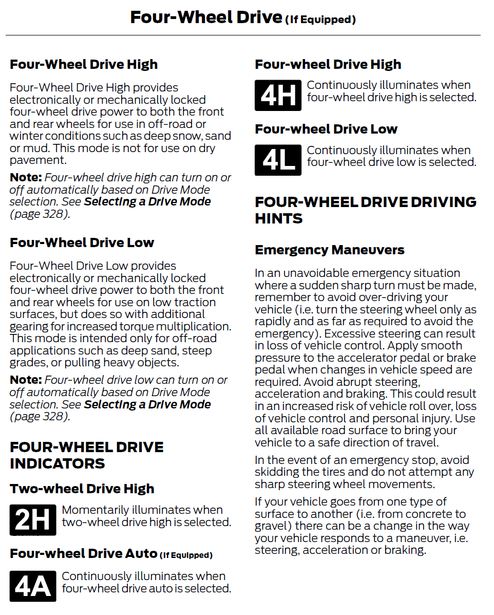

4A will also cost you at least 1 MPG. Use 2A unless you are in slippery conditions. I averaged 10MPG with a 6K lb boat/trailer in tow over 1700 miles, but not babying it at all. I thought that was reasonable. And I dropped it into 9th gear to improve response and reduce the occasional rumble strip feel. To me it just felt like it was in too high of a gear at some times and the rumble went away when I dropped into 9th. Other than towing, I have never felt that otherwise.
ok WHAT'S 2A and 4A?

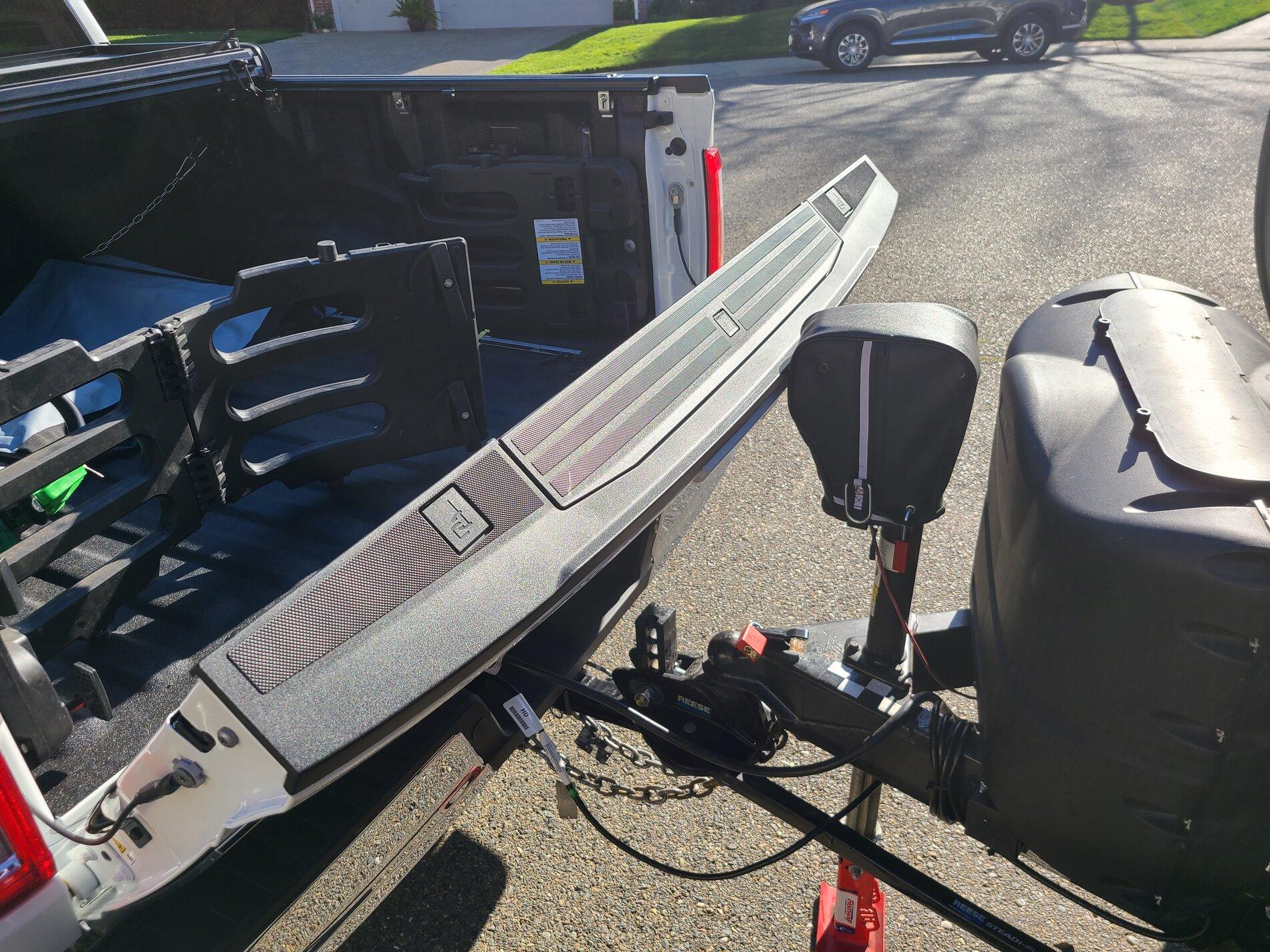

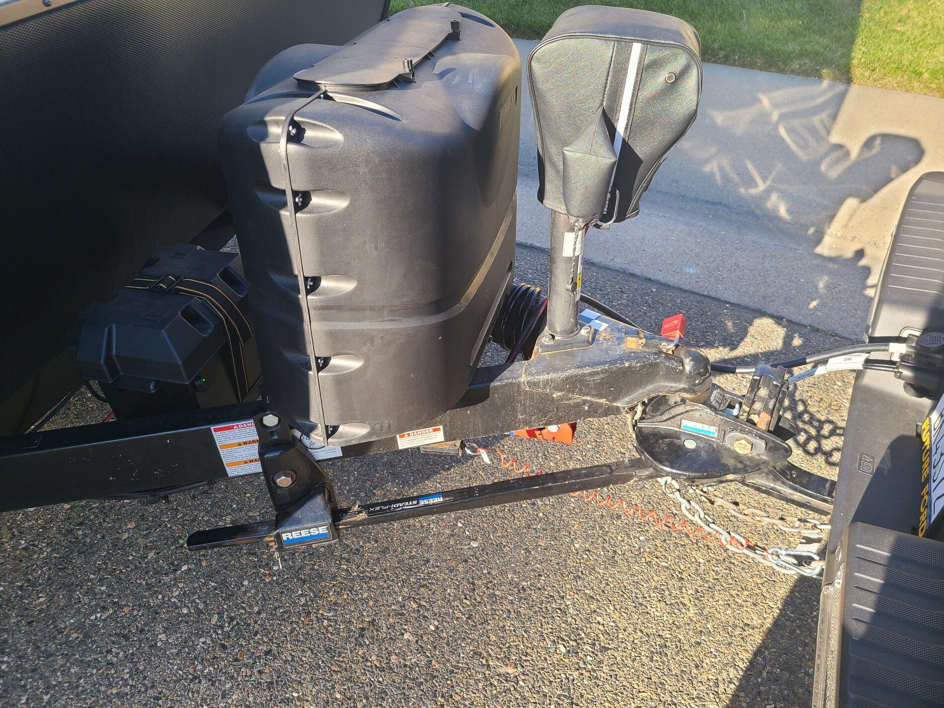

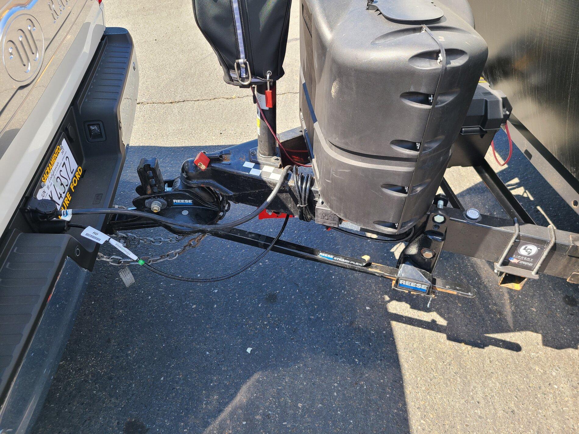

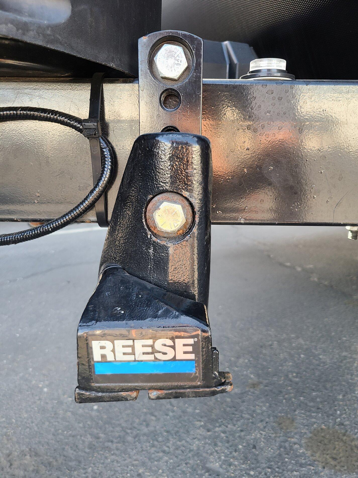

Sure thing. The only thing to keep in mind is that my tires are 1/2" diameter larger than your stock tires (assuming you didn't replace them).
Looks like my shank has daylight through the top 3 holes, and the sway bars have 1.5 holes visible. Note that if you adjust the shank height, you will need to readjust the sway bar thingies (is that the technical term?) to make the friction pads colinear again!
I finally had a camping trip this weekend, so I adjusted my hitch setup to match yours and it handles WAY BETTER! Much more stable, sits nice and level, and if there was no wind, I could use the lane centering....
Unfortunately however, my MPG did not improve as I would have hoped/expected. I towed between 70-75mph, no real wind out and still averaged about 7mpg on the 300mile round trip. But I powered my trailer all weekend off the powerboost, I loved how it drives...just not happy with the MPG. It's not about the cost of the fuel, it's the need to stop so frequently, especially if you're boondocking with the powerboost, you'll want a fairly full tank for the weekend.
Next step is to check my tongue weight and make sure there's nothing off with that, or it's a matter of driving slower. I'm curious for those that report getting 10mpg towing, what speed are you towing at?
