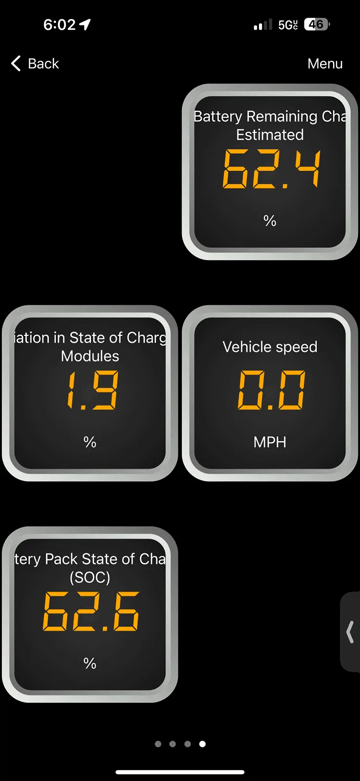

I'm just sceptical of your HV battery SOC as being anywhere near 62.4% with you being in Accessory mode for even a few minutes. Accessory mode will normally turn on the DC/DC converter and bleed the HV battery down as it provides voltage to the low voltage side of truck.
I added 22 ( and then 23) but nothing changed. I did find one labeled battery pack SOC that I added which seems to be the same/similar.
Ford F-150 Won't start- Stop Safely Now U0412, P0563, P0ADF IMG_1702
Well that's definitely a healthy SOC.
So the problem can't be a dead HV battery. I'm taking it off the table. Was hoping it was something simple.
I'm trying to be logical about the codes relating to both the DC/DC converter and the HV battery contacts.
What can be a source that would affect both of those parameters?

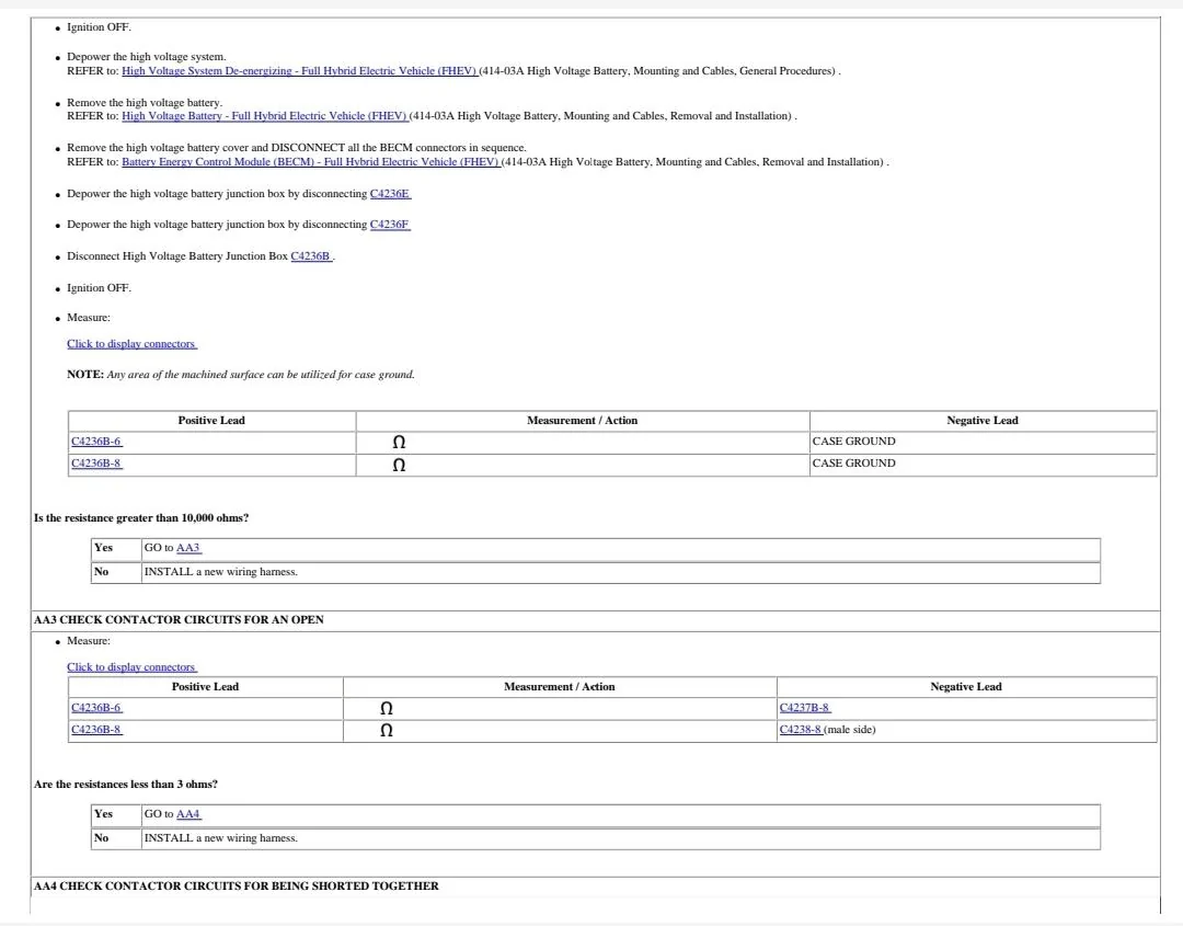

Here's an example of one step for the P0ADF code you have
Ford F-150 Won't start- Stop Safely Now U0412, P0563, P0ADF Screenshot_20240522_082427_OneDriv

Let's isolate P0ADF
Ford F-150 Won't start- Stop Safely Now U0412, P0563, P0ADF Screenshot_20240522_215019_OneDriv
As you can see, it calls specifically for pinpoint test AA
It's a 3 page procedure
(I attached it as a pdf file if you screenshots aren't legible)
Ford F-150 Won't start- Stop Safely Now U0412, P0563, P0ADF Screenshot_20240522_215719_OneDriv
Ford F-150 Won't start- Stop Safely Now U0412, P0563, P0ADF Screenshot_20240522_215745_OneDriv
Ford F-150 Won't start- Stop Safely Now U0412, P0563, P0ADF Screenshot_20240522_215814_OneDriv
I don't know if Ford even replaces a HVJB on a Powerboost. I think they just replace the whole battery container instead.
On the Mach-E, they definitely replace just the HVJB and have done so on many. There's even a current recall on the HVJB for many thousands of Mach-E's, but it's far cheaper to open the battery tray and swap just the component itself since the battery assembly is listed at an insane $35,000
The whole battery assembly on the Powerboost is only a little over $2000 and probably cost Ford a lot less than that.
But maybe you'll get lucky and find water ingress/corrosion on a connector or something. I'm sure hoping so.
