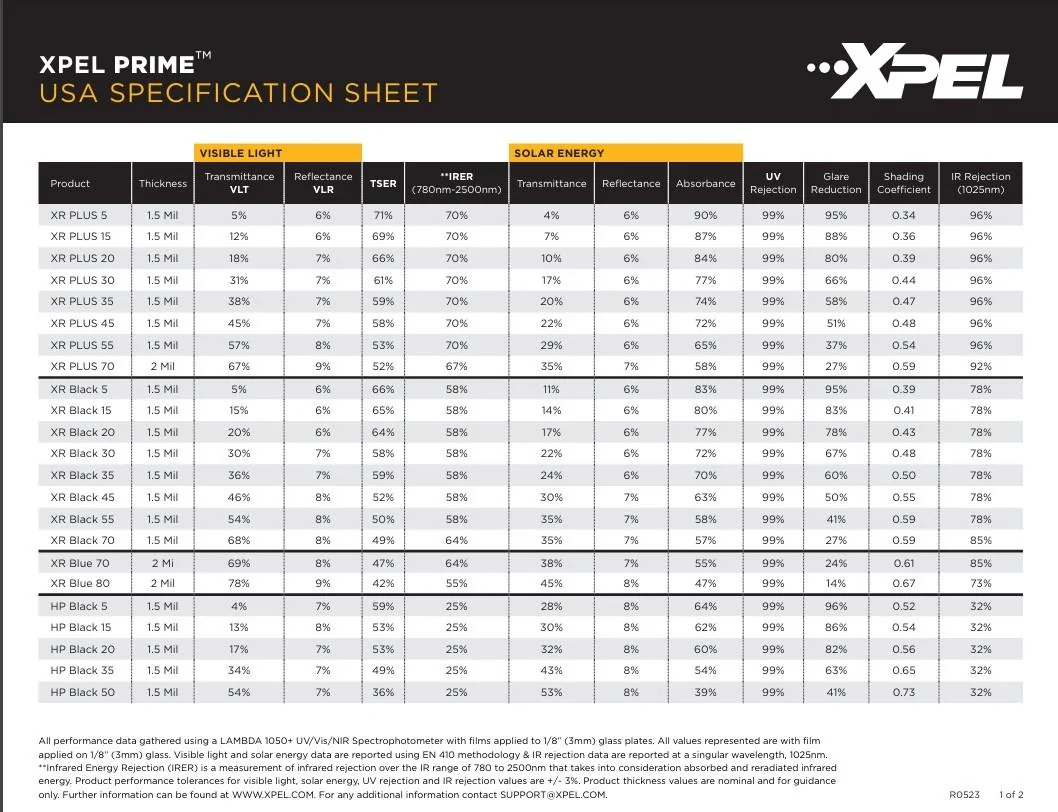

Just a thought, use a shade. If you can see through the tint, it's not enough protection. If you just want to look cool or are paranoid that someone might see you, just say that.
An understandable, yet incorrect and insufficient, perspective.
A shade, though it may block a majority (if not all) visible light, depending upon material and coloration will have varying impact on infrared (IR) and ultraviolet (UV) transmission. Furthermore, as they are removed when the vehicle is in motion, are not effective when the vehicle is in use.
"Enough protection" is a subjective statement. For example, as I am a grandparent with a family history of cataracts, I chose a high-visible light transmitting tint to minimize impact to my night driving. My daughter in her 30s would opt for a darker tint to suit her objectives.
With a Total Solar Energy Rejection of 42%, IR rejection of 99%, and UV rejection of 99%, while retaining nearly 80% of available visible light in a vehicle with what is effectively a large-greenhouse that spends considerable time outdoors in South Texas in the summers, I'd say the tint is, "enough protection" without having anything to with appearing, "cool" or enabling, "paranoid" behavior.
Ford F-150 Windshield Tinting - Questions XPEL_Ceramic_Tint_Spec_Sheet
