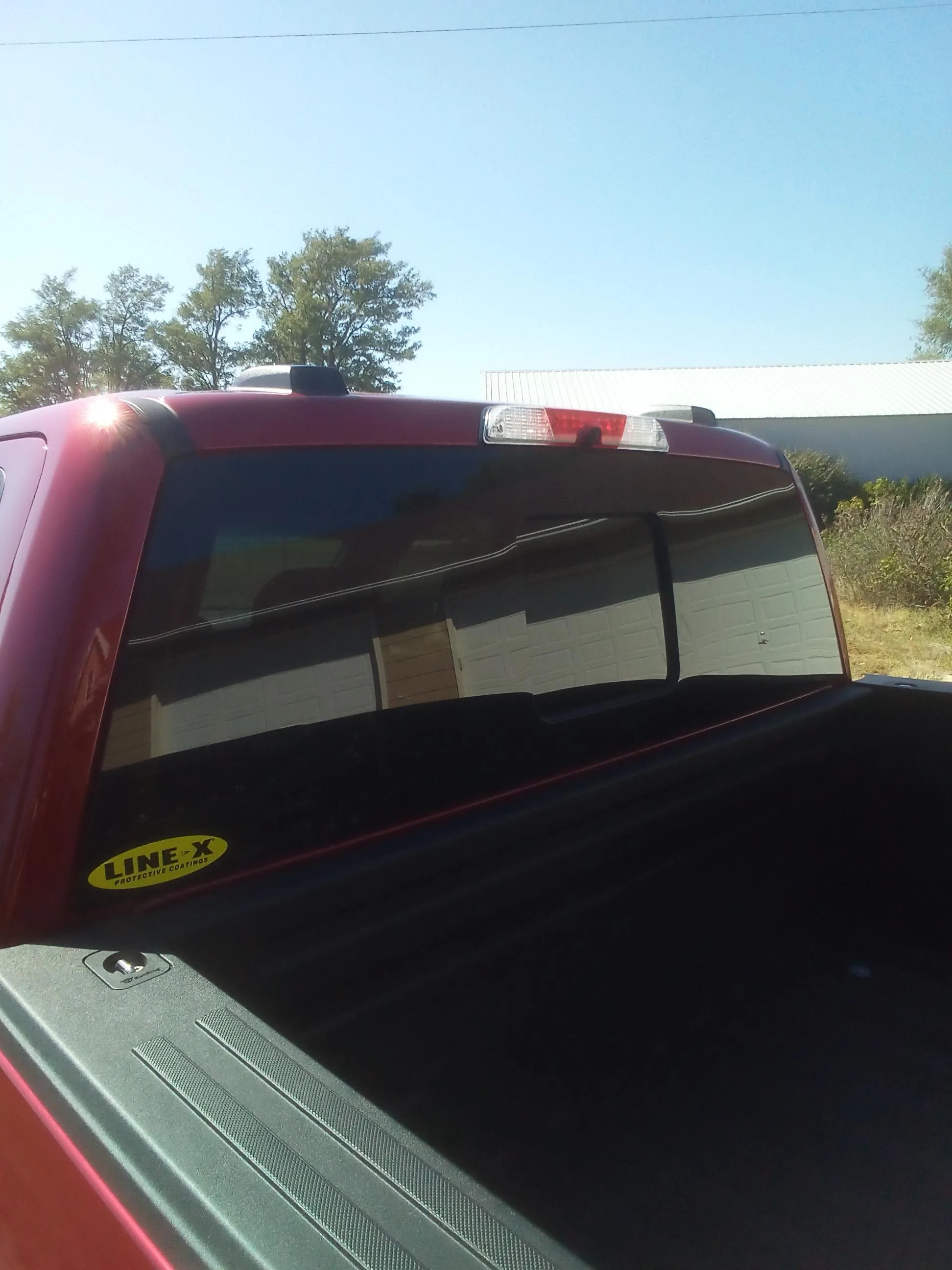

So here is XPEL Nano Ceramic @ 70% windshield, 5% eyebrow, 35% front windows, 70% rear side windows and 70% rear.
