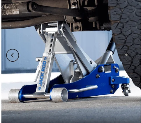

I saw this the other day some where that looked cleaver. Not cheap but might save from having to store another pair of jack stands....
Ford F-150 Which jack stands do you use or where do you place them? 1703424159228

I would still use purpose built jack stands instead of some bar.
