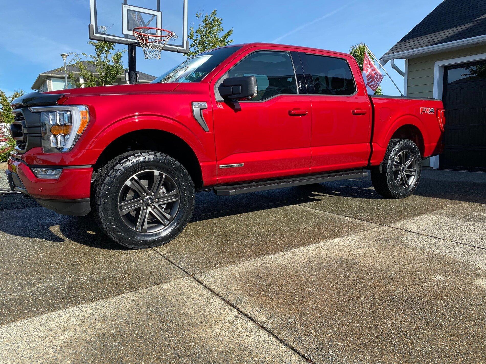

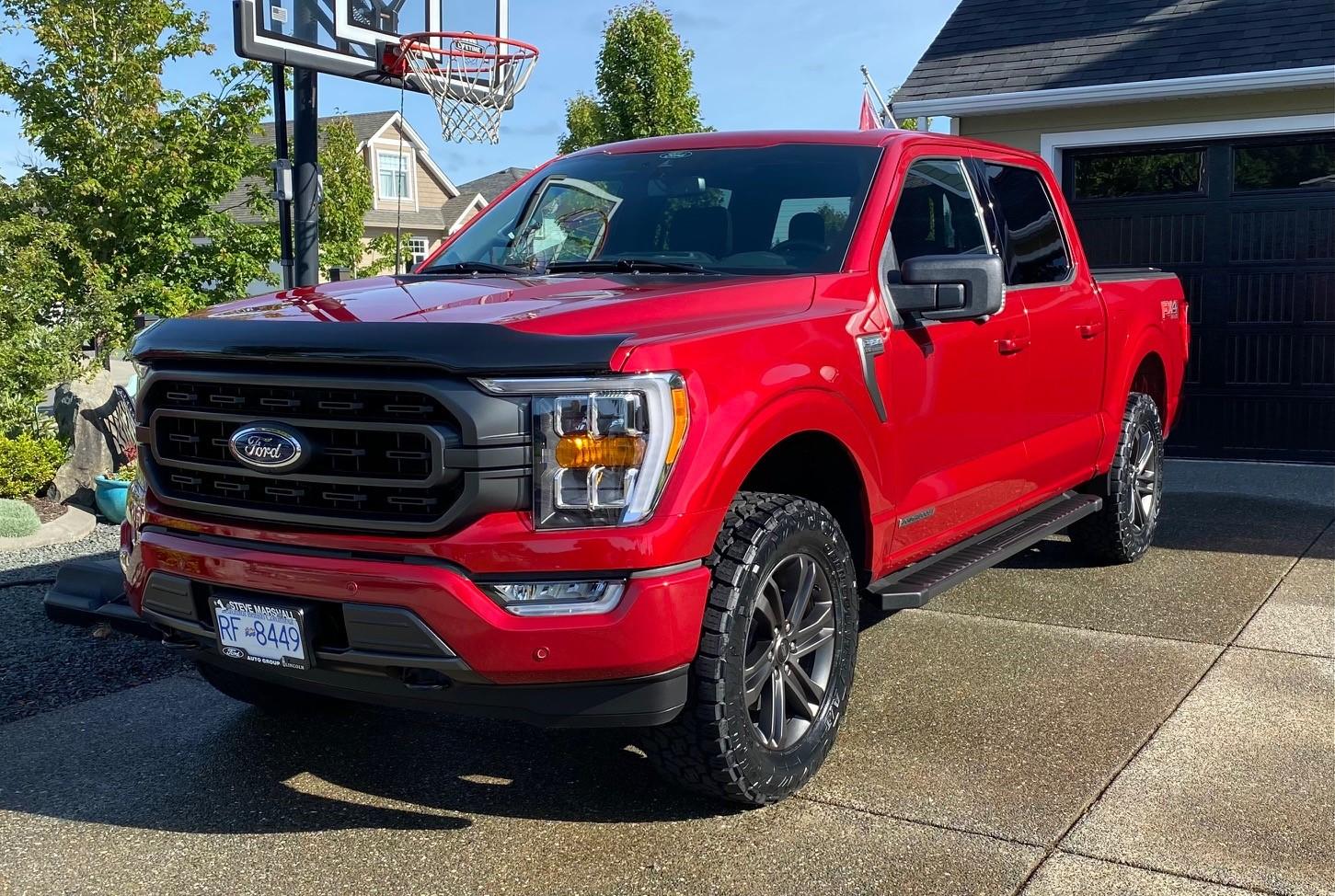

Picked my Powerboost up in early June - XLT 302A FX4 Sport. Just installed the 2" level kit with 295/60R20 Toyo AT3's and added the Truxedo lowpro Tonneau! Will see how much of a hit these Toyo's and Level kit take on the mileage....
