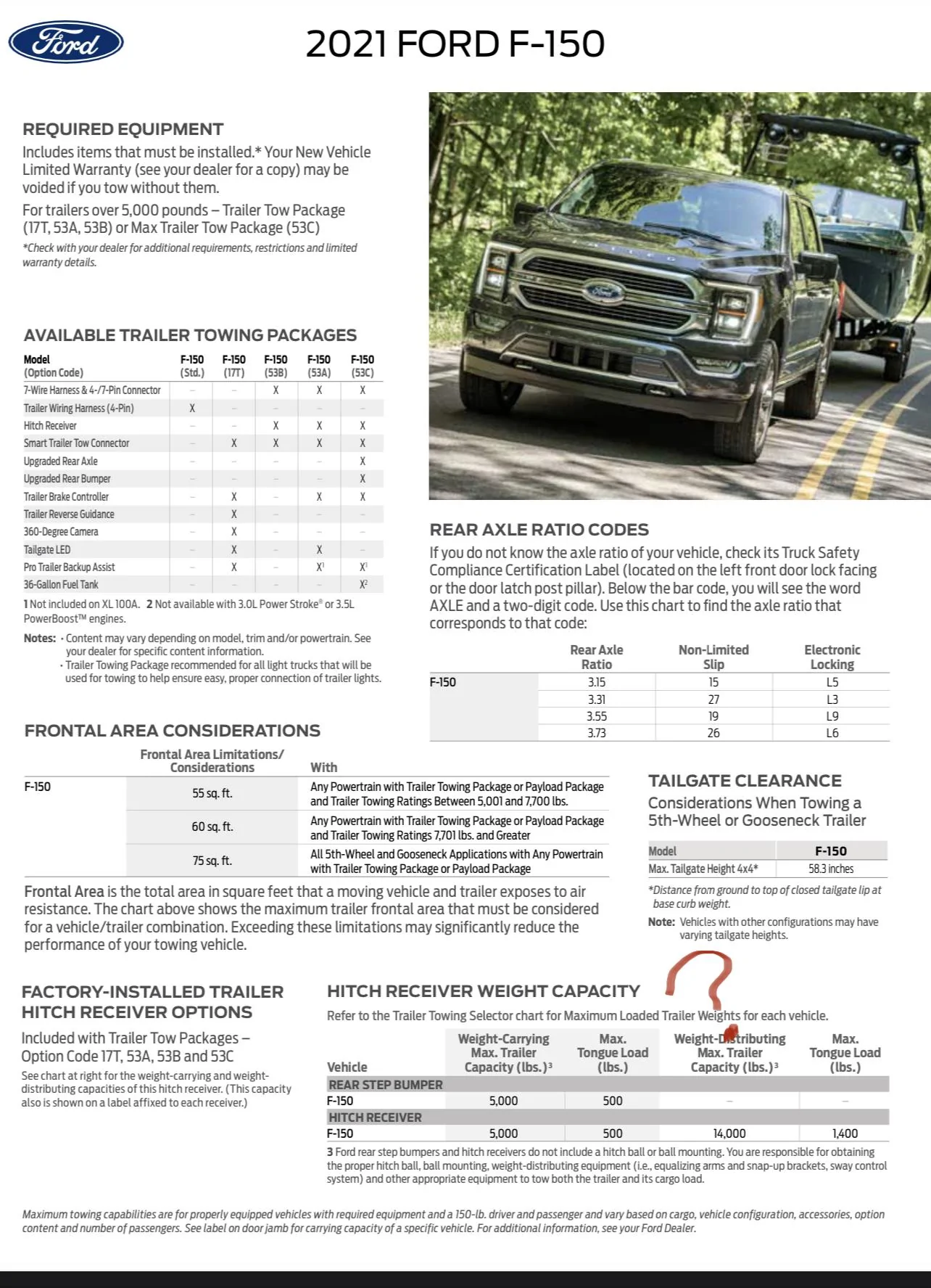

Could someone point me to a definitive guide on when to use a weight distribution hitch? As far as I know f150s should use a weight distribution hitch when the trailer is over 5000 pounds or the tongue weight is over 500. But that said I see videos on TFL (or other YouTube channels) of them breaking this rule. See trailers out in the wild that are definitely over 5000 pounds with no weight distribution hitch. I spend time trying to find a definitive answer but went in circles. What do you all do? Appreciate it.
