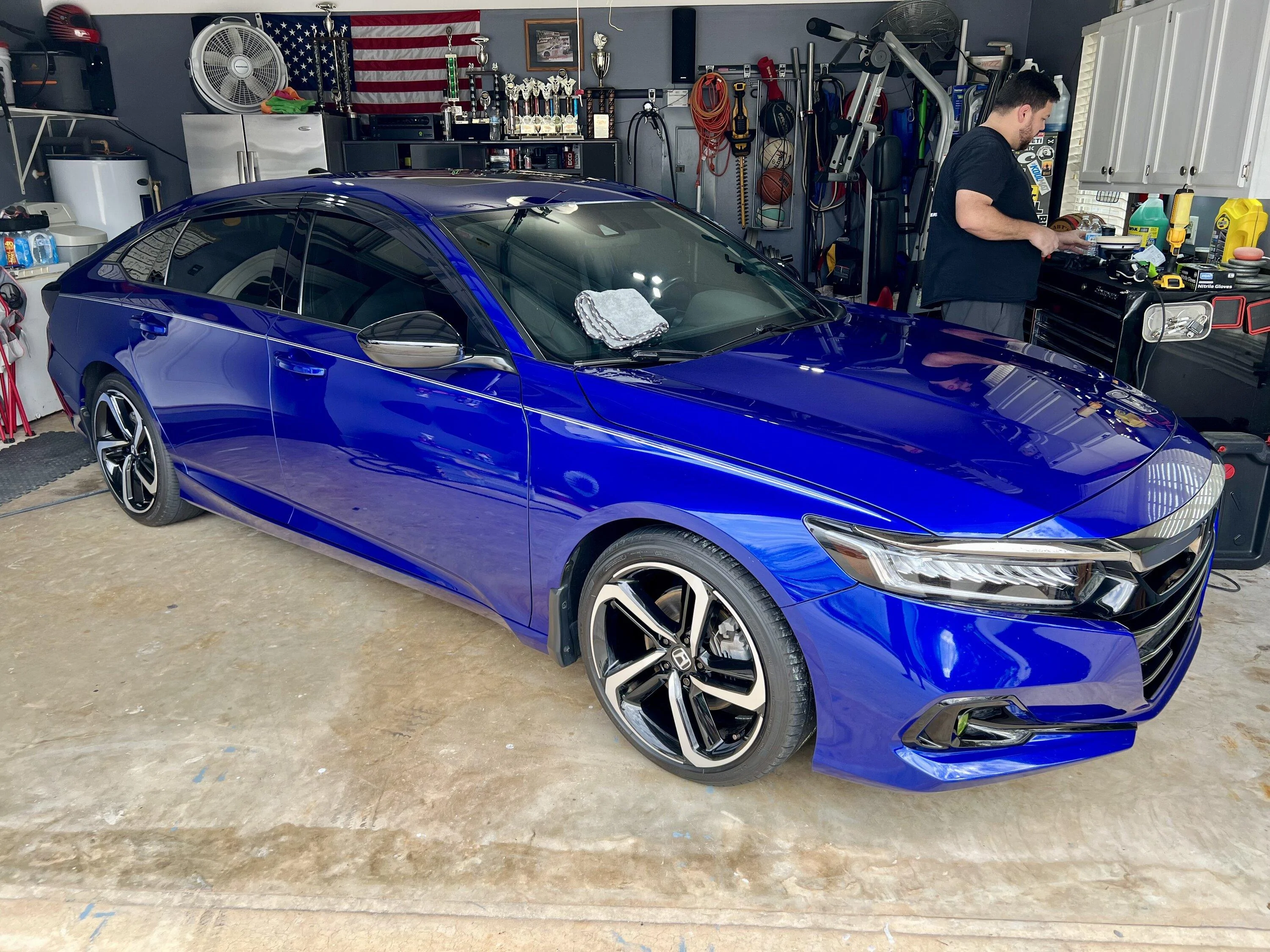

Just last weekend I did my buddies Accord with Gtechniq CSL and EXO.
Ford F-150 What Ceramic coating works for you? IMG_4994
Regardless of what coating system you use, the prep work is absolutely critical to getting good results. Both pictured I did a two step correction using Rupes pads, polishes, and buffer.

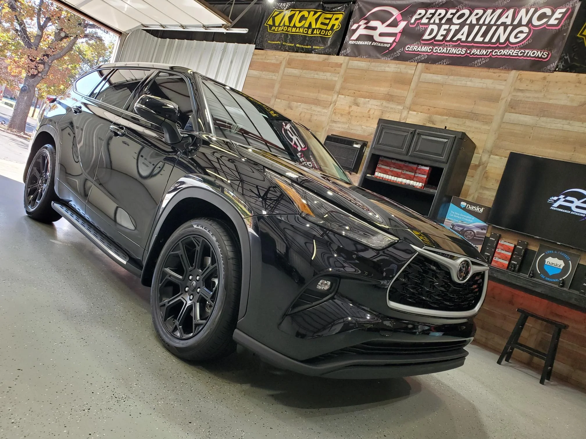

I will say, Ive had two cars done...and my wifes black Highlander is SUPER easy since its coated.
