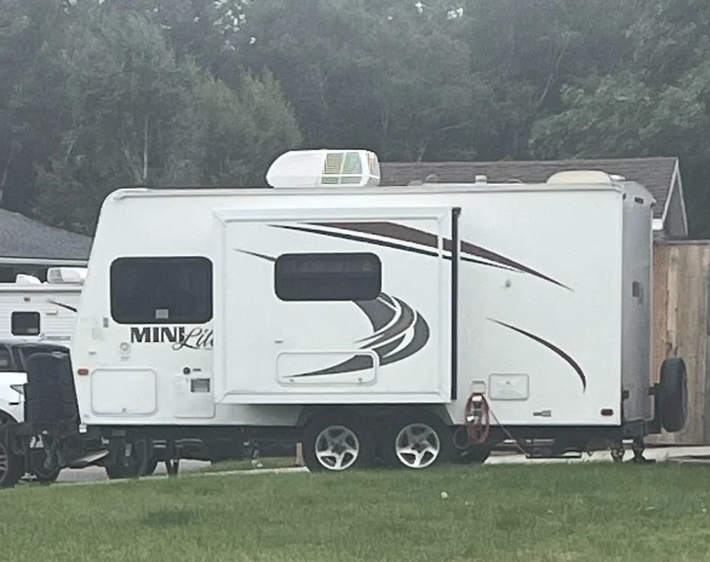

22’ Rockwood Mini Lite. 5800 lbs. loaded as per cat scale. Towed 12,000 miles, 65 mph tops. Average 9.6 mpg. 36 gallon tank is your friend.

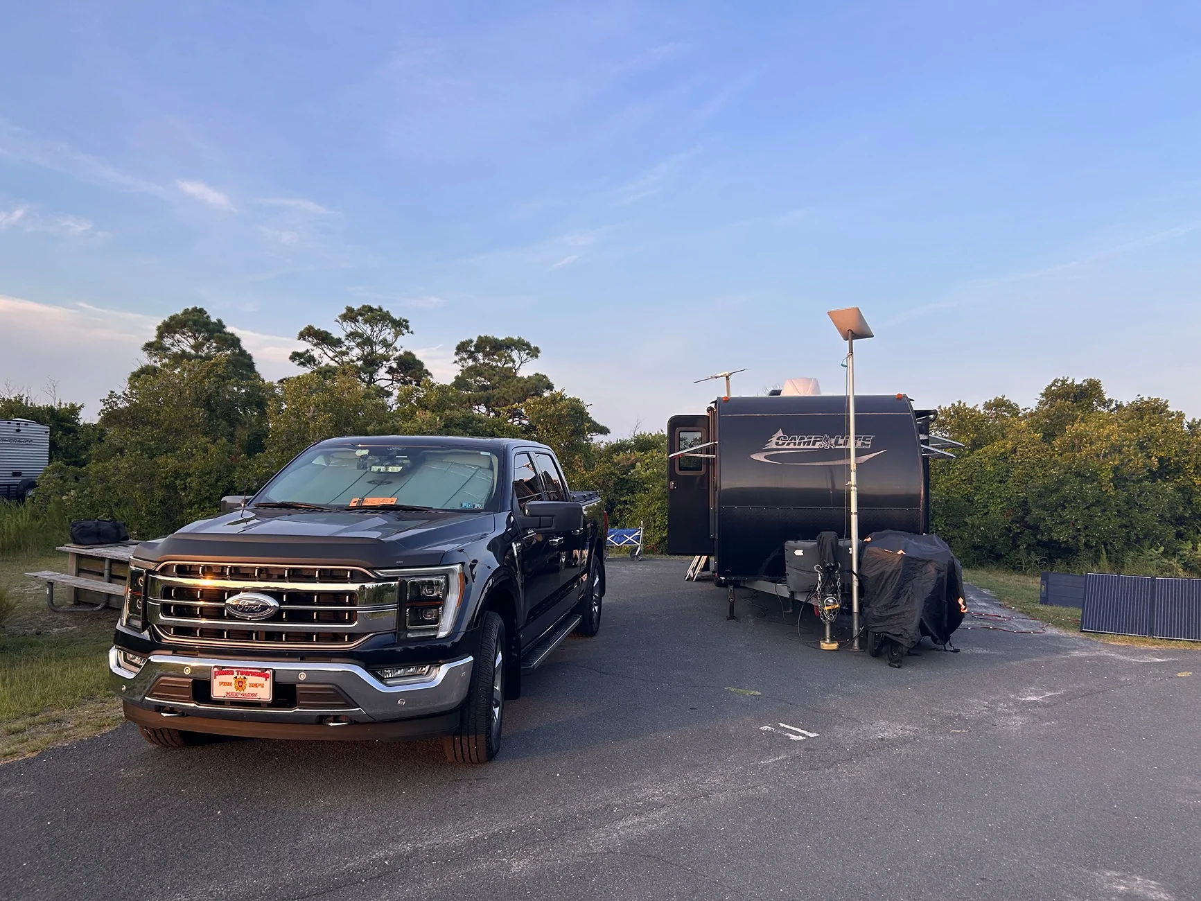

Hey there!
My family recently made the leap from a small pop-up to a travel trailer and haven't looked back. We had our pop-up for 3 years and I got tired of all of the set-up and the lack of a bathroom. My new travel trailer weighs 4,200 pounds dry and is 25 ft long.
I have a 2.7 without the max tow package and with 3.55 gears. However my truck has no problem at all. I have pulled the trailer almost 600 miles this summer and am averaging around 11 mpg using 93 octane.
My suggestions would be to look into getting a weight distribution hitch that has anti-sway included. I found an equalizer brand hitch off Facebook and absolutely love it. I know there is some debate on whether you need a WD hitch for a trailer under 5,000 pounds but I can tell a big difference. Also I would recommend looking for a trailer with double-axles like what you have pictured as there are numerous benefits to having an extra set of wheels.
Also invest in a set of K Source Snap & Zap clip on tow mirrors (mine are on in the picture below) they are awesome and look totally stock.
Best of luck in your adventure!
