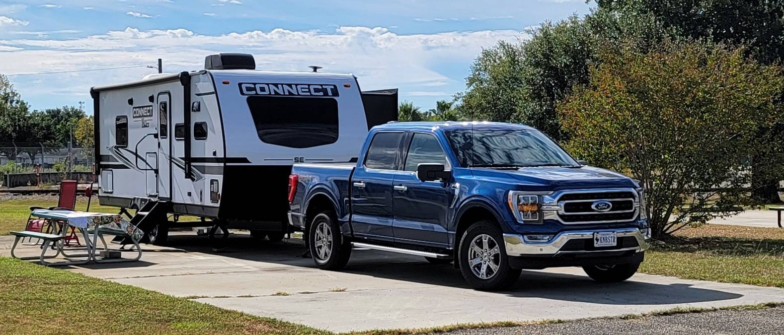

I have nearly the same setup weight wise. Had it for two years and have traveled over 20,000 miles with no issue. Only upgrade was replacing the cheaper stock tires on the trailer with slightly wider goodyears. That improved handling quite a bit. I use cruise control most of the time and hold it at 65 - 68. I did learn recently that it's recommended to use a higher octane gas when towing. Didn't know that and have been running 87 with no issue. Next time out I'll up to the next grade to see if it makes a difference. Average 21 MPG overall when not towing, 10 when towing. Really love the setup.

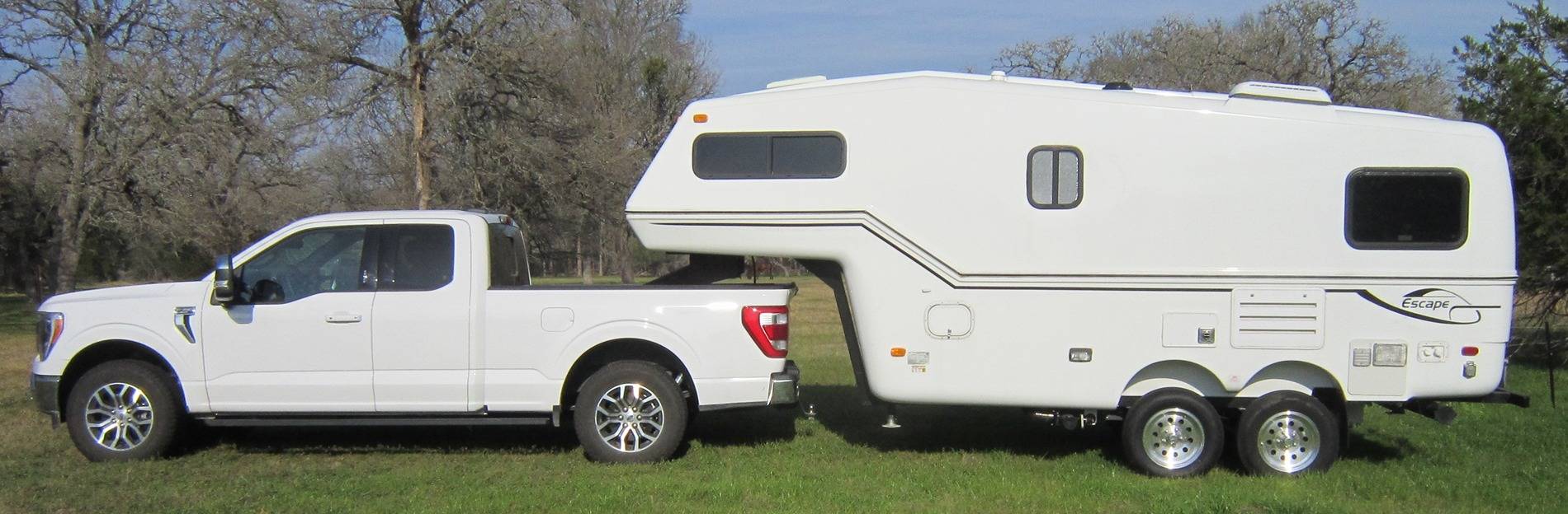

Yepper, the rig tows, handles, and maneuvers like a dream .... (y) :)
Ford F-150 Can my F150 Handle Towing This Travel Trailer? LARIAT WITH ESCAPE 01
Ford F-150 Can my F150 Handle Towing This Travel Trailer? LARIAT WITH ESCAPE 02
Ford F-150 Can my F150 Handle Towing This Travel Trailer? RIG WEIGHT SUMMARY
Gotta love a well-matched 'Fiver' rig :wink: :D

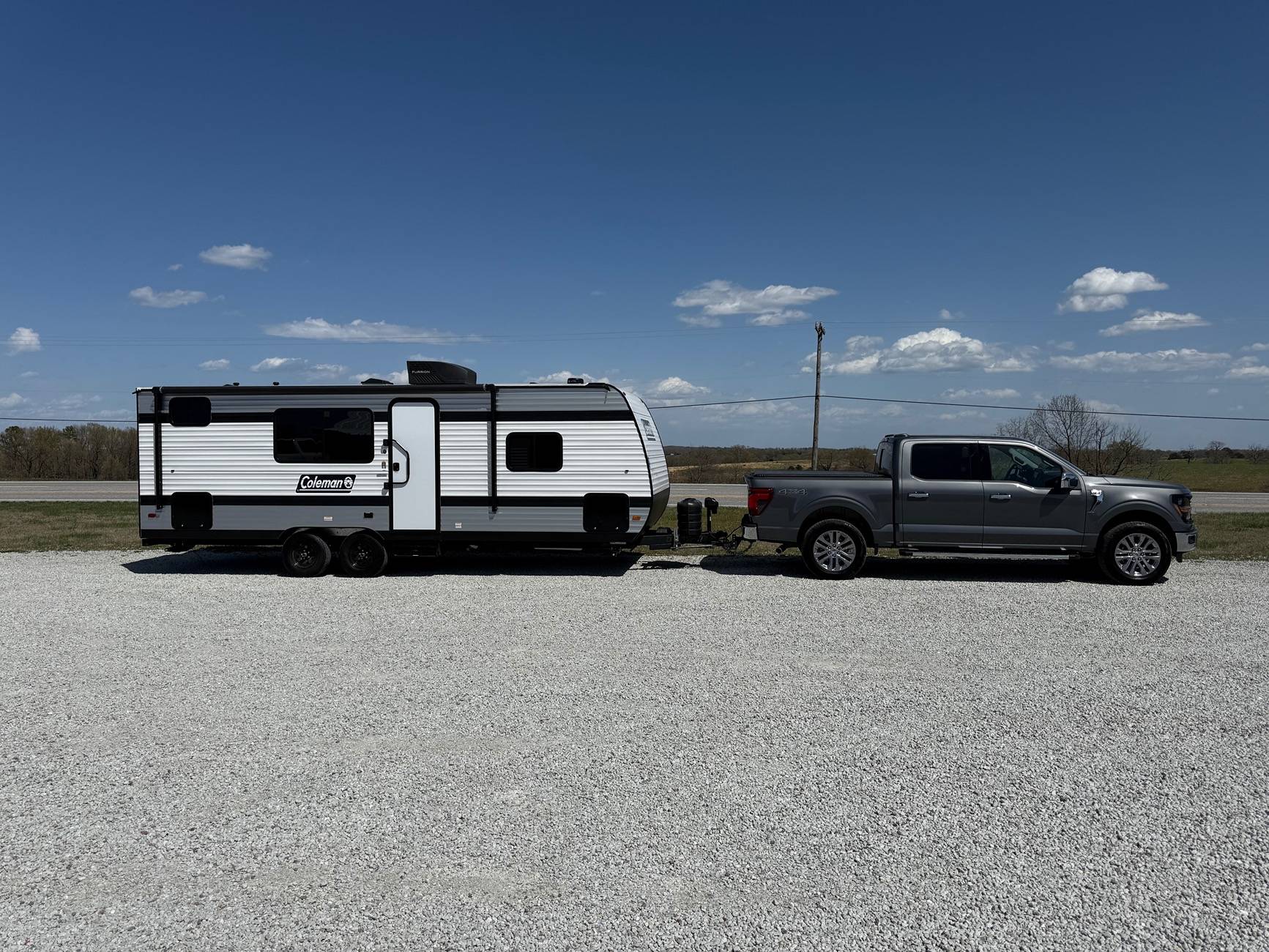

I am glad I saw this thread. Here is my setup and it has a little more sway than I like in windy situations. I think my first upgrade needs to be to get rid of these junk SL tires and go with a 285/60/20 8 or 10 ply tire.

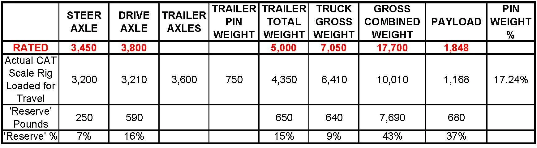

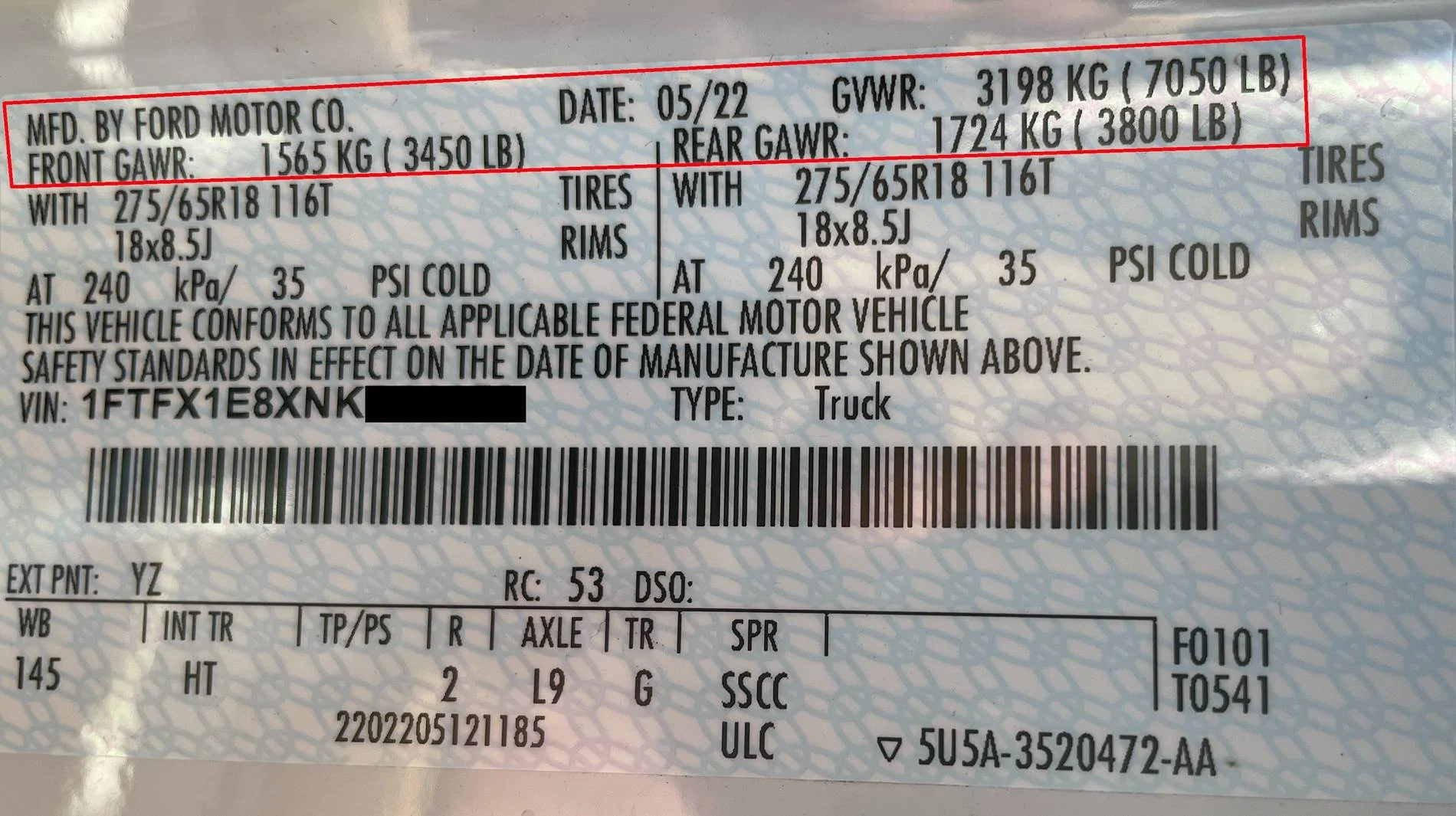

My 2022 Max Tow vehicle has a payload rating of 3,250 lbs and that includes passengers, cargo in the cab and bed.
Just curious, what are the GVWR, Front GAWR, and Rear GAWR from the door-placard on your truck?
Ford F-150 Can my F150 Handle Towing This Travel Trailer? CERTIFICATION and WEIGHT RATING LABEL
With a CAT scale showing a rear axle load of 3,210 the truck is overloaded with the addition of a driver.
More just curious, what was the CAT scale front axle load when that rear axle load showed 3210#?
