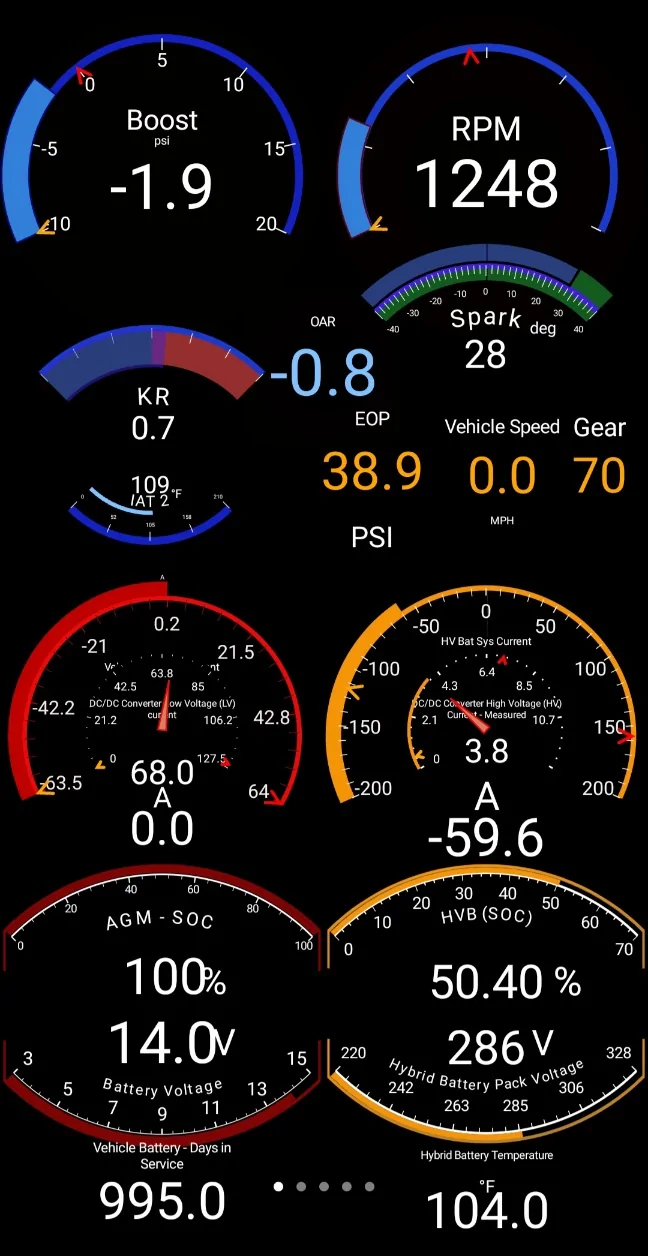

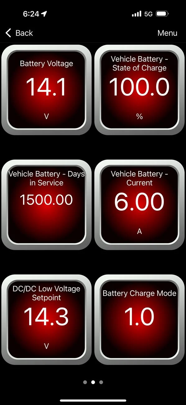

It could be because a few of us have followed the mad scientist (HammaMan) and swapped our Powerboost Auxiliary battery for an LFP battery.
It's just too tempting to look at the OBDlink dashboard and see 100% SOC 😁
(lower left)
Yup, I’ve done that too. It’s nice to see a 100% SOC and resting voltage of 13.2, vs 12.5 on the OEM setup.

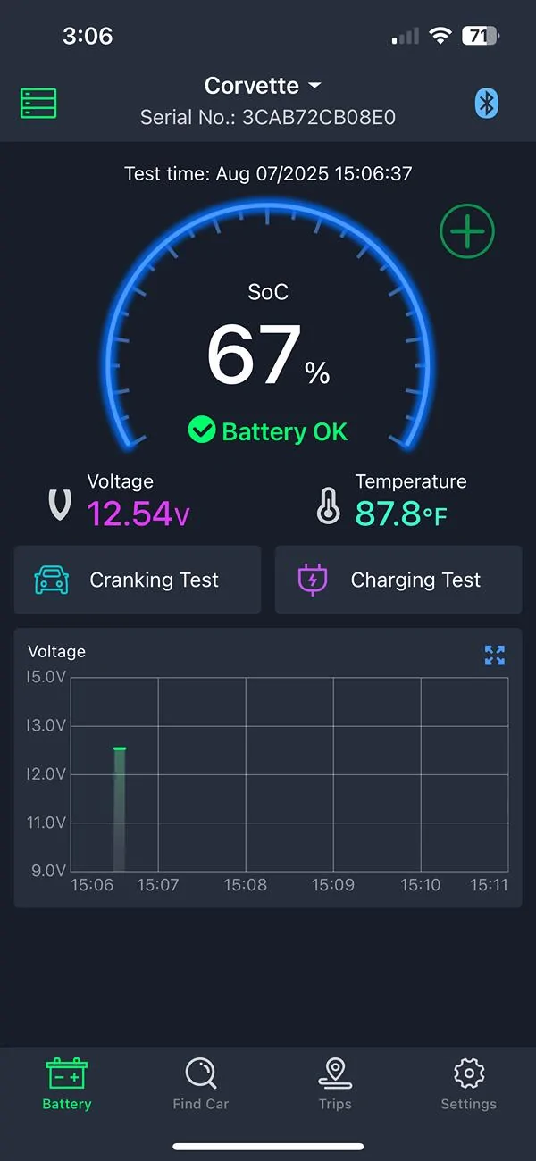

Pretty funny how the same concerns pop up for the C8 corvette. Since I put a Bluetooth monitor on my truck I decided to put one on my vette as well. Have never had an issue on the original 4 year old battery.

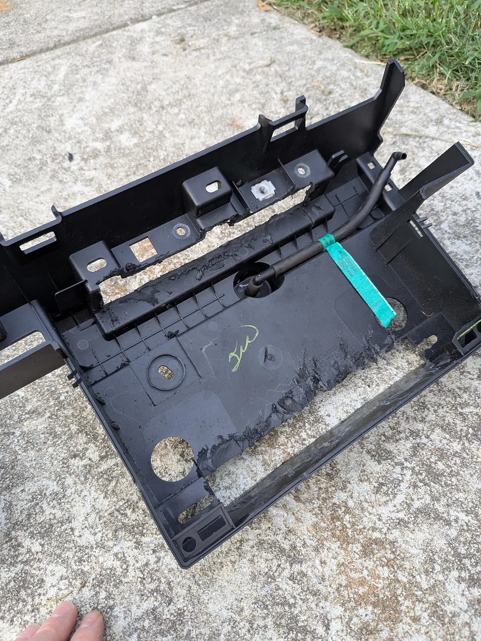

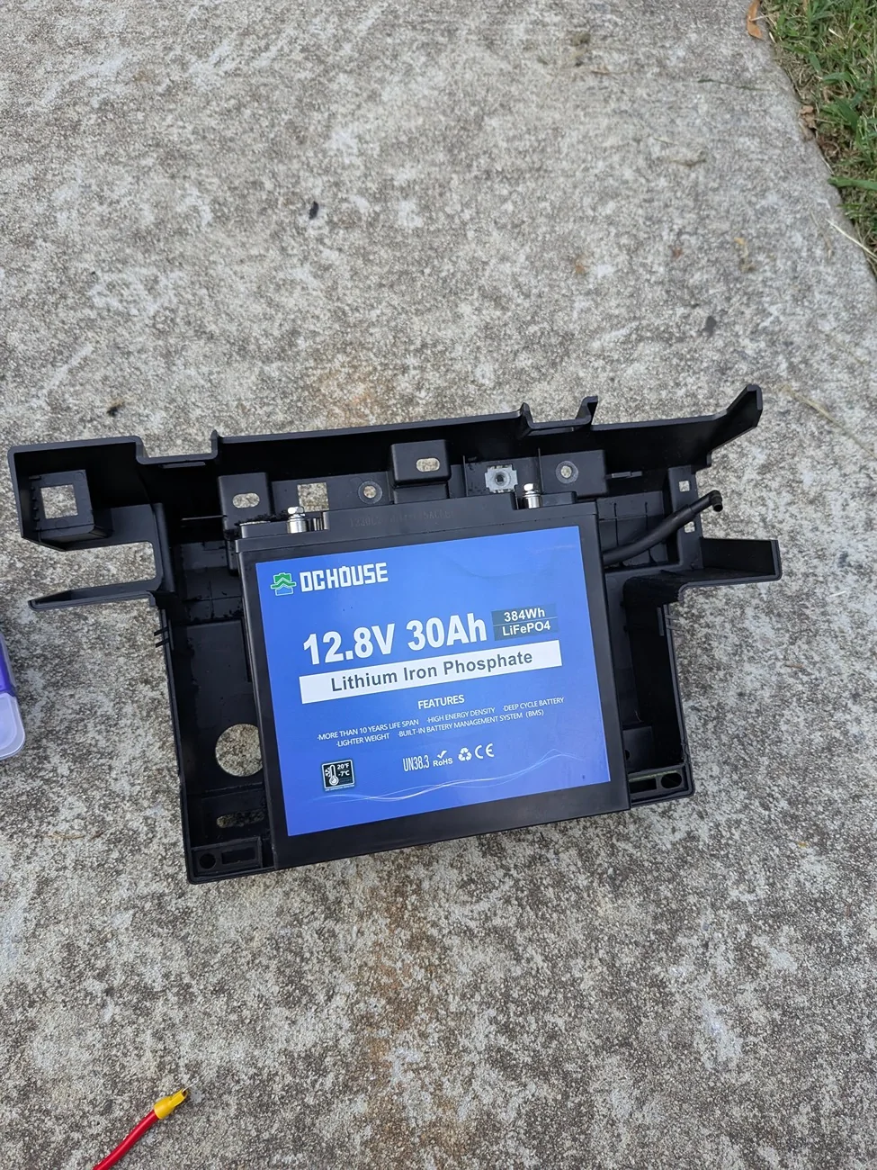

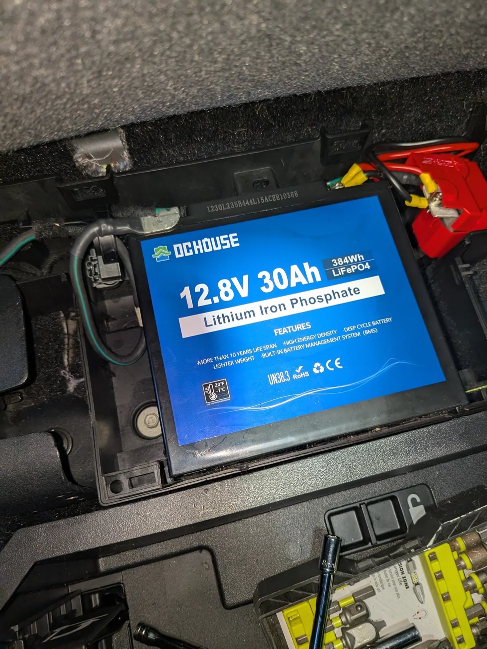

Installed this mod today and excited to see how it performs - thanks for sharing! My truck started giving me the dreaded "System off to save battery" message so figured I'd try this before replacing the AGM under the hood. Took about 2 hours overall.
The "mini" Eco-Worthy battery HammaMan suggested from Amazon wasn't available, so I ended up purchasing the smallest 30Ah I could find, which was one from DC HOUSE. It allegedly has low temp protection which I liked though it shouldn't be necessary in my climate. It included a few 9AWG wires for free which I wired up in parallel for an effective 6AWG on the positive side using an M5 nut and bolt.
I wasn't able to get the battery up to 14.6V with my bench supply no matter how many times I tried to pull current from it at 14.4V with some LEDs, it wouldn't accept 10mA or 20mA above that voltage, so I just sent it at 14.4V - 0.05V per cell didn't seem like too much, but I guess time will tell.
After mangling up the aux battery box with my oscillating saw while it was in the truck, I decided to remove it and do further modification with a Dremel and the saw. Highly recommend removing the bracket, it's only 2 extra bolts.

Had to modify the lid for the box too:
Ford F-150 Testing an Aux batt solution... PXL_20250821_235650351
Ford F-150 Testing an Aux batt solution... PXL_20250821_235644932
And it _mostly_ closes, except for the side near the negative terminal - I suppose because it's sticking up there, or because I can't quite cram the measurement CT on the side
Ford F-150 Testing an Aux batt solution... PXL_20250822_000100277
Ford F-150 Testing an Aux batt solution... PXL_20250821_235029733
edit: I don't recommend the DC HOUSE for this battery, see here

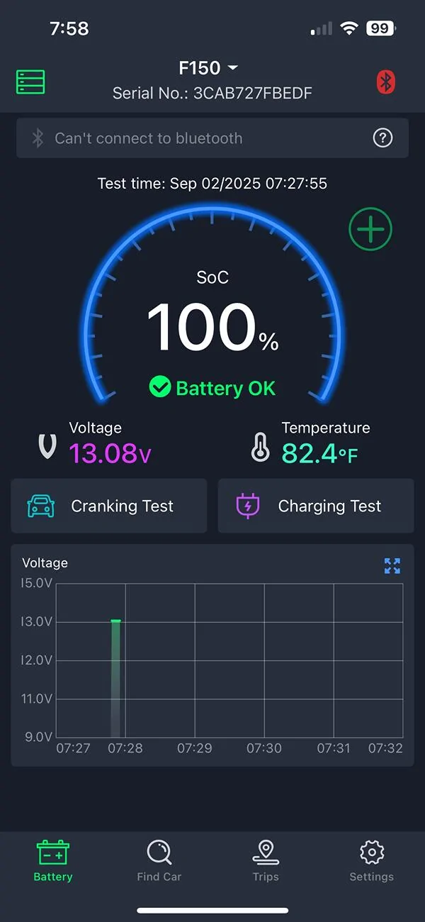

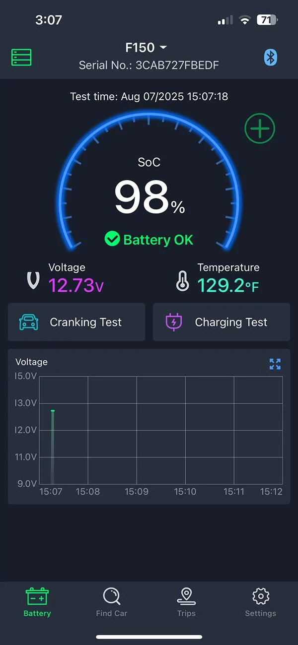

I have both the Noco and the Eco Worthy. Initially I just installed the eco worthy as is and everything worked just fine. After installing a blue tooth battery monitor I was watching the battery SOC. Never reached 100%, typically around 80, which is fine, but it kinda bugged me. Finally decided to hit it with the NOCO.
I disconnected the aux battery and set my Noco to lithium. Didn't take long for it to reach full charge. While still disconnected, I changed the Noco to AGM, and did the same for the under hood battery.
After sitting all night, took this snapshot this morning.
