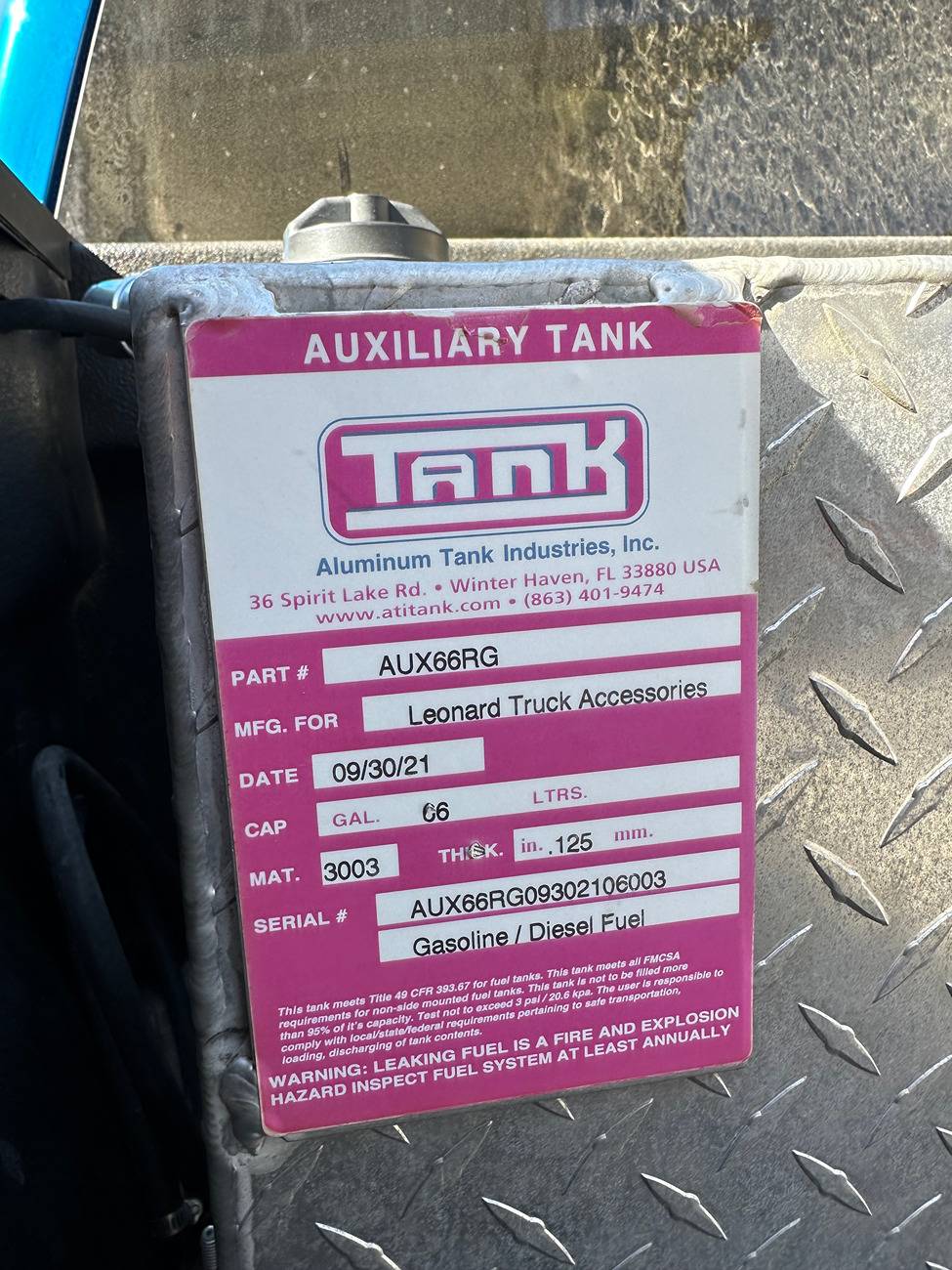

I added a 66 g aux tank to mine. It has to be certified as an aux tank not a transfer tank. Be careful n plumbing it in as both the feed into the main tank and the tank vent line must be plumbed in.
