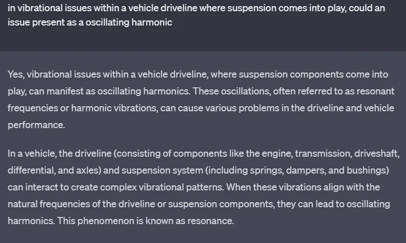

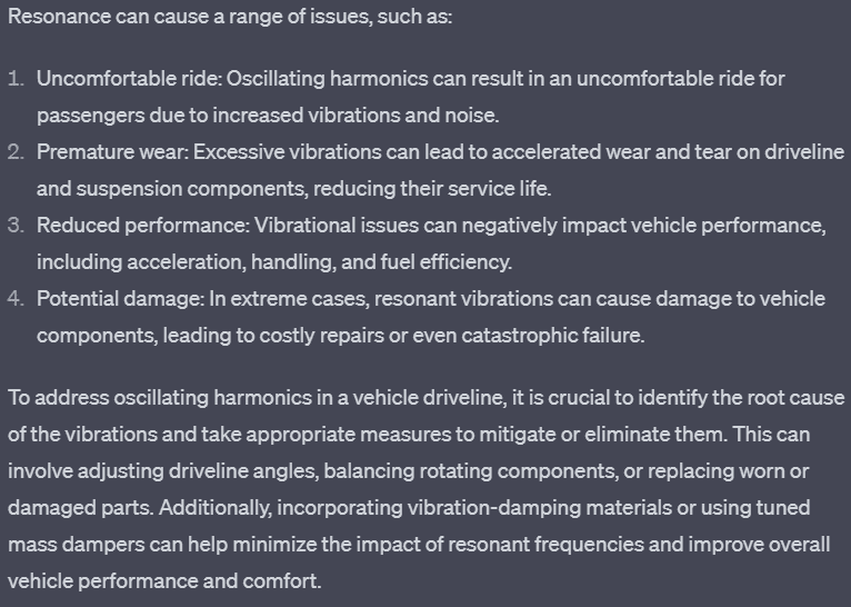

I thought I saw something mentioned about an issue with the compound drive shafts. I could be imagining it. Another variable at play is your front driveline that's now fully engaged starting with the 22s and up 4a transfer cases. All components within the entire driveline could be a potential cause, not just the rear's. I'd be quite surprised if they didn't have a sensor for monitoring vibrational frequencies. That'd tell them a lot. By knowing the frequency it's easier to narrow down when at a set speed as it'd correlate directly to the component by either being a direct frequency of its rotation, or presenting as an oscillating harmonic. (the RAS could in-fact be exacerbating this, but something is present nonetheless)
edited to add GPT's response / explanation for those interested...
Ford F-150 Roadmaster Active suspension in a long bed 1681345146017
Ford F-150 Roadmaster Active suspension in a long bed 1681345162750
