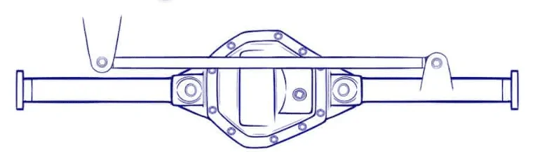

Traction bars hold it front to back, pan hards hold side to side (the better version is called a watts link for some reason). This is an example, but a poor one. A good bar has a proper center pivot instead of creating a curved rotational profile
Ford F-150 Roadmaster Active suspension in a long bed 1682448596220
This is a better design
Ford F-150 Roadmaster Active suspension in a long bed differences-panhard-bar-watts-link-2018-12-23_22-16-21_665499
Leaf springs allow quite a bit of side to side movement of the rear axle when cornering or towing. It keeps the truck planted much better from trailer sway or cornering forces. When trailering in specific it plants the truck much better in sway events as the rear axle movement isn't contributing to oscillation and oscillation inducing feedback.

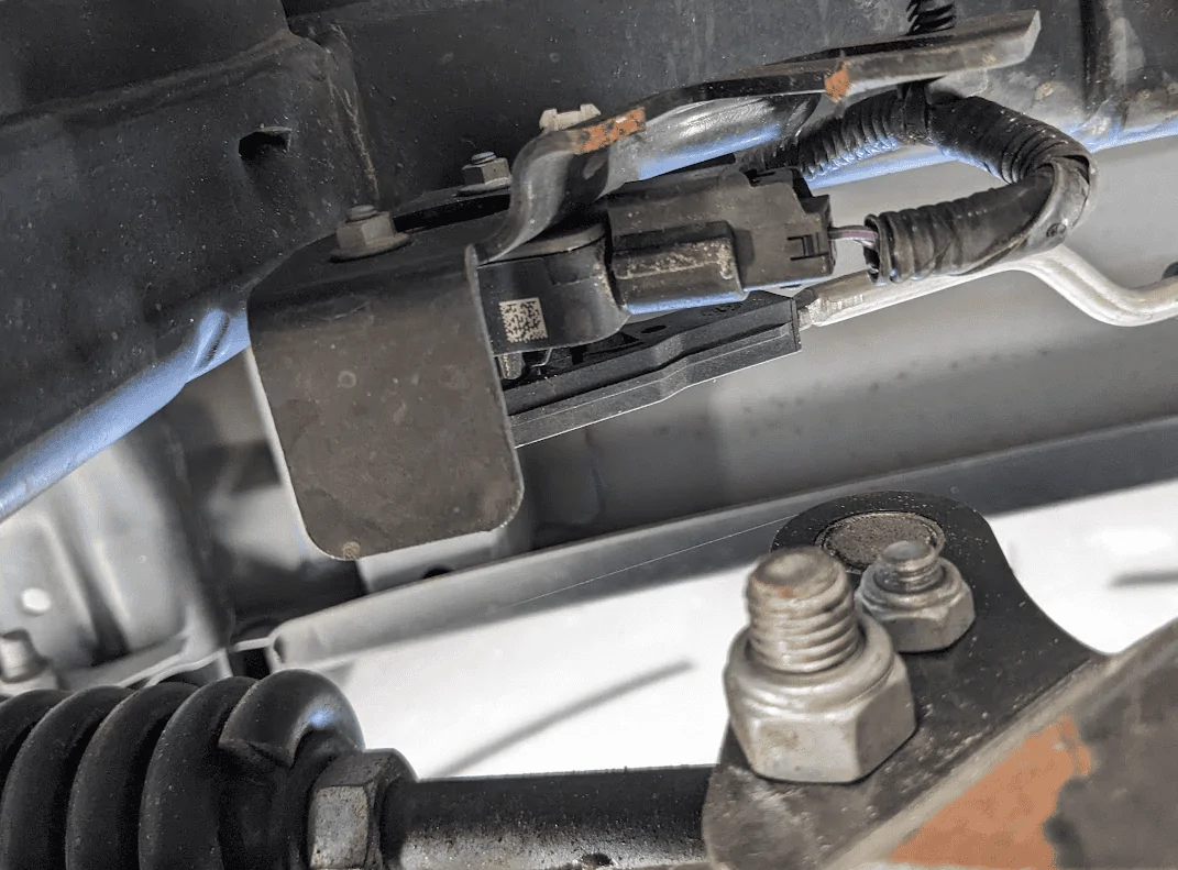

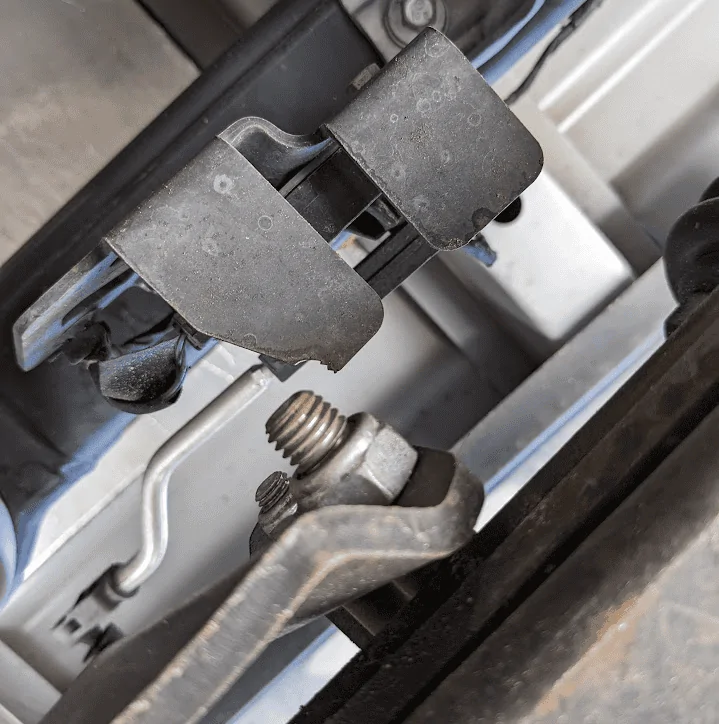

I've developed a squeak from the rear when hitting uneven surfaces and when turning. It sounds like an old ass truck or trailer with old rusty leafs. Not sure if it is the RAS or the pucks on the leafs or something else. Only really notice it when empty, so don't think it is the pucks. Really don't want to remove the RAS to determine if it is that or not. Wondering if anyone else has this issue.
My RAS does this. I contacted them and they said it is NOT normal and suggested I remove it and clean the leaf contact areas thoroughly. They said grease shouldn't be needed, but might help.
Also make sure it is not contacting the ride height sensor by the drivers side leaf (if you have one); after my initial install I had to remove and swap sides to avoid it contacting one of the RAS bolts. RAS suggested moving the the bolt location near the block to effectively shorten the side plates, but I had already removed and swapped sides to the bolt head was facing it and not the threads.
Well, that is exactly it. When I looked down from around the passenger tire side, it looked normal a few days ago... but this morning, I crawled under the bumper and holy sh!t..... :oops:

yeah, I figure I need to flip them and maybe buy two new sensor mounts at some point. And yes, RAS needs to put some clarifications both in their instructions, but also on their site. I've emailed them with pictures and will let y'all know if I hear back.
Removed the RAS today instead of flipping sides and all the squeak noises are gone when turning over uneven ground. The ride also seems softer/smoother with no load. I may or may not put RAS back on.
