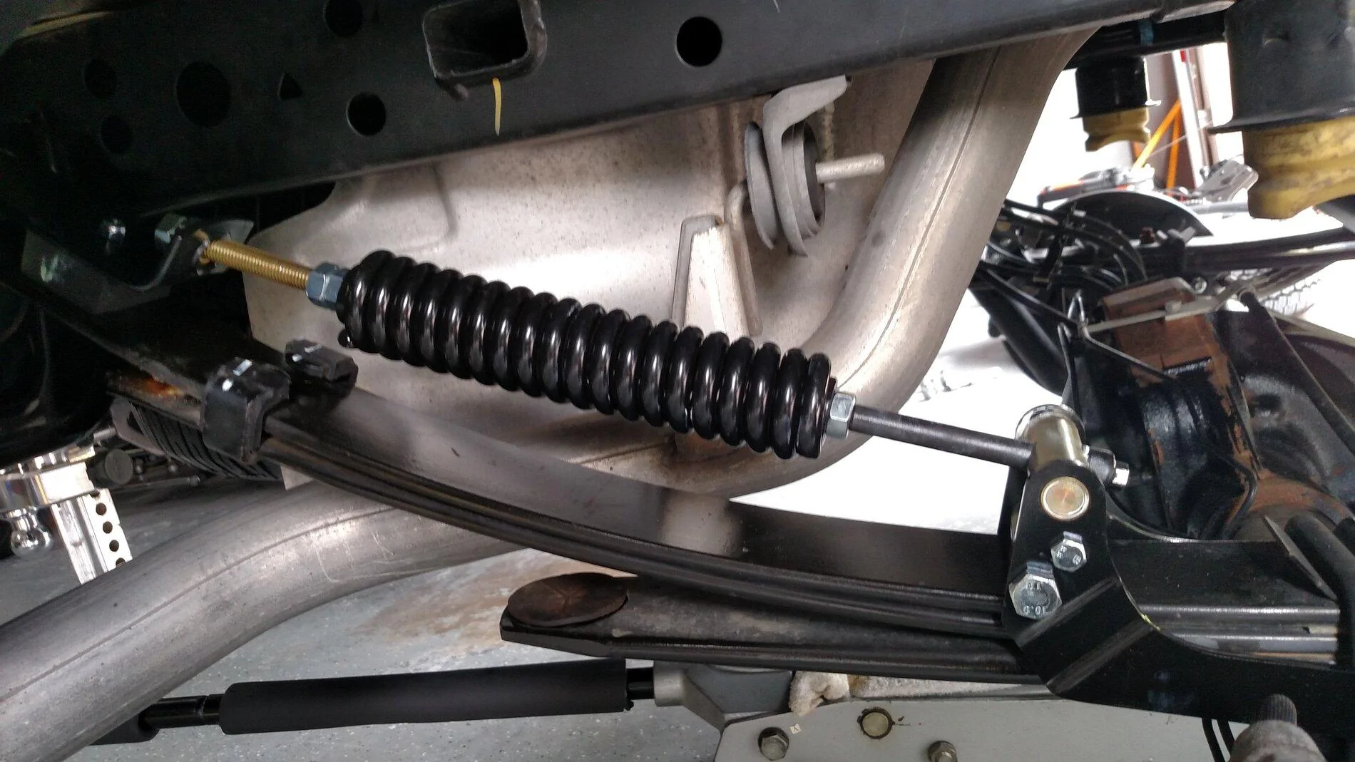

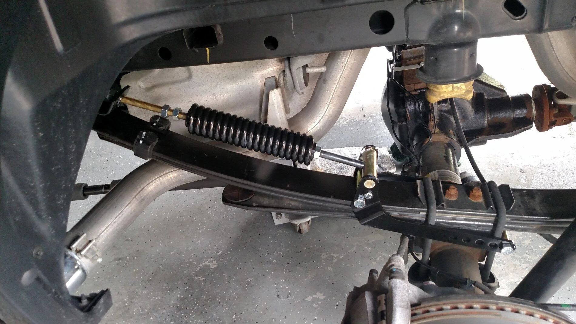

Had it on my 2016. I towed a 24' car trailer and it helped. Oh yeah I had to paint the rear axle because it rusted..... Nothing new......
Ford F-150 RoadMaster Active Suspension IMG_20160617_135227629
Ford F-150 RoadMaster Active Suspension IMG_20160617_141856924
Ford F-150 RoadMaster Active Suspension IMG_20160804_085443999_HDR

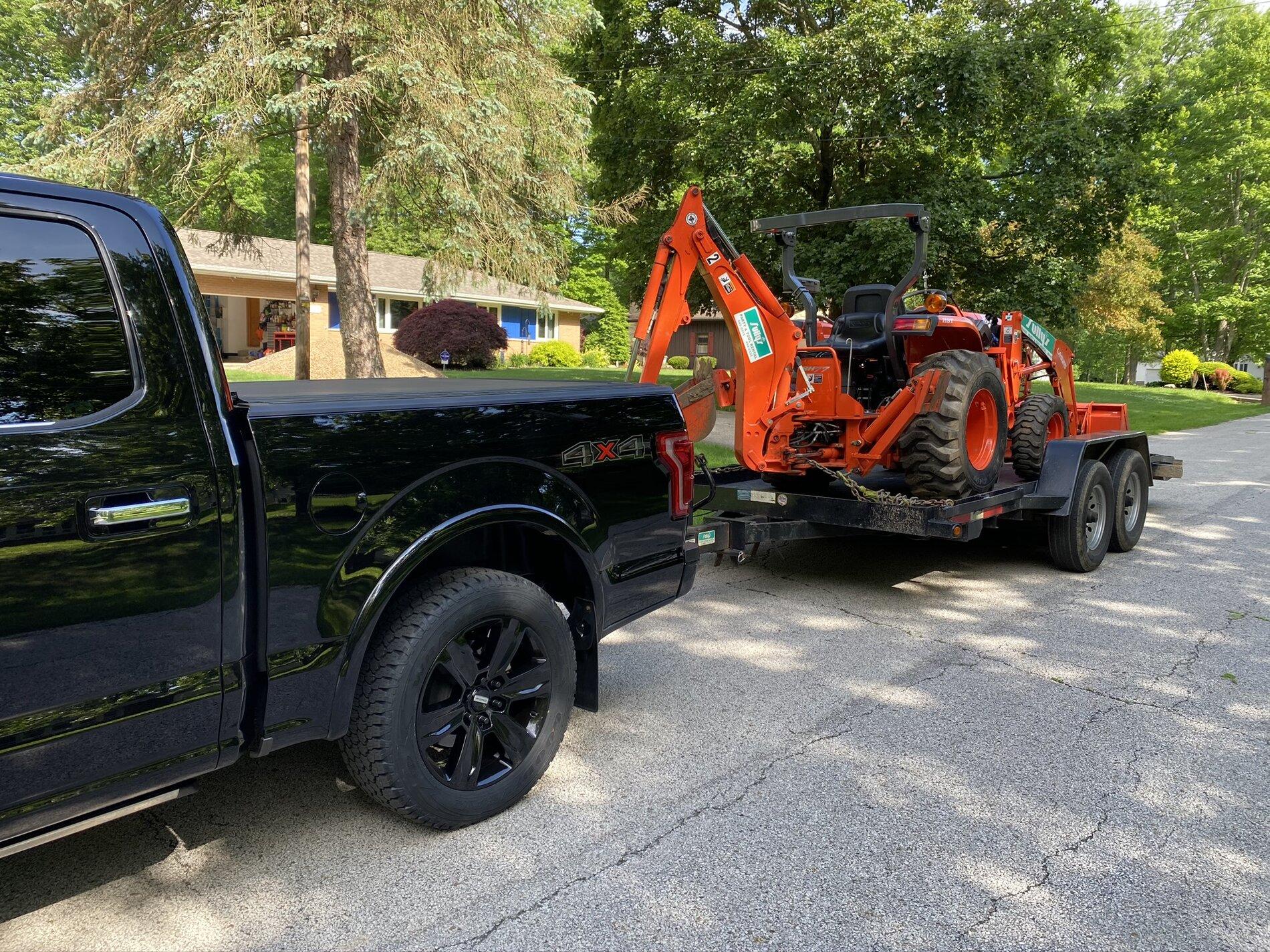

I have them on my 16 and love them! I will be putting a set on my 21 if it ever gets built. They not only help with towing but week hop and body role as well when not towing. I normally tow a 21ft boat and my truck is level with it attached. here is a pic of my truck towing a tractor home for the weekend and you can see the rear end is not sagging much.
Ford F-150 RoadMaster Active Suspension F15673C2-2BE3-45B6-A841-CB5C22069950
