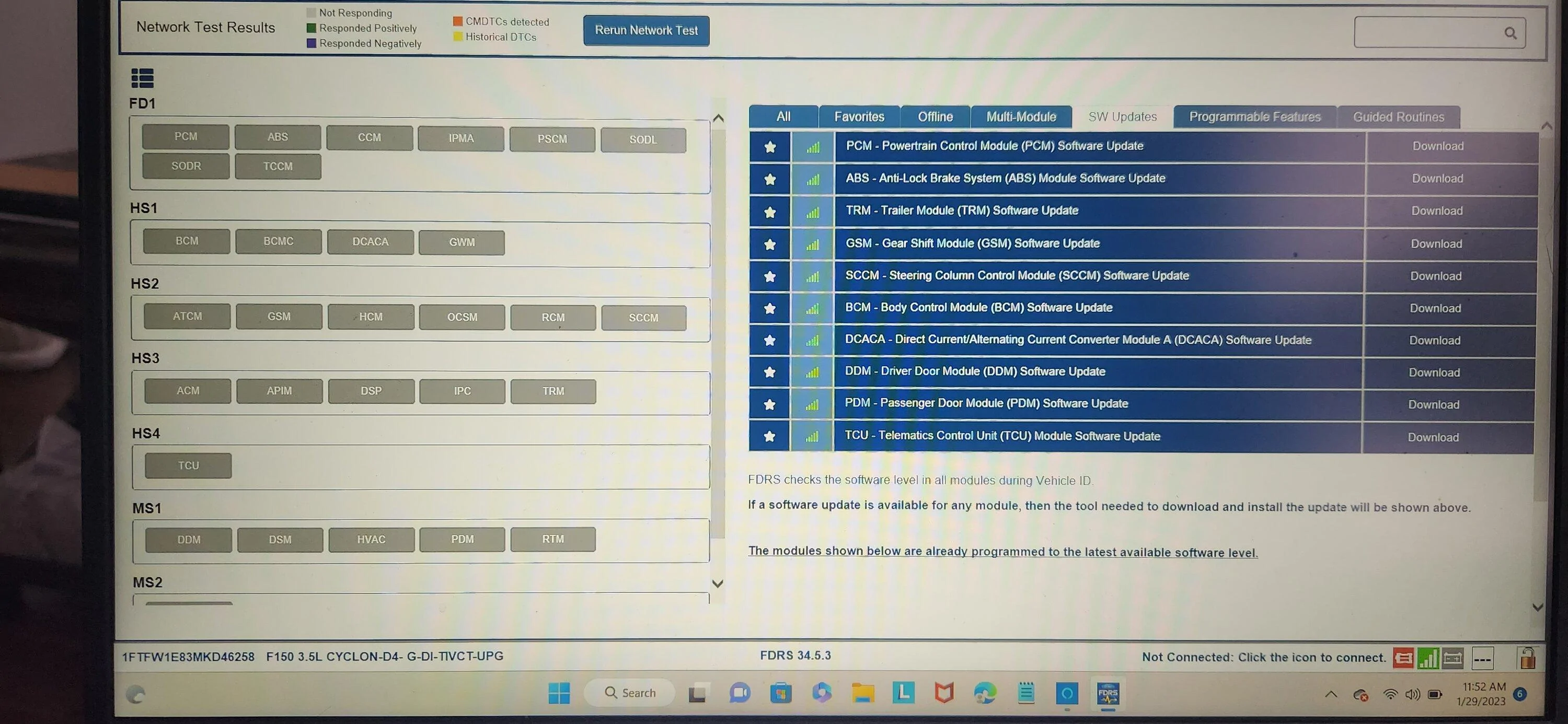

I just purchased a 21 Lariat and from what I can tell it's way behind on updates, any insight would be appreciated. vin# 1FTFW1E83MKD46258

Can someone check my vin I believe I’m stuck and not receiving OTA updates 1FTFW1E87MKE10821 I tried last night had parking brake on lights turned off connected to Wi-Fi still nothing

I spoke with Ford yesterday and they said I had two OTA updates one was canceled in November and one expired in December which I just got the truck maybe January so that would explain it sitting at the lot but I’m still on 22177_product and from my understanding that’s pretty behind
That is far behind. What else stands out to me is you Do Not have an Apim update awaiting either in FDRS. Hopefully someone else with more access/experience can give you more insight.

I went to the dealership fri and asked for them to update the apim and they said I was currently up to date
Frequently, other modules need to be updated before APIM updates appear in FDRS. Are there any pending TCU or GWM updates in the queue? If so, those need to be applied. Then an APIM update should appear. Might have to do this iteratively (applying updates, then rechecking, and then applying new ones that show up) until you are fully up to date.
