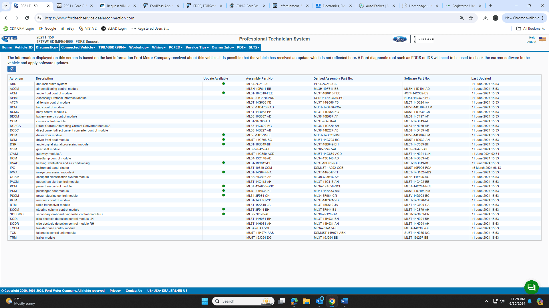

The data hasn't synced with Ford's servers yet. I can see they replaced the APIM, but not much else. Post a pic of your "about sync" screen when you can. You are most likely on Sync 22146 which is very old, but this would mean you are out of the broken software and you can start getting updates little by little now. More importantly, you can now update yourself with FDRS which is what I would recommend.

This is what you have showing. OTA history shows a failed IPC update, so you have that, too even though it does not show and possible some APIM. GWM and TCU updates, too. I would say there are $50 worth here. PSCM & IPMA are tied to each other and will take 3 hours to do, so keep that in mind.
