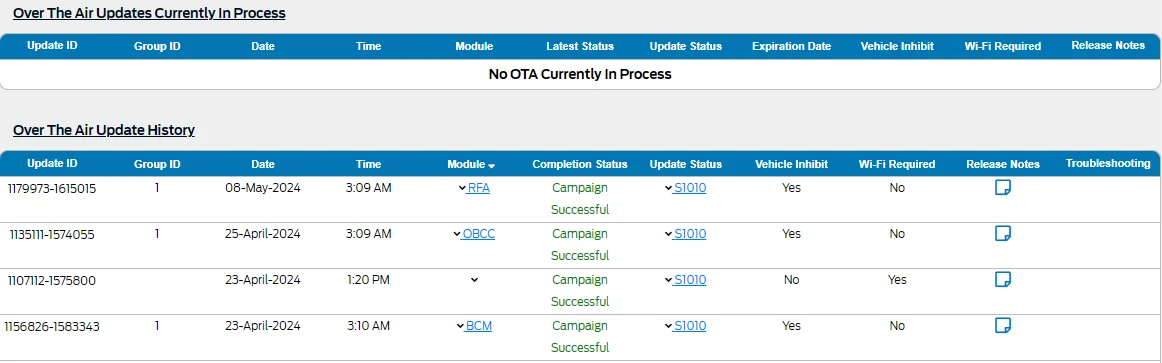

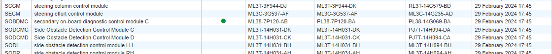

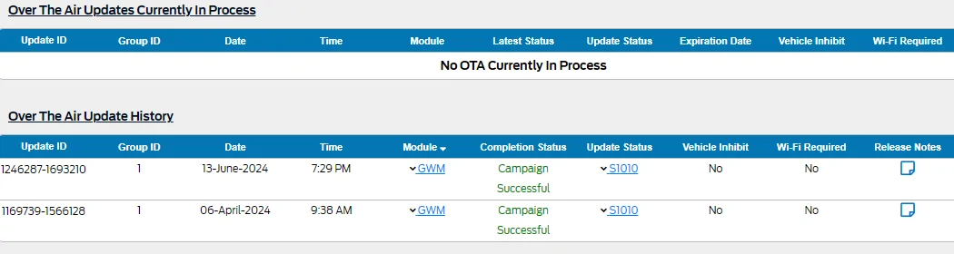

When you have some time, can one of you fine individuals look up my vin and tell me what options are on my Ford Protect plan? VIN 1FTFW1ED9PFA49165
Latest/Pending updates info would be nice since it just keeps showing an update phantom indicator.
Thanks
Kanuck
Don
Aug 9, 2021
2,727
2,875
Winnipeg, Manitoba
Retired Electrician
Ford F-150 Request VIN Lookup Thread 1718995989179-ar
Ford F-150 Request VIN Lookup Thread 1718996010528-w0
Ford F-150 Request VIN Lookup Thread 1718996051051-nc
This is what is showing
