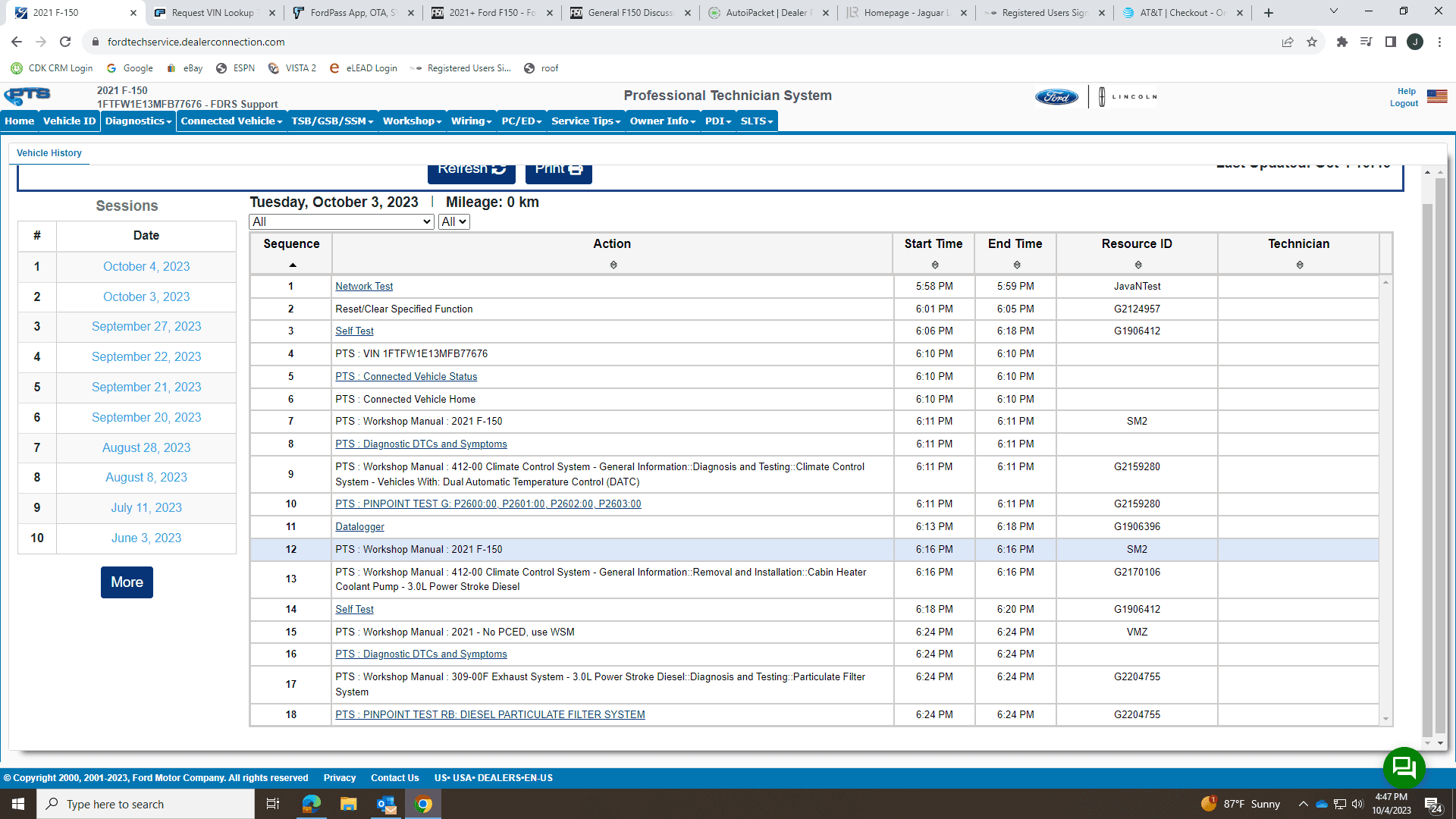

Could you please look at the PTS history and see if the dealership has accomplished anything on my truck? Been two weeks with almost zero info from the advisor.

They were working on it yesterday. The screenshot below shows what they worked on:
Ford F-150 Request VIN Lookup Thread 1696452461855
I'm not a tech, so I am not sure what they were doing or trying to accomplish just from looking at this, but they did work on it. This morning, they pulled up your VIN in PTS, but that's about it.

Appreciate it! I know they had to replace a failed diesel particulate filter already at 35,000 miles but the other stuff is odd. It looks like they have not tried fixing the failed OTA update yet or verified that I already applied the trailer relay module update and already activated bluecruise on my dime.

You had the latest APIM update go through on 9/19, but the IPC update has failed many times as it did on my truck. The only time I have been able to get my IPC to update has been with FDRS. Jesse thinks there are truck out there with a faulty ethernet connection that prevents them from getting IPC updates via the OTA process and I am confident my truck is one of those. Looks like yours might be, too.
Do you remember if your truck ever got the old IPC updates (2.7.3 and 2.7.4) via OTA?

When I did the updates for bluecruise, the ipc update over USB failed multiple times and I had to wait for the slow 5 hour alternate option to finish. I only had to do this once that I remember but the latest ipc ota update also refuses to install which I'm hoping Ford will look into and possibly replace some parts.

Ok, same as me. Chances are, the only way you will get the IPC update that has failed OTA 5 times on your truck will be the slow way via FDRS just like last time.

I have told the service advisor that multiple updates to this module have failed and require a CAN bus connection to proceed with the update instead of the OTA or USB simple method. Hopefully they look into it a little further. The main reason this truck is sitting at Ford is the fact that the diesel emission system was self destructing and it looks like they are replacing parts on it. I also had a pile of recalls on it including the axles which are both getting replaced on the rear end.
