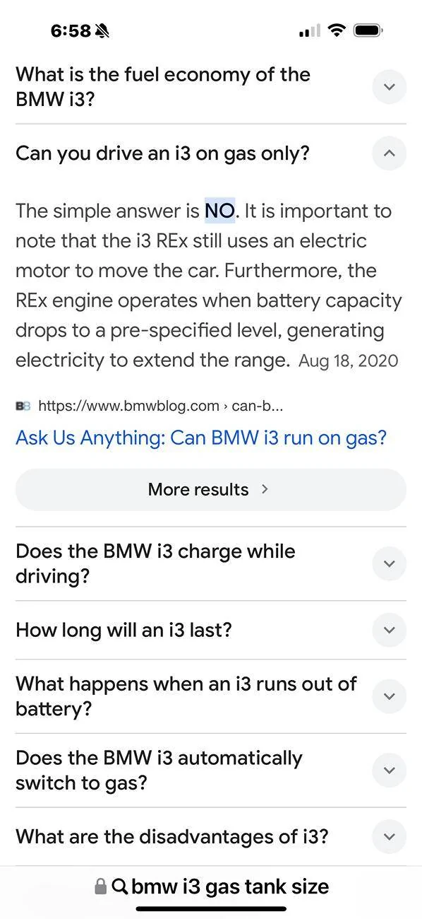

I think the BMW i3 had a version of EREV.
It did apparently! Unfortunately it’s tiny ICE and gas tank don’t directly correlate to the Ramcharger approach.
