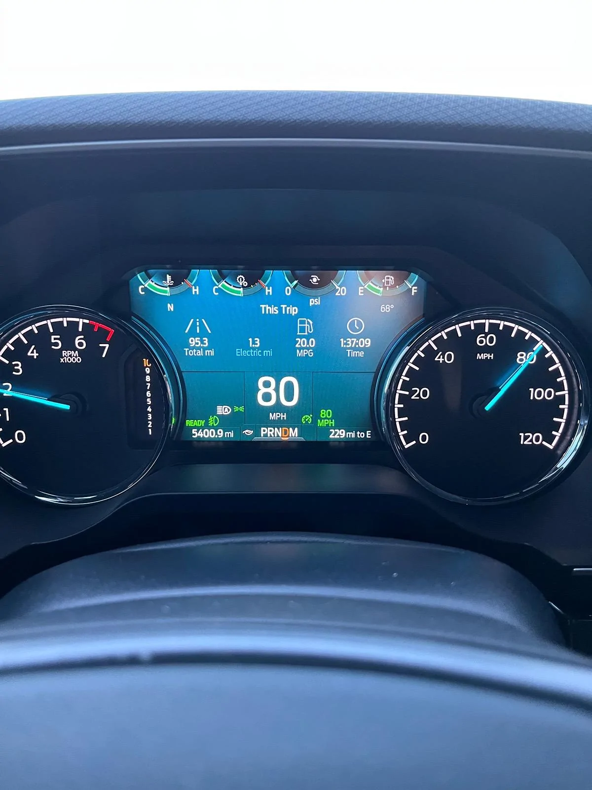

I'm sure it's already been said but the Powerboost is not a highway vehicle for getting good MPG. Not at 75+. It will drive it and it do it with plenty of power but you will never get the rated MPG. It needs to be driven like an old man 65-67 max. Even then it will only be just over 20. With mixed driving and a stock truck I have no problem getting 23-23.5 regularly. In the winter chop 1.5mpg off of that.
The Ram rental that the OP drove had to have been a Pentastar V6. Or a 2wd with 3.21s. Rams inhale fuel (I owed a 2013 hemi and a 2021 etorq hemi). 16-17mpg was the best I could muster.
I just did ~200 miles this morning at 80mph. And admittedly, the Powerboost is basically an Ecoboost at that pace. 20mpg for me too.
