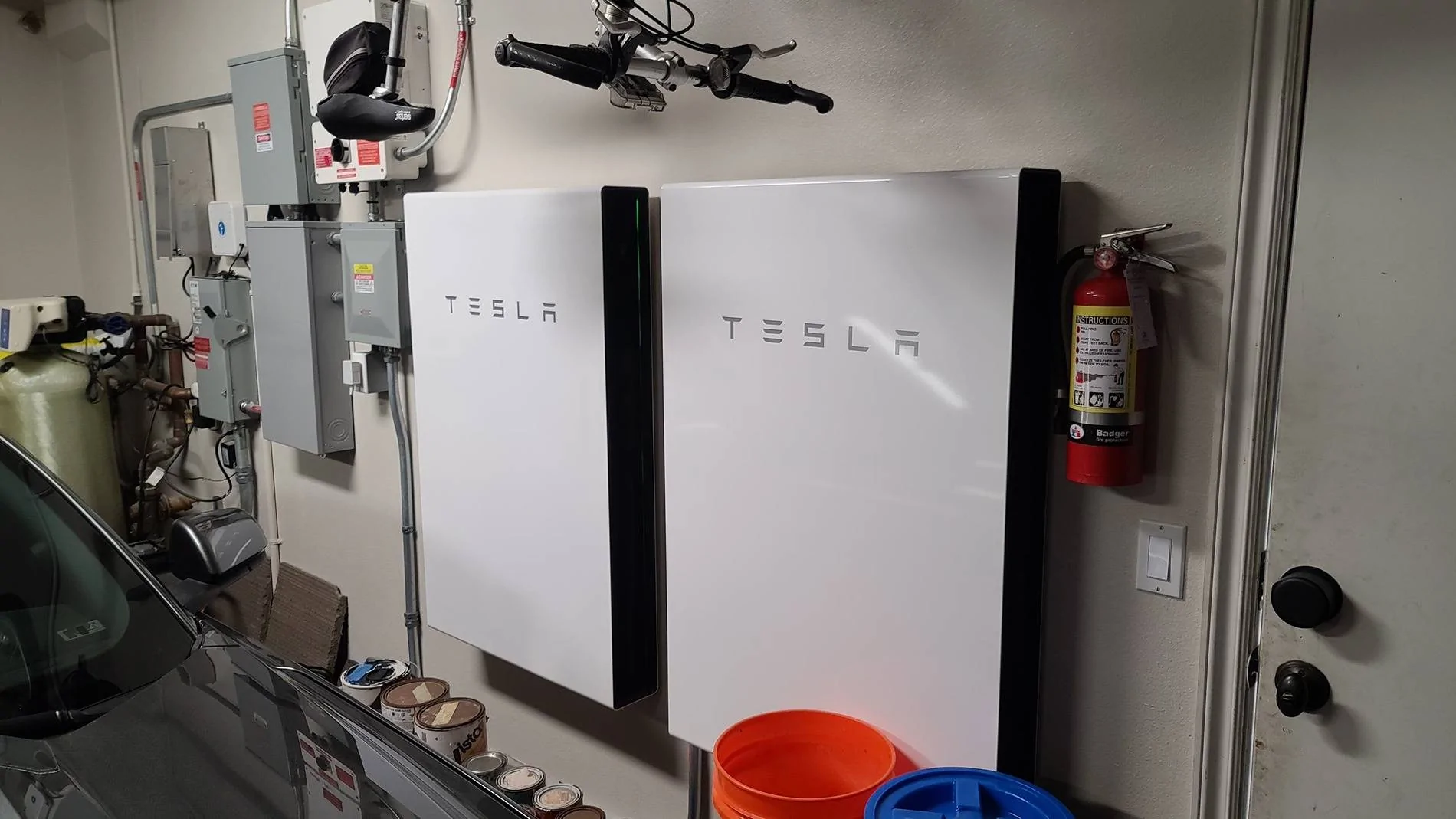

The better question is why are you installing electrical devices in a home where submersion is likely -- move them to higher ground (really goes for the home in general -- living in a floodplain is a question of when, not if)
