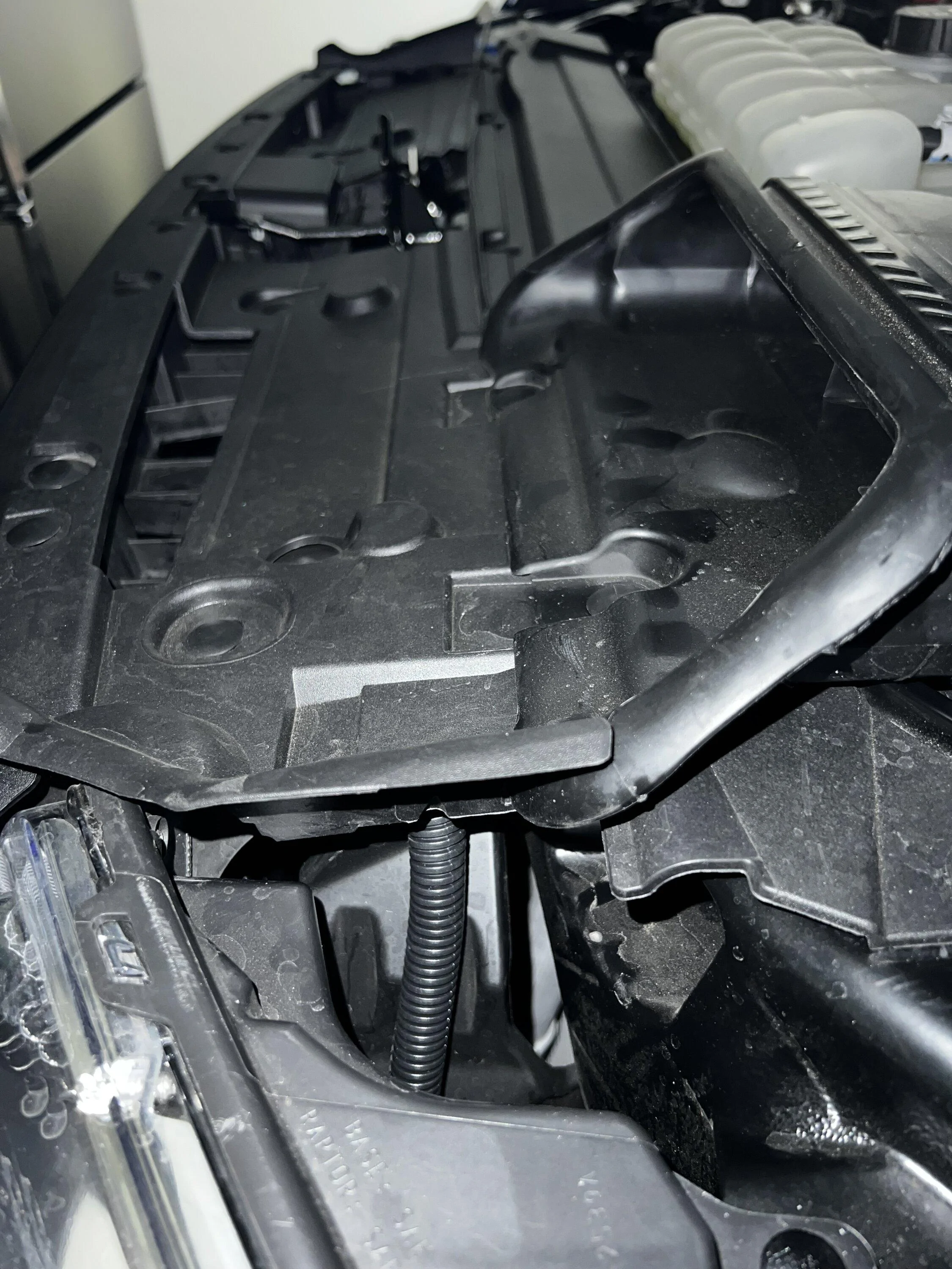

I used this to connect to the battery.
https://smile.amazon.com/NOCO-GC002...o&qid=1671572804&sprefix=noco,aps,225&sr=8-20
And I used this to extend the charger cable to the driver's side tow hook.
https://smile.amazon.com/dp/B004LWV0GQ?psc=1&ref=ppx_yo2ov_dt_b_product_details
The charger is mounted on a wall in front of my truck for easy access and I ran the charger cable from the battery underneath the plastic radiator cover and fished it down to the backside of the tow hook. I used some wire loom to protect the charger wire where it goes down to the tow hook but still need to put some loom on the battery side to clean it up.
