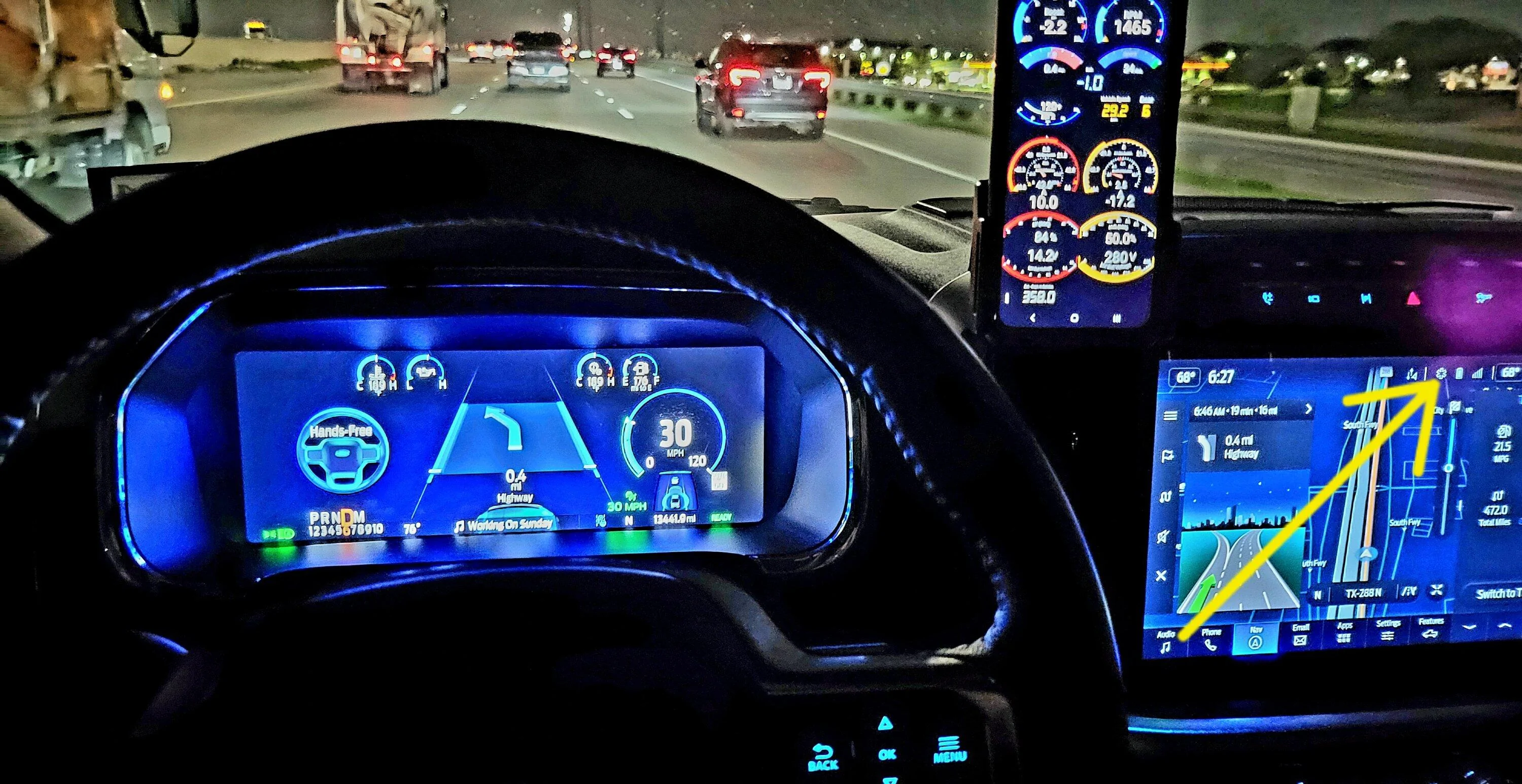

I'm OK with the 3rd screen in the truck. Just required dedication to placing it in near line-if-site so I don't have to trigger that Bluecruise eyescanning nanny.

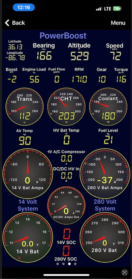

Apparently, I spoke too soon about the mapping of PIDs when importing a dashboard.
Earlier when I tried, ones that didn't map defaulted to "Speed," but I finally remembered to connect the app with @turbopilot 's dashboard... the labels are right, but I am not getting any values for some of them:

Weird looks like you are not getting some of the PID's from the BCM and BECM. Are set up as PB 2021 or a PB 2022?
That's the thing... If I set it up as a 2021 (which it is), the dashboards didn't import right (lots of Speed panels replacing the ones that were supposed to be there). But, I said mine was a 2022 and they all imported correctly, but now the PIDs aren't getting picked up.
I am going to look at your previous post where you listed all the PIDs and see if something is amiss after my import... or if I switch mine to a 2021 now that I've imported the dashboard, the planets will align and it'll just work. :)
I have had glitches I could not fix. Just delete the app and start over.
Yeah… I’ve imported so many dashboards that it thinks I have a 2021 Powerboost, a 2022 truck and a 2016 Mazda!
I think you’re right… time to “nuke and pave “!

I also had issues importing for my 2021. Nuke and reload didn't seem to help. However, editing by holding down over any "Speed" displayed items to manually change the PIDs worked fine. The original post was very helpful in pointing out exactly which ones they need to be switched to.
