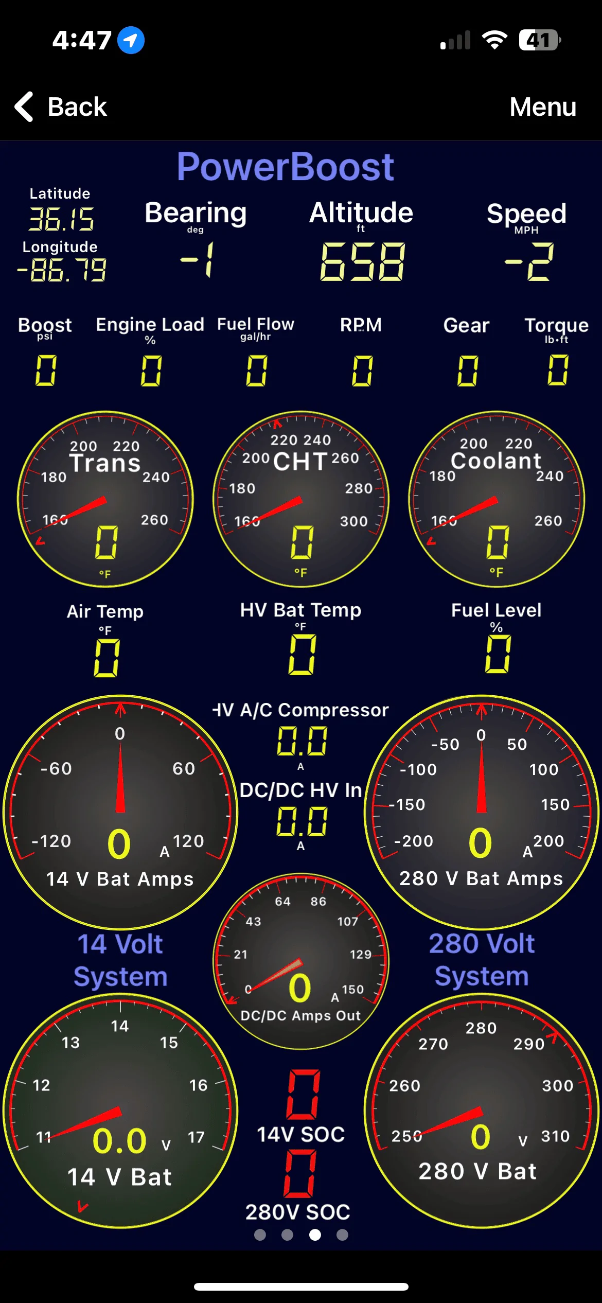

You can change the scale of every gauge. So theoretically you can populate the device you are using with the same layout.

No doubt some reformatting will be needed to fit all the screen sizes. That is pretty easy to do. My hope is that other folks will post .stg files reformatting what I have done to fit other devices.

It looks just fine on my "little" iPhone 14 (not pro or pro max).
I just removed the version number at the top of the screen...

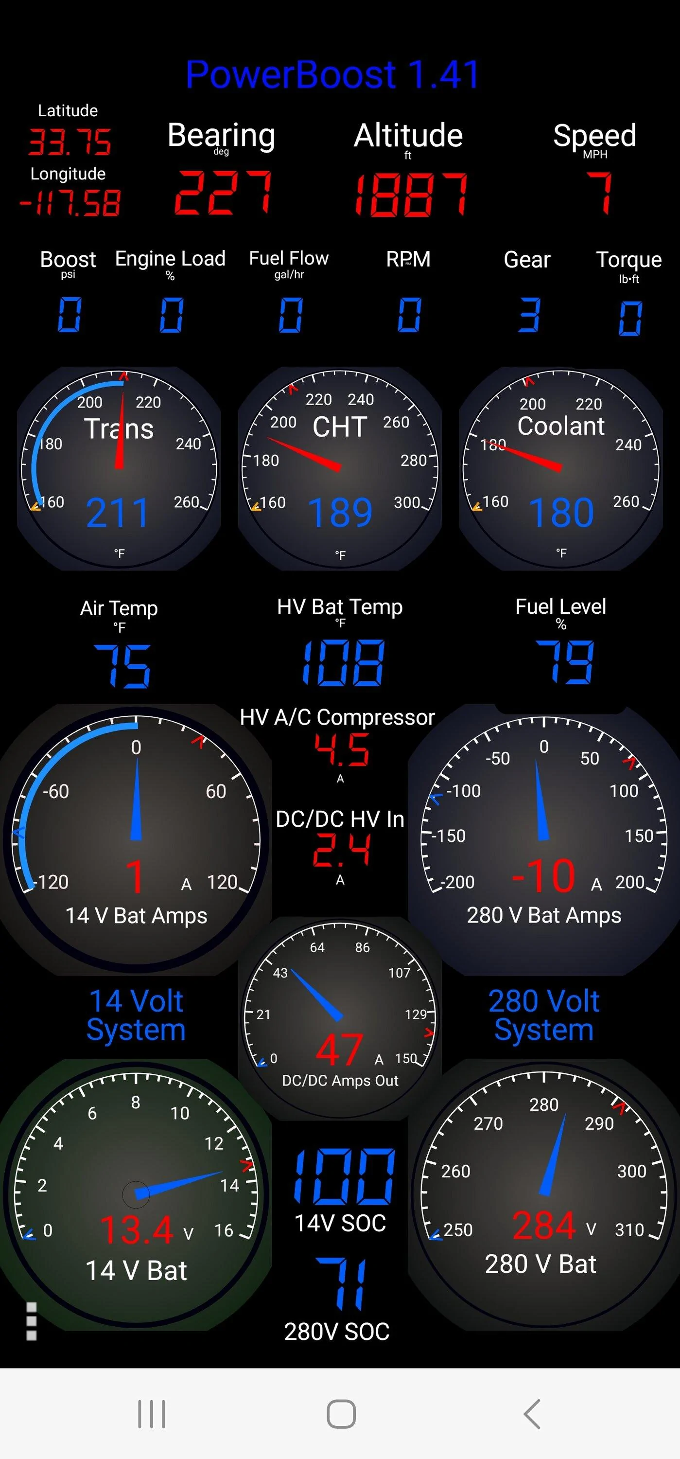

Last night 9/3 6:08 PM 14VDC SOC 96% and 280VDC SOC 69%.
In morning 9/4 9:29 AM got FordPass Remote Features Disabled To Preserve Battery Message.
Started Truck 9/4 9:35 AM 14VDC SOC 93% and 280VDC 51%.
Screen shots attached, please refraim from comment on the "Spiderman Theme" ;)
1) Is that much loss in each SOC over that short period to be expected?
2) Do these batteries dissipate SOC linearly?
3) Any thoughts to win at these rates of phantom discharge I get the cannot start message?
I am trying to learn this trucks training :)
BTW, ended off-roading today at 100% on the low voltage batteries.
And thanks for the template gents.
Ford F-150 PowerBoost 1.5 - We Need More Than Idiot Lights Screenshot_20230903_180837
Ford F-150 PowerBoost 1.5 - We Need More Than Idiot Lights Screenshot_20230904_160238_FordPass
Ford F-150 PowerBoost 1.5 - We Need More Than Idiot Lights Screenshot_20230904_093531
Odd that your HV SOC was 69% when you parked the truck, unless you ended your drive with a nice downhill regen that Ford does allow to take SOC above 63%. (Ford HV charging via ICE normally is capped far below 69%)
Regardless though, I have had on a few occasions witnessed a considerable drop in HV SOC that I couldn't explain. A small change makes perfect sense if the HV battery temperature was to swing dramatically overnight, but not 18%.
The only explanation I could imagine is for the DC/DC converter being in play for some reason? And if that's true, it's nothing more than the HV battery being consumed to support a 12V system draw.
Still, even with all that being said, the truck has no obvious reason to disable features (FordPass alert) to protect a 12V battery at such a high SOC.
I'd chalk it up to one of those mysterious, and hopefully rare/random software anomalies. If not, you are surely going to experience additional events that might eventually reveal some hint to what's not shutting down properly.

Thanks @Snakebitten , I'll keep watchin' 'em. Yes, I have a pretty good down hill at the end of my commute .
If you thought 63% is high, here's a 71% capture I meant to forward you for thought. I got it out on the trail today. Maybe one of these off-road modes enabled the high SOC?
