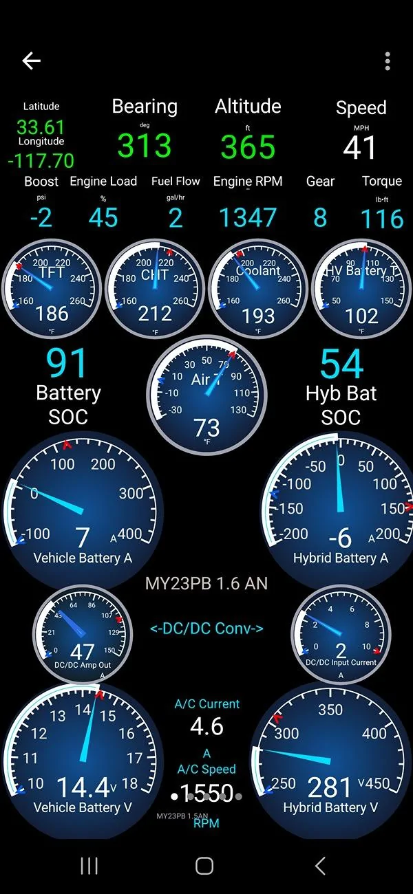

Yes, regen is allowed to push the SOC beyond 63%
I live on flatland, but I think I've read that once the SOC hits that ~71% limit, regen is disabled and you can feel the loss of resistance going downhill.
