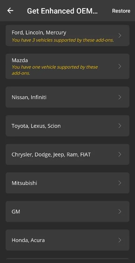

I just looked:
Ford F-150 PowerBoost 1.5 - We Need More Than Idiot Lights Screenshot_20240906_205551
I got the Ford for Free with the MX+
(I purchased the Mazda a couple of years ago afterwards)

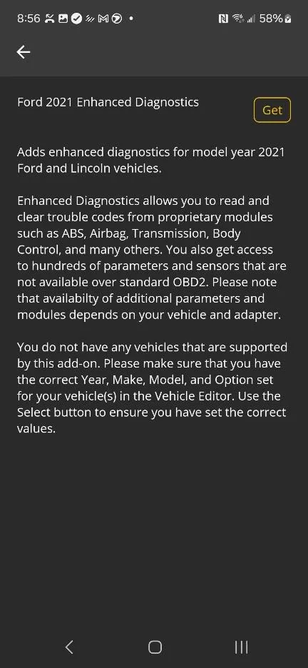

So I looked and I had both 2022 & 2023. So I clicked 2021 and got this screen
Ford F-150 PowerBoost 1.5 - We Need More Than Idiot Lights Screenshot_20240906_205619

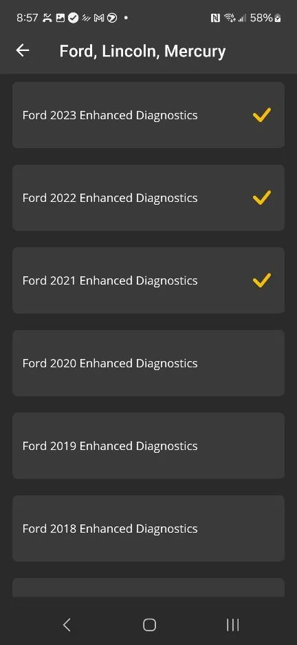

Clicked "Get" and...
Ford F-150 PowerBoost 1.5 - We Need More Than Idiot Lights Screenshot_20240906_205713
So at least on Android you can get multiple years for a single purchase of a make.

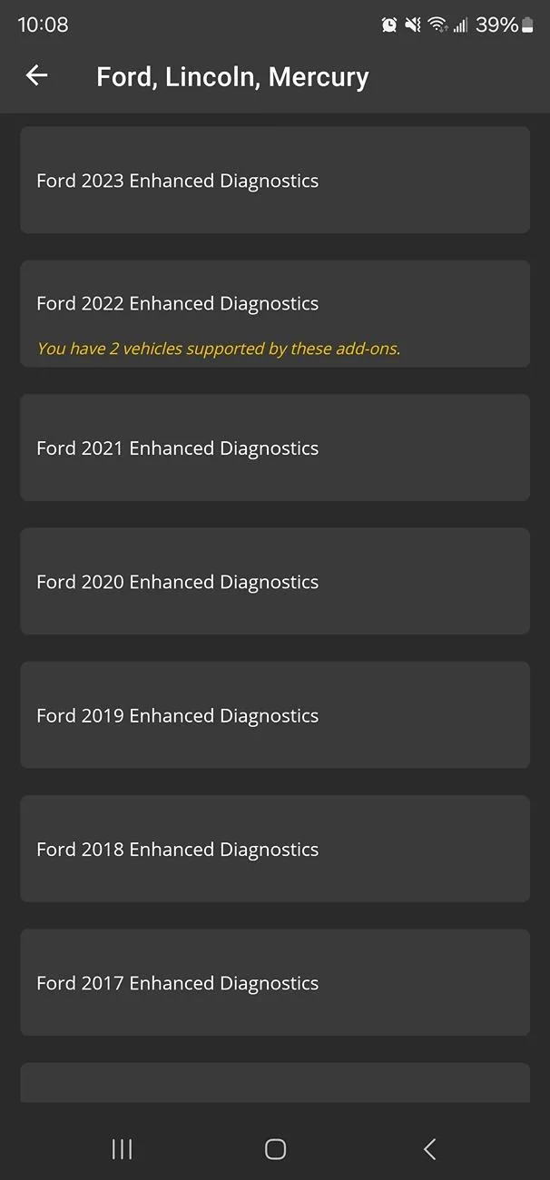

Android here too with MX+ and I seem to be able to get different year f150s for no cost. I've already done 2021 and 2022 (a couple of times, apparently) with no issues. Weird, wonder if it's an apple thing?

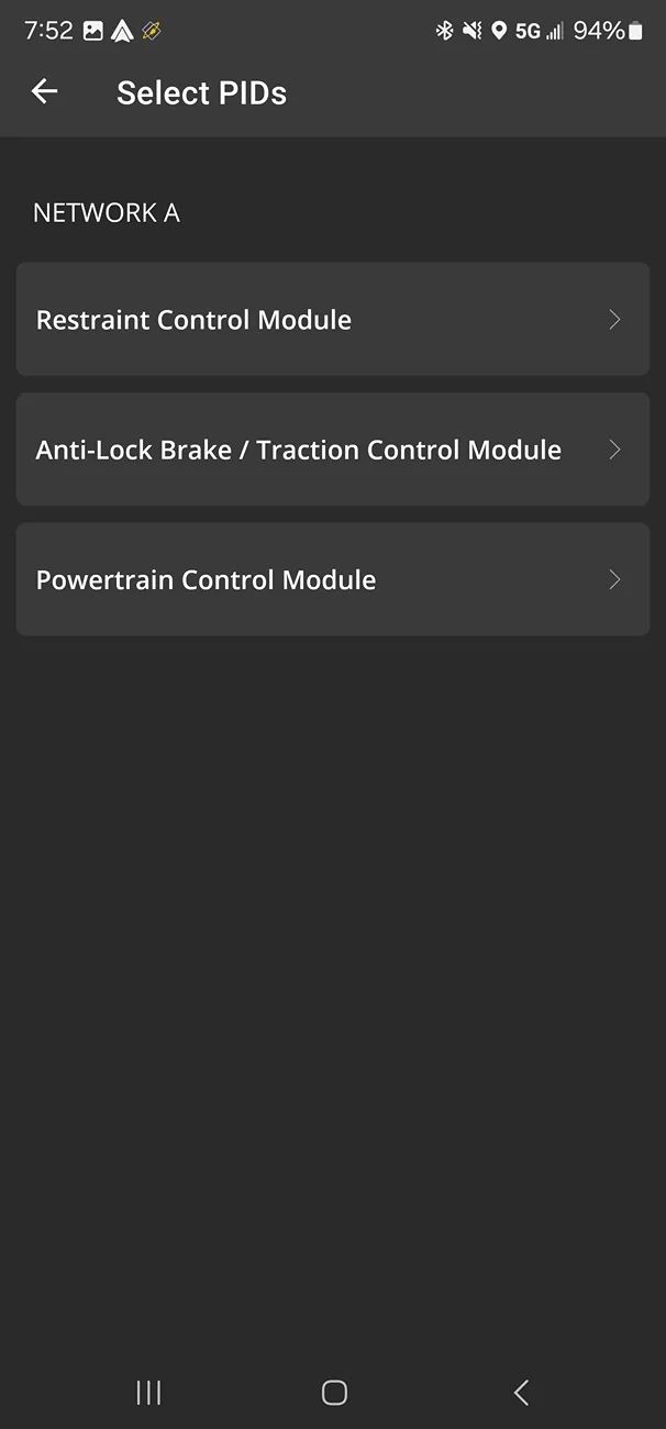

I still cannot get this working after several reinstalls. I feel like I'm going backwards though - I used to have all modules show up when going into the edit display configuration for a gauge... Now for the last couple installs I only get a small handful of them whether I'm connected to the vehicle or not. Also it seems to be keeping some settings despite uninstalling and reinstalling... Does anyone know how to wipe everything and all related saved data?

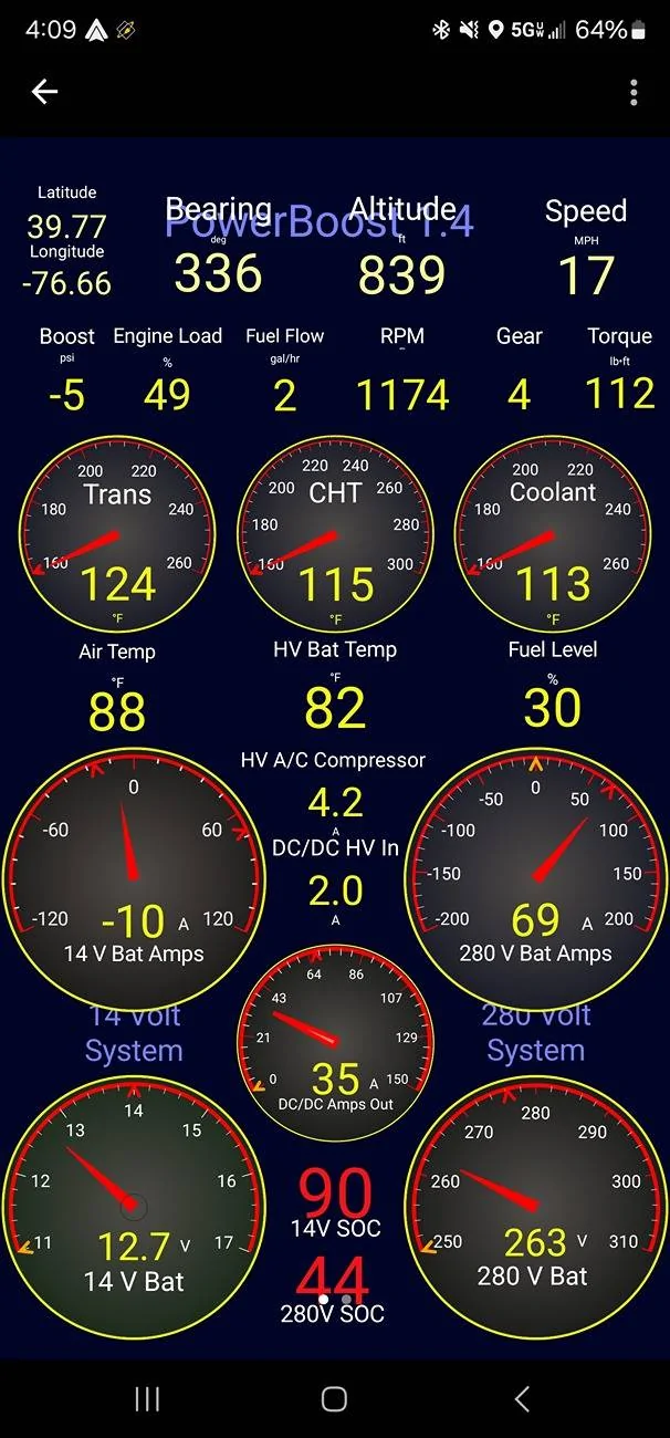

Hey @Snakebitten how did you make this positive/negative amps gauge with green/red on it? I'm trying to make a dashboard specifically for the hybrid battery monitoring and I like how you have this one configured. I don't know how to make it 2 tone like that though.
Ford F-150 PowerBoost 1.5 - We Need More Than Idiot Lights 1000006561
Old version of my dashboard.
But in the Style tool, I think it's all about the "Range" properties. And I think you would have more than 1 range if you want more than one set of range properties.
Just create a practice dashboard
Add a radial gauge.
Go play around in the Style tools.
Warning, it can be addictive. For those who caught the disease, some are now exposed on these threads. Lol
