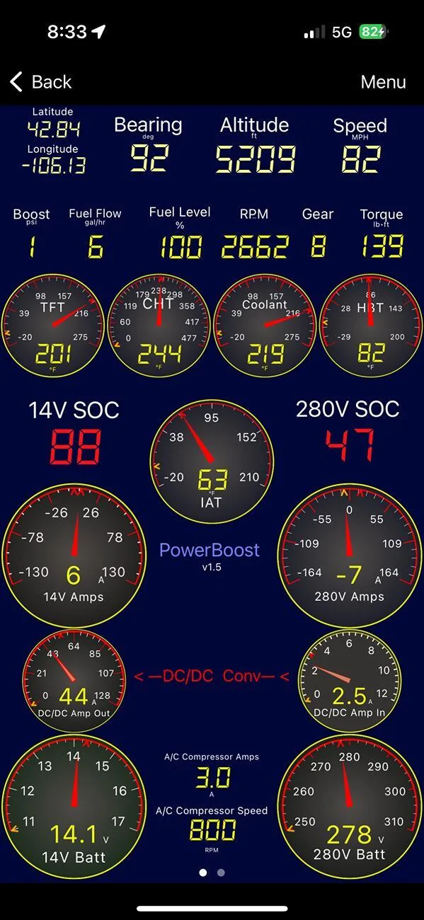

Okay I think I got it working except the “gear” one. Had to remap each PID individually, but I set it up as a 2023, and used the 2023 library, and was able to find all of them. Can anyone point me in the right direction for gear?
Ford F-150 PowerBoost 1.5 - We Need More Than Idiot Lights IMG_9623
Edit: Looks like I have a few names to clean up, also.

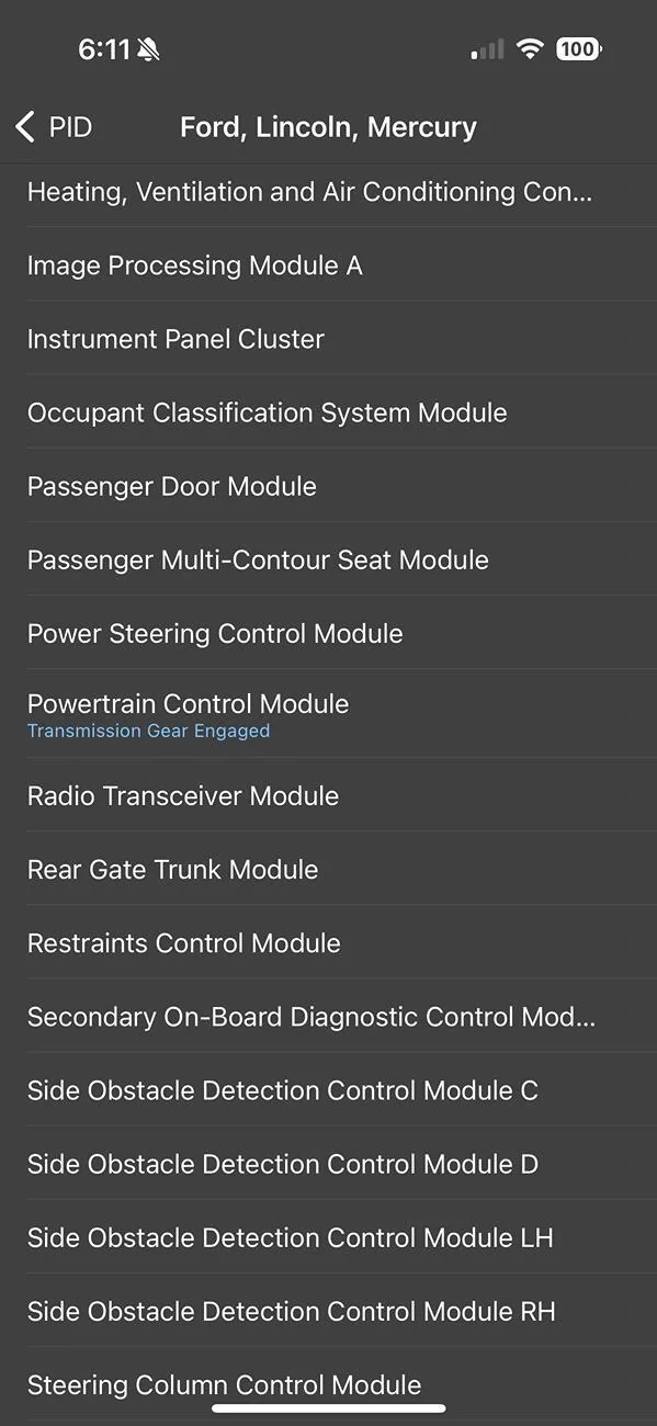

Look for something similar to
This is Android version of OBDlink app, and it was recently revamped with new library and names for many PIDs.
Hmmm, that’s the one I have, too. I didn’t actually get out and drive it when I tested it, just not sure where I picked up a 70-speed transmission ?
The digging continues! Thank you!
It's true that the PID mysteriously shows "70" when in Park.
But for me it correctly displays which gear the transmission is in when not in Park.
You are exactly right. It works fine when not in park! Looks like they are all functioning now! Thanks guys!
I get "70" when in park, "128" in reverse if I recall correctly, same on MY2017 Mustang, but gear appears consistent with IPC on MY23 F150.
P, R and N are not displayed as numbers but probably Hex (I haven't check against the math).

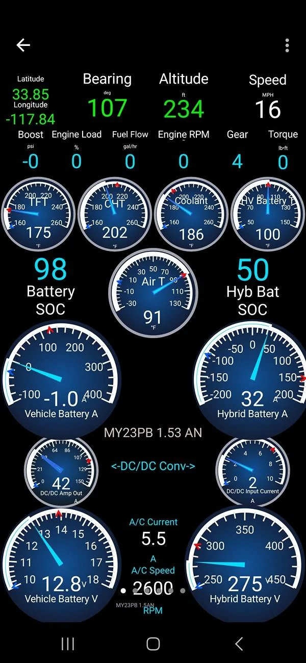

Correct. 2023 settings, but you have to map each PID individually. For some reason none of them worked with the import.
I exported the dashboard and saved it but can’t figure out how to get it share here. I’ll update this if I figure it out.
Renamed my MY23 PID based dashboard attached. Download and change to .stg from .txt if you like my layout for Android.

Took the family up the mountain today, and on the way down, I noticed the hybrid battery seems to top out at 71% SOC on my 2024. I think this is consistent with others, but I know the 35-65% is typical operating range.
Ford F-150 PowerBoost 1.5 - We Need More Than Idiot Lights IMG_9705
