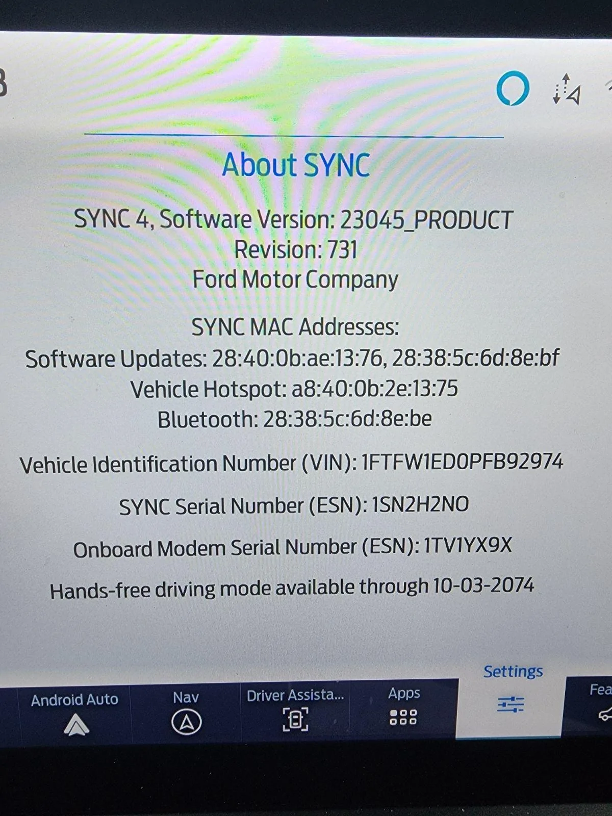

My buddy called. He has a 2023 hybrid f150. 12k miles. No updates he remembers seeing.
Has issues with Bluetooth dropping. Here is a screen shot of his truck. I don't know what version a 2023 is supposed to be.
He's thinking a SYNC update will fix his Bluetooth issue.
Can someone please look at the Vin?

My bad. I should have made the Vin "cut and paste" I will do that in the Vin lookup thread. In meantime what should the sync be?
