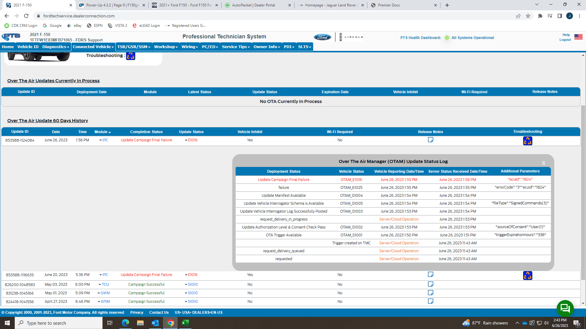

So 4.3.2 got sent to me again earlier today. I had no idea it was in my queue. I started my truck to go to lunch, and it couldn't download the files and failed again with the exact same pattern it failed with 6 days ago.
I just got a notice that mine failed for the second time.

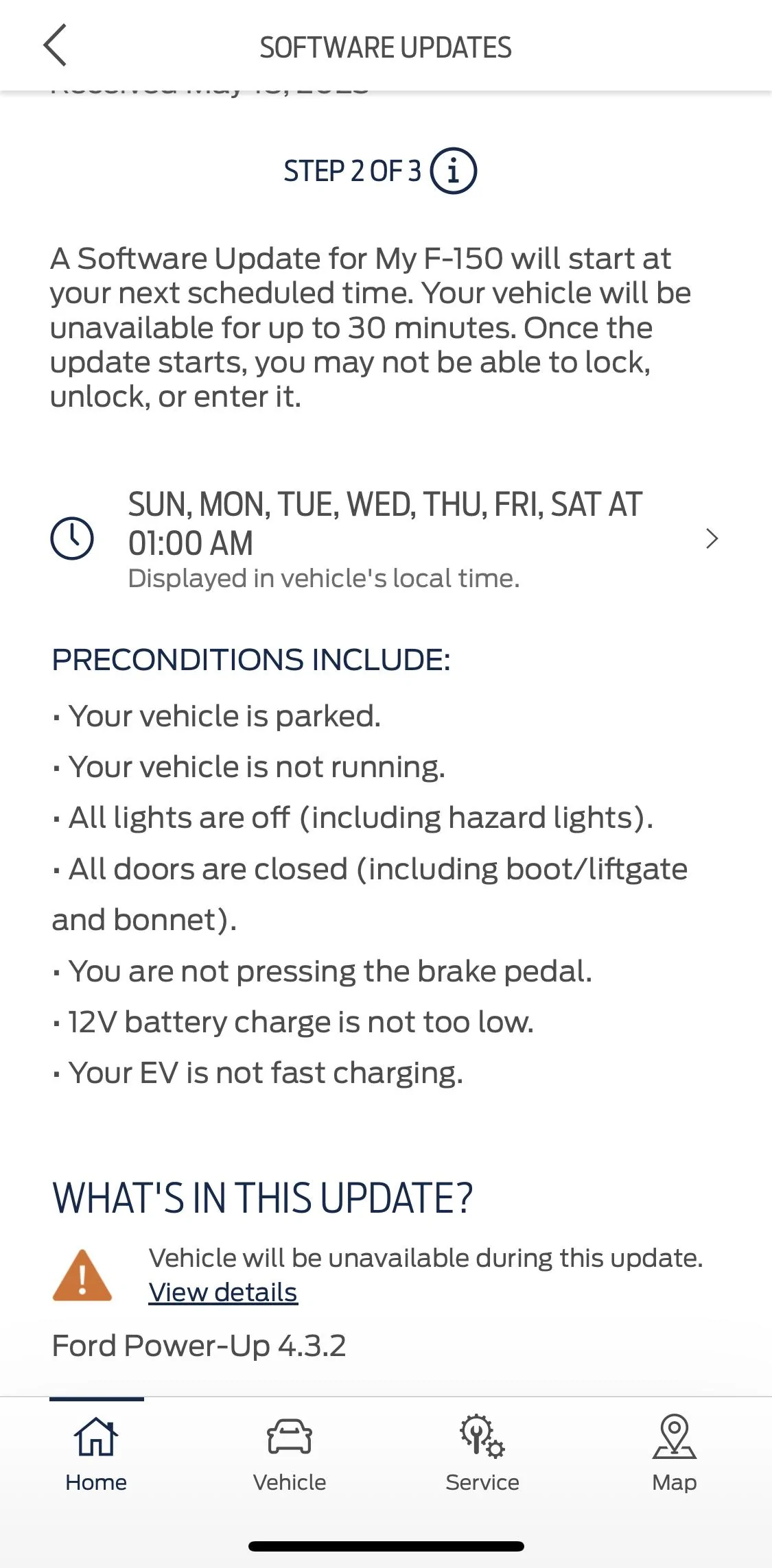

My truck says no update is available,
however fordpass says it’s is on step 2 (software update will start at next scheduled time) for 4.3.2. It’s been like that for 2 weeks. The car is with the dealer for various warranty items and they want me to wait another month to see if it goes thru.
It’s currently set to update any day of the week at 1AM, but never does. What’s the deal?
The truck will always say it is up to date if there is no OTA in your queue. Regardless of whether it is up to date or not. It could be that the update failed to install and the app still hasn't synced with the truck to reflect the failed update. I would need your VIN to check the details.
Its at step S1007 as of may 18th.
