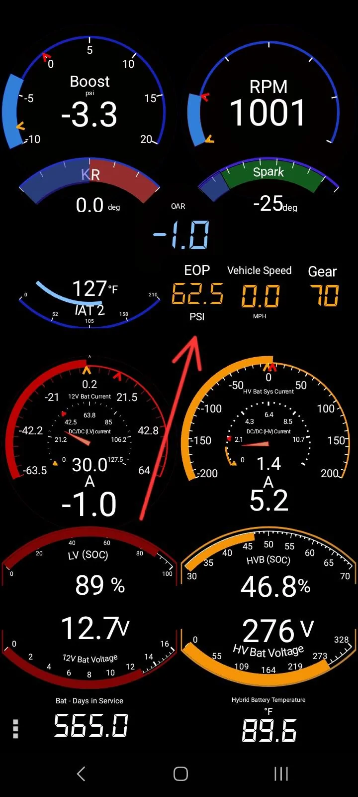

I haven't updated the file to include the added PIDs from this thread, but a few are available here. We don't have all of them available from OBDLink, but enough to be useful.
The only "user defined" PIDs that I use are for OAR and EOP.
Octane Adjust Ratio
Engine Oil Pressure
All other PIDs were included in the OBDlink Enhanced Ford/Lincoln/Mercury library.
Chili
Aug 18, 2022
625
476
Mn
2022 F150
Exactly how HPTuners reports, when the Powerboost immediately lights ICE, it has the variable oil pressure pump set at stage #2 (high pressure)
After a few seconds at idle, it drops to stage #1 pressure
So nice to finally have that PID on a smartphone app. I still can't believe you just harvested that PID so casually. ??

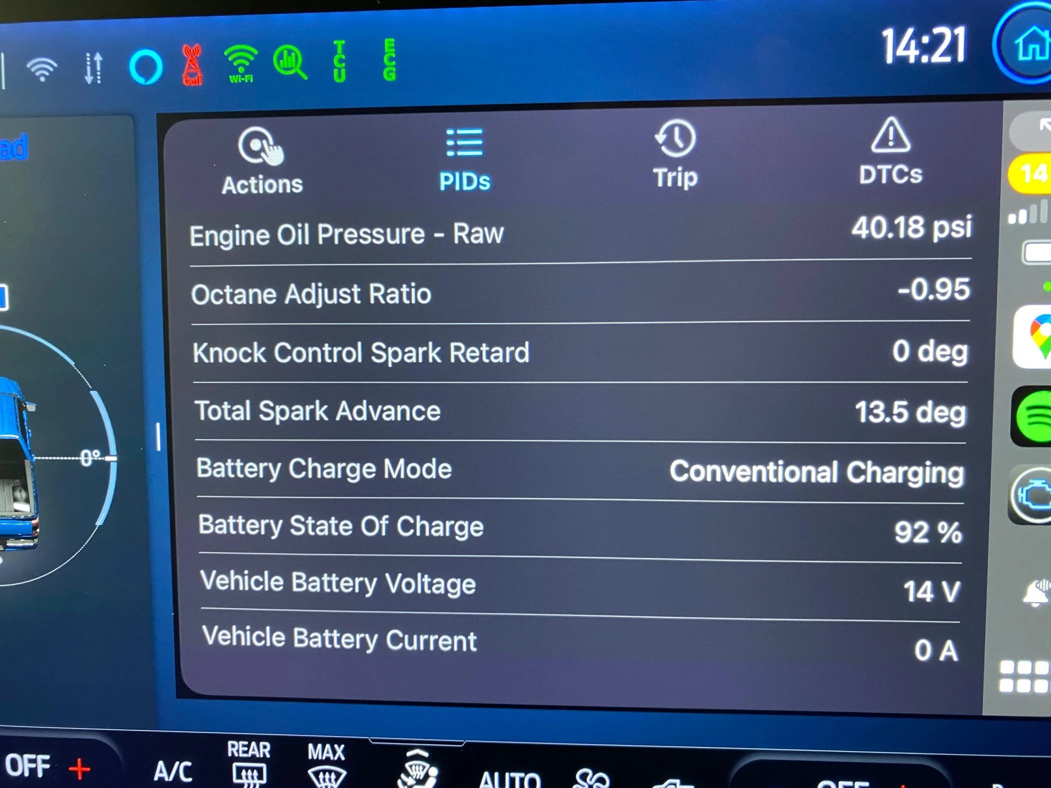

Question was asked earlier regarding CarPlay... unless OBDLink is a knobbled version of OBD Fusion, it should be there in Settings>Preferences>CarPlay. Configure screens and bob's your mother's brother.
I actually like them listed like this instead of gauges (I'm weird that way) and the list is large enough on the 12" screen ?
EDIT: @fordtruckman2003, I found a previous better photo:
I actually like them listed like this instead of gauges (I'm weird that way) and the list is large enough on the 12" screen ? View attachment 118080
Wait a minute, screen shot is from Carplay? iOS or Android device?
