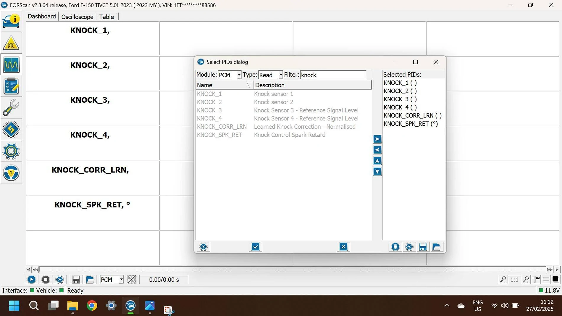

I've gone through the PCM PID's line by line and can't find anything. nothing with "knock" shows up when i search either
This is what forscan shows for me:
Ford F-150 Forscan PIDs? (Livernois tune) Screenshot 2025-02-27 111300
Ford F-150 Forscan PIDs? (Livernois tune) Screenshot 2025-02-27 111410

Thanks for checking. I definitely don't have any of those on mine. I went through the PCM id's line-by-line on both Forscan and Forscan lite.
There are PID's that do the same thing that I can access from the livernois tuner itself and log with, but they have different names. Instead of Knock_1/2 they're called KnkSen1/2_Cnts and knock_corr_lrn is called Lrnd_Knk_Mod for example. This is what makes me think the tune must be the culprit.
