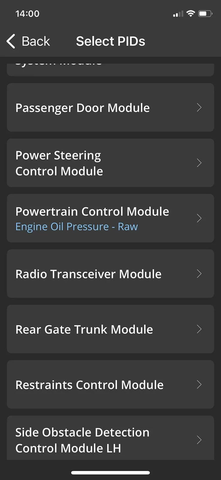

@Snakebitten Bruce, thanks for the OAR formula (obtained by my usual lurking?), so to hopefully return the favour, and because I haven't seen anyone mention it yet, what follows is Oil pressure in psi.
If it doesn't exist in your Ford PID set, it may be because I bought the 2023 set when I bought OBD Fusion (the "OBDLink" app is OBD Fusion, at least on iOS):
Create gauge with that and the user defined PID above and see if they match up. ?

Android here and that PID doesn't exist in the 2021 Ford set from OBDLink.
They should show identical data, but now I'm curious since they added a PID for it.

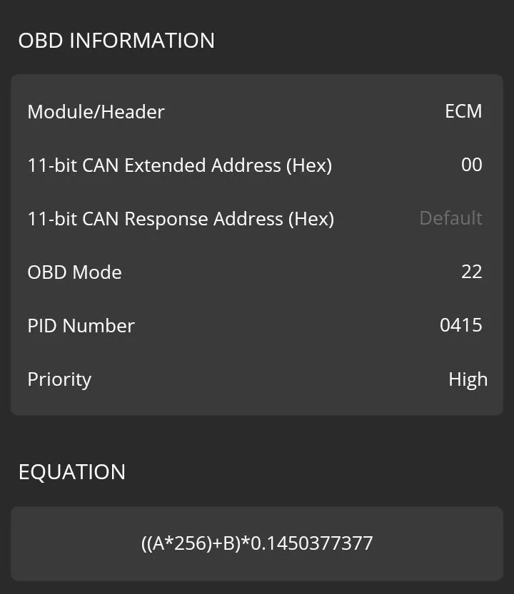

Oil pressure for the Powerboost/3.5 Ecoboost
(Android OBDlink, you have to build it. And I fine gent here on the forum sniffed it out for me using Forscan. I'm forever grateful)
Ford F-150 OBD Fusion PIDs Screenshot_20240624_215123
OBDlink did get a big update. Almost a complete re-write. But still no native Oil Pressure PID for the Powerboost/3.5 Ecoboost.

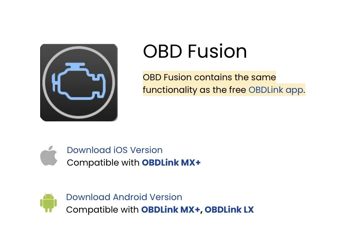

From the OBDLink web site:
https://www.obdlink.com/mxp/apps/ - this page doesn't even list OBDLink as a compatible app for the MX+ ?
Ford F-150 OBD Fusion PIDs IMG_4704
and
https://www.obdlink.com/compatible-apps/ - makes me think that both apps are TouchScan descendants
Ford F-150 OBD Fusion PIDs IMG_4703
I had to buy OBD Fusion as I'm using a Veepeak BT+ instead of an MX+.
