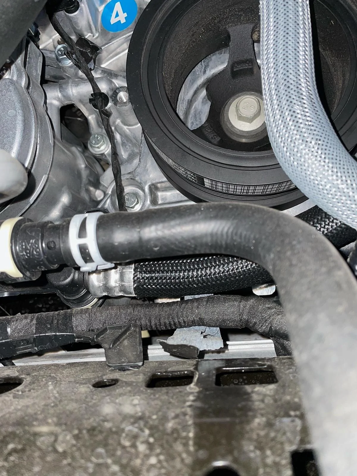

Since the '24's no longer have the belt starter, I wonder how long until Ford determines that the conventional starter is unnecessary?
psst. You didn't get this from me, but there's a leaked picture of next year's model:
Ford F-150 PB using traditional starter more and more... Untitled 3
