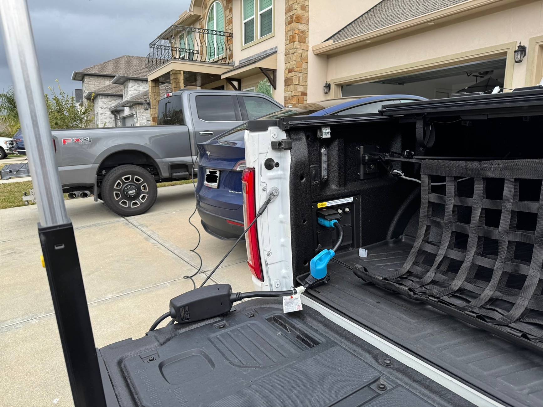

Cool- do you have a link to that blue adapter you’re using?

Taking 3 1/2 hours to charge 11 percent. It would be faster to tow it to a charger
Great idea in concept though
i think that Tesla slows down charging after 80%??
I charge the Mach-E at about 6.6 KW at night. (28A/240V)
My Powerboost can match that, of course. Just need the appropriate 240V adapter.

You need an adapter that will be 240v, that plug is only 120v. Look at your generator screen, it's only using one of the inverters.

Plug the first adapter listed into your truck. Then plug the second adapter listed into the first adapter.
still will only give you 30 amps total. You will not be able o charge each car at 30amps. You would need to set your charger to 15amps. Best to just charge one car in a pinch.
