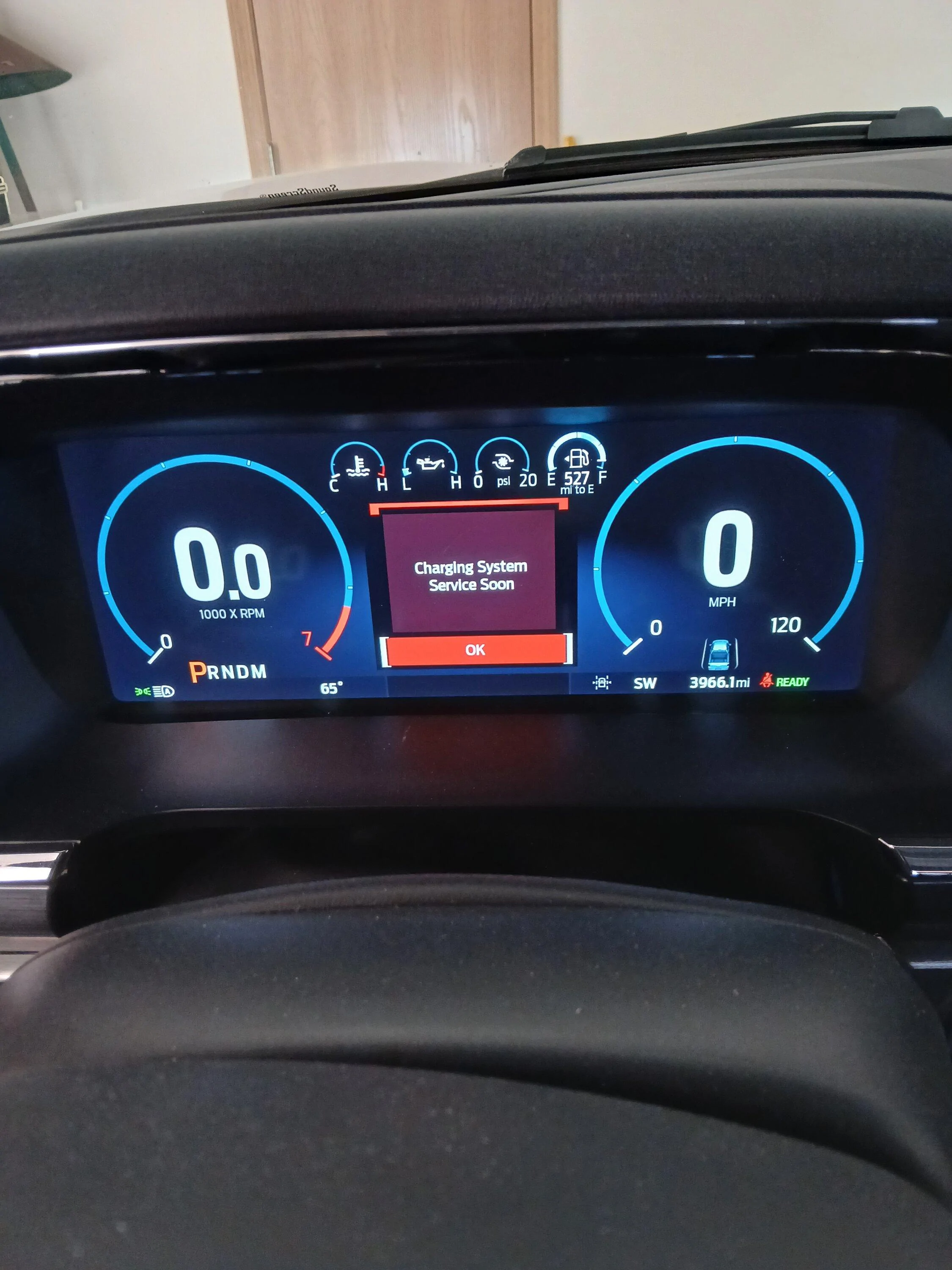

Just got back from 100 mile round trip and still getting this at each start up.
Been going on for a few weeks. Showed up just after an OTA.
What do you think?
Ford F-150 Charging System Service Soon. 20240313_101016

Fixed?
Recharged the batt until the smart charger put it in float. Around 3 hrs. Same as ever but this time, charged it straight to the terminals, rather than the ground being on the BMS, as is recommended.
Then reset the BMS with the 5 light flash, 3 brake push method. Battery indicator blinks 3 times.
Started it up. No check charging system warning.
Took it for a short drive and once back home. Started it again. No warning.
Thanks @UGADawg96 for mentioning this several times, as a potential fix.
Fingers crossed.
