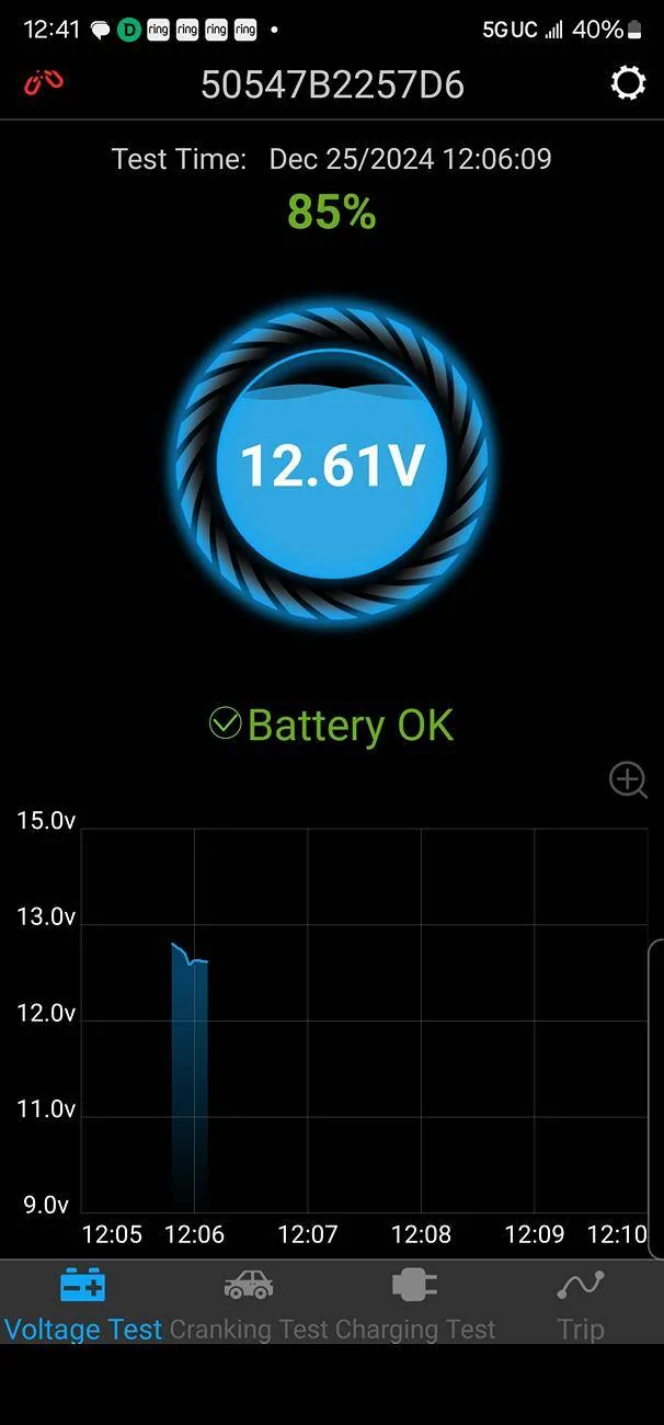

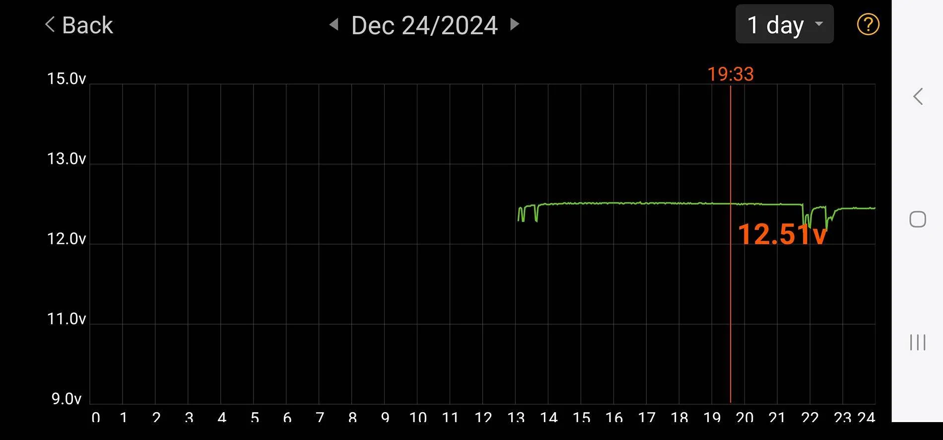

Take a look at this. I have two screen shots. One was yesterday and then today.
Yesterday I disconnected the main battery. That showes up as the far left squigglys. Just the aux was still connected. After about an hour I reconnect the main. Notice that the voltage remained flat over night
With exception to the two drops when I opened the door then the power lift gate.
The next shot was this morning. It continues at the same voltage. I opened the door and the interior lights came on. I went inside and remote started the truck.. first time in three weeks. In today's shot I drove truck, stopped and opened door, opened power tailgate. That's shown in the chart.
3 hours later sitting it sat at 12.58v.
I drove home and now after 1 hour it holding at 12.61v
