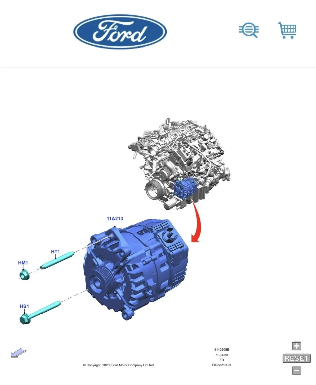

Yea, Ford calls what we always considered an alternator, a "starter generator". And they are right because it IS a generator and a starter in one! (I hate to think what that thing might cost out of warranty) And it is NOT an alternator because we don't need one. Which is fascinating as well.
Oddly enough, we still have a traditional starter, but according to Ford there is only one circumstance out of the listed 4 engine starting circumstances, that the traditional starter/flywheel combo is used. Basically it is for remote start.
I'm still not sure why that couldn't be done with the belt driven starter-generator, but I'm sure there's a good reason that I'm just missing.
So the Hybrid has a flywheel ring gear starter motor, a flywheel traction motor in front of the transmission and it has a belt starter?
This brought to you by the Department of Redundancy Department.
p.s. where can I find those parts schematics? : )

It looks to be pretty well buried in the engine compartment too, so who knows what the labor cost is. Maybe just enough to wipe out all your savings on fuel!
Where'd you get those schematics and prices … I'm curious to see what the battery costs as a part.
Thanks,
Parts.Ford.Com
You can search with or without a VIN and it looks like they're still slowly working on 2021 parts/descriptions.
There's also this site too:
https://www.etis.ford.com/vehicleRegSelector.do
I believe the graphic in post #16 is from a shop manual.
