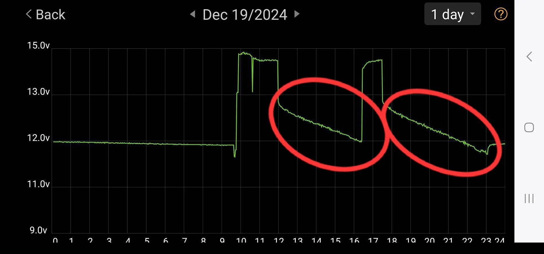

My 2022 Powerboost parked undisturbed yesterday. It didn't bleed but maybe 2/100th of a resting volt
Credit @HammaMan for the lab work that led to this stability

I removed the agm aux at 1pm. In 5 hours I lost this. Next is to disconnect the audio system. I don't think that's the issue because my voltage draw down would keep going down. Unless the truck is shedding that current
Ford F-150 Charging rates Screenshot_20241223-175142
Is the arrow the point of truck being turned off?

I have looked at many hundreds of those voltmeter log files and that linear voltage drop spanning 4-5 hours is remarkable. I've not seen anything like it before.

If it were a parasitic draw how, what kind of amps woukd draw that amount?
I don't know, but it's beyond normal resting draw on these trucks. And it's so consistent and linear. Yet stops suddenly as the voltage reaches ~11.8
I think that's about where Ford puts the truck into deep sleep?
