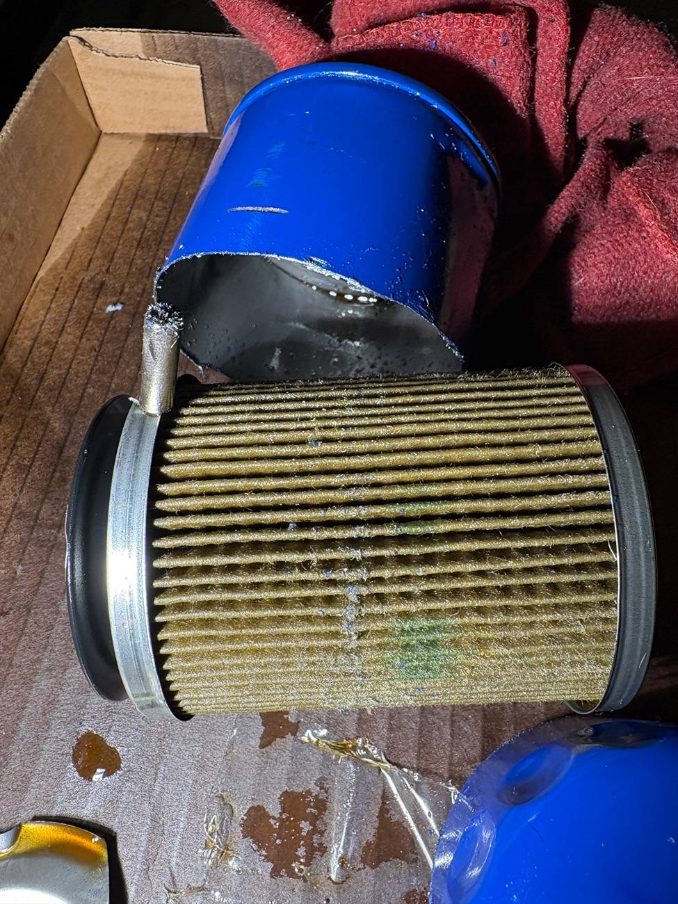

in a big motor (like a power plant turbine) you check the numerous magnets, wiegh them, and use vibration analysis looking for bearings and gears with wear.. from the noise they put out. You look over a period of time watching for a bearing to get noisy or leave a magnet full..
our little trucks are not worth all that. But, i will agree the first change after 5 hrs of operation is so important. Below is my ‘24 yukon first change and i just ran a magnet over the pleated material in the filter.. all you can say is yikes!.. drain also had some metal in it… a picture better proves it.

I change oil on a new vehicle before 500 miles
I do it again at 2500
Then again at 5k
I generally stick to a 5k OCI

I would almost consider getting an oil analysis done next service. That doesn’t look good at all.

On the one hand.. it was picked up in the filter.. on the other hand.. below 30um just goes on through the filter... like thousands of grinders? i still have 59k left on the warranty. and if you do a oil check.. it is below i think 15 um where they find things in those checks.
As an engineer... i look this stuff on the magnet.. and wonder.. did it come from rockers? rollers up there.. was it from rods-maybe clearances aren't great there.. of course all the bearings.. the main surface bearing on the crank.. it's a 5.3 and i had a couple of them before. i am not sure the gm build craftsmanship is in there like it was.. my last one was a '18. it was pretty clean. every change..
There is my 2.7 F-150 change at 1700 miles... i think it was 30 miles for first change. Not much on it... its a nice quiet motor.
